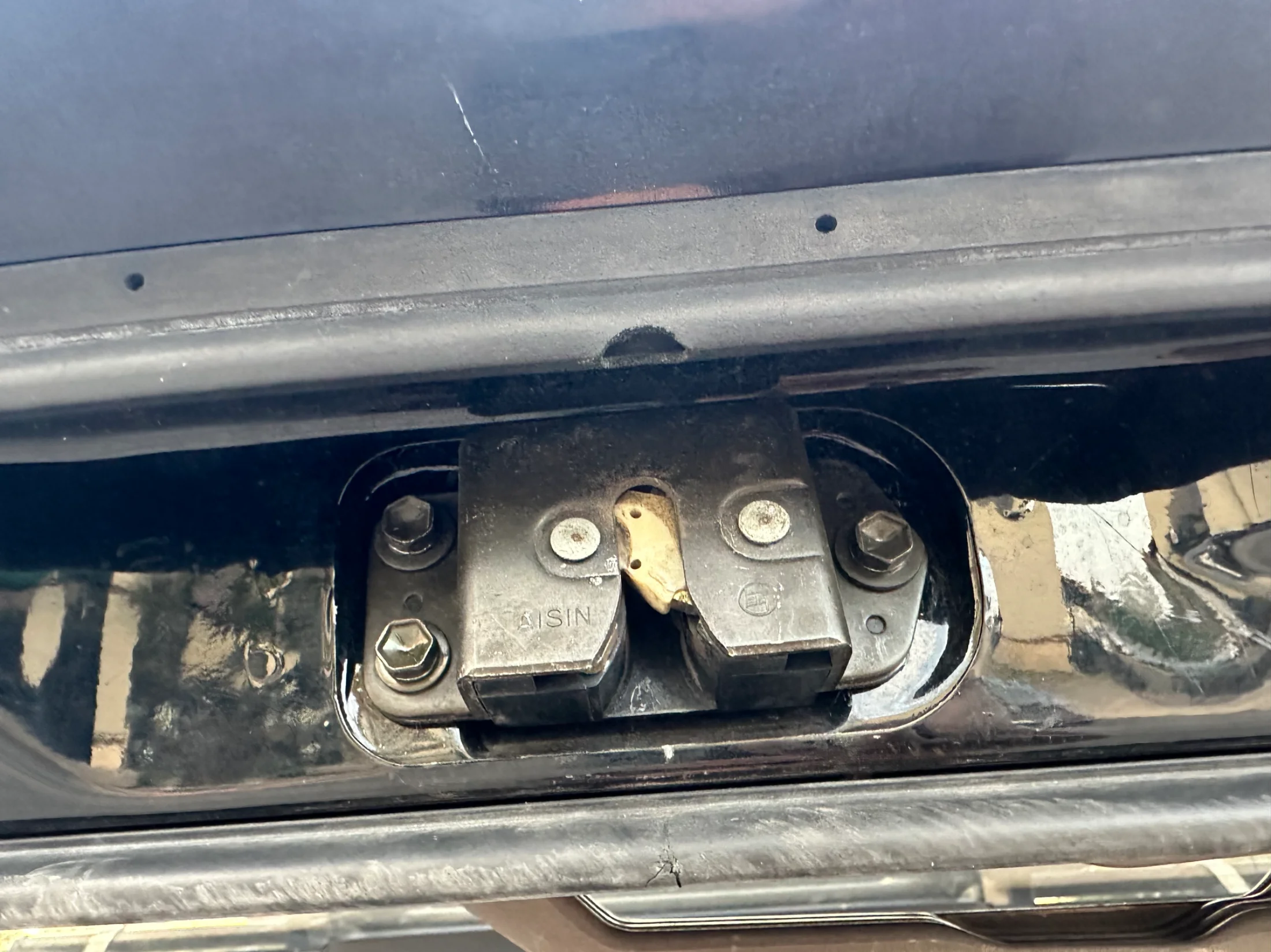

i have a working theory on why my replaced upper rear hatch has not been latching (and also why my battery has been draining).

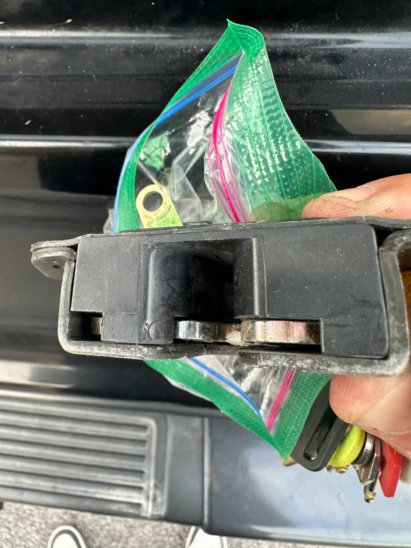

the first issue is the replacement hatch latch seems to have been missing a plastic "sheath" around the latching mechanism. i noticed this when i swapped out for the latch on my old upper hatch. the hatch is closing almost flush now and since i don't have a better explanation i am hypothesizing at this point the issue is this missing plastic piece.
