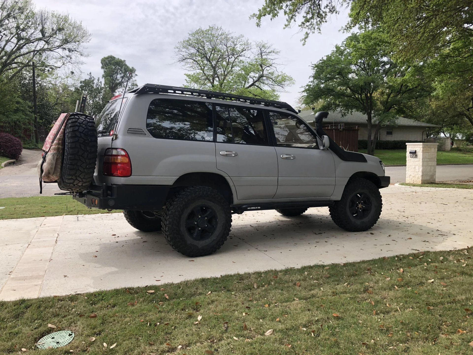

I did something I have been talking about for two years....I monstalined my 100!! @magnetman

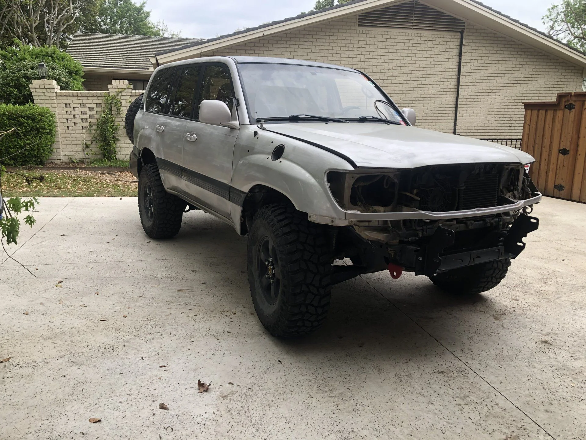

When I got my 100 I knew the paint was not great. To my dismay about a week later when I pulled my fender flares to find thedealer I bought it from applied the rear flares with thick black epoxy. The epoxy that didn’t peel paint of completely was completely stuck on there. There was no getting it off without paint damage. On that day in February 2018 I said I’d monstaline it, and I finally did.
There are countless resources (YouTube) and the instructions are very clear, so rather than regurgitate those, i will just provide some random commentary. There’s a YouTube video called something like “what I’ve learned after

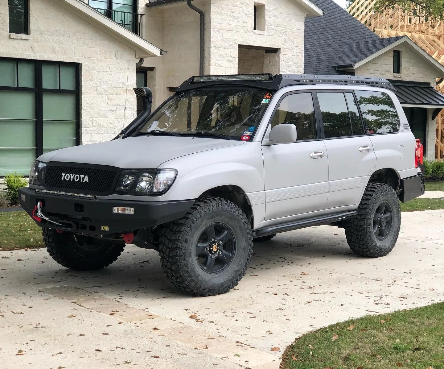

I did the tintable liner in Light Quartz Grey. It reads like a cement in daylight. It’s not quite matte, but definitely not glossy. The texture is much like a textured drywall in a house. Not that gritty abrasive liner like lineX. You could easily run a towel across it without it getting hung up.

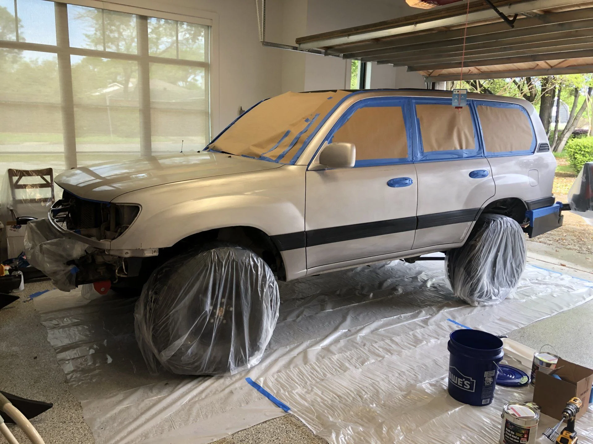

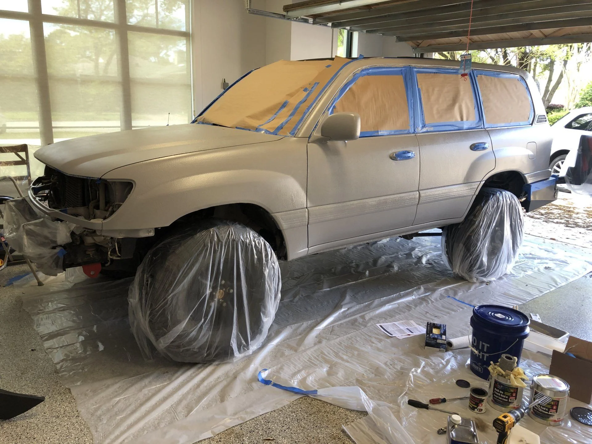

Prep is key! I spent a ton of time prepping. A ton. Follow the monstaliner instructions closely. 150 grit sandpaper worked better for me than the scuffing pads. Tape as accuaratepy as you can, but just know this stuff is THICK and you’ll never quite get the lines perfect, but for a $350 paint job I could not be happier.
Rolling is on is easy, but mixing the color and catalyst is downright stressful. Be sure to use new everything for the second coat; new mixing wand, new roller tray, new brushes, new roller.
I used foam brushes to cut in panels before rolling them. Cut in a panel and then roll it. Then move to the next panel. This stuff dries ridiculously fast.
Speaking of fast dry. It will cake on your roller tray, in the roller, on the brushes. If it starts caking, stop. Geta new roller, get a new tray, get new brushes.
People always say they have issues with roller degradation in the rollers they provide. First, you 100% need to use those rollers to get the texture. Second, don’t apply any pressure on the roller. If it runs out of paint, go back for more. It’s thick, lay it on thick. I used a full gallon on coat one and like less than half a gallon on my second. Mind you I did my roof in black with a black liner, and that would’ve taken a tremendous amount of monstaliner.
I would be hesitant to do a massive color change, because you'd have to be way way more thorough, and I was pretty dang thorough, like 18+ hours of work....I pulled my front bumper, roof rack, sliders, lights, grille, etc.
Im beyond excited by the results. I know there hasn’t been much discussion about monstaliner onnthe 100 board (some 80s some 60s), so I really just want to open it up for questions. Ask away!

Yeah honestly I think sticking close to your original color helps. It also seems that this stuff turns out better in lighter colors. Everything I saw and read, the darker you go the more inconsistent you get. If you lay it on thick it helps as well. Here is my hood.
Andrew, that looks awesome! Love the cement color. Perfect shade for this type of coating on a light color rig. I can appreciate that prep work and the fine tuning required to get the texture right. On our SS1 systems it took quite a few attempts to get roll-on bedliner to look right.
