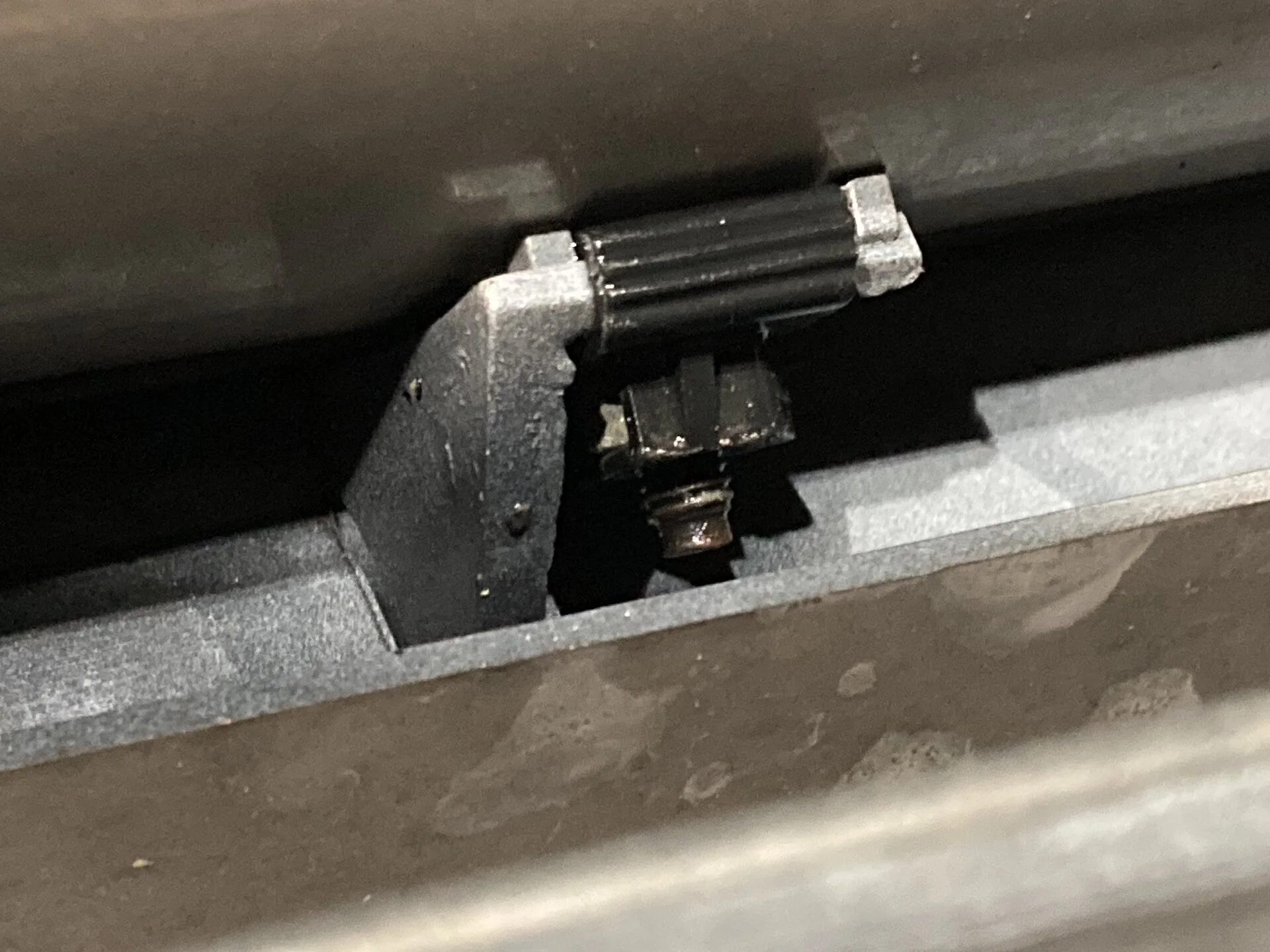

Hey all, newbie here. Just purchased a Japan Domestic Market 100 series. Only 68K and really clean. There are quite a few aesthetic changes I want to make asap and have already run into issues. 😁 Has anyone had experience removing the front bumper lip? It has a bunch of clips holding it to the regular bumper cover that I can’t figure out. Pic of clip attached, the other side not pictured is a Philips screw head.

Thanks for the reply. The challenge is you can’t get to the Phillips head on most of the clips to unscrew them. I’m thinking I need to completely remove the bumper cover to gain access. Was hoping there was a trick to get them off.
Id think you can sneak you hand in there from removing a few clips off the inner fender liners and pulling them back for access or getting them from underneath or from the top with a long extension? I’d try everything before removing the bumper. Which area is it the hardest to reach?

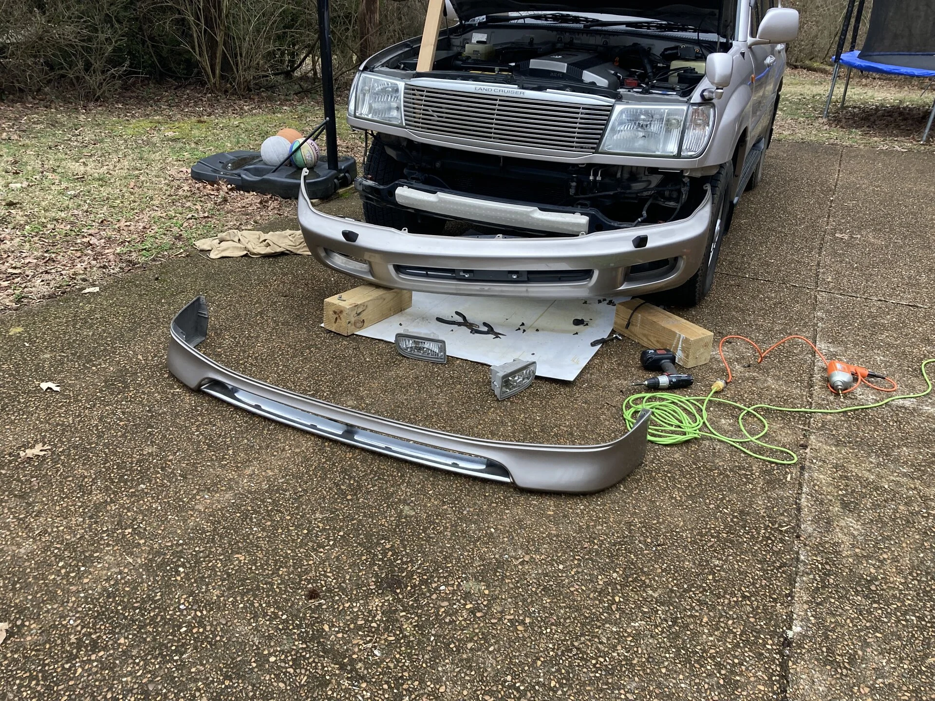

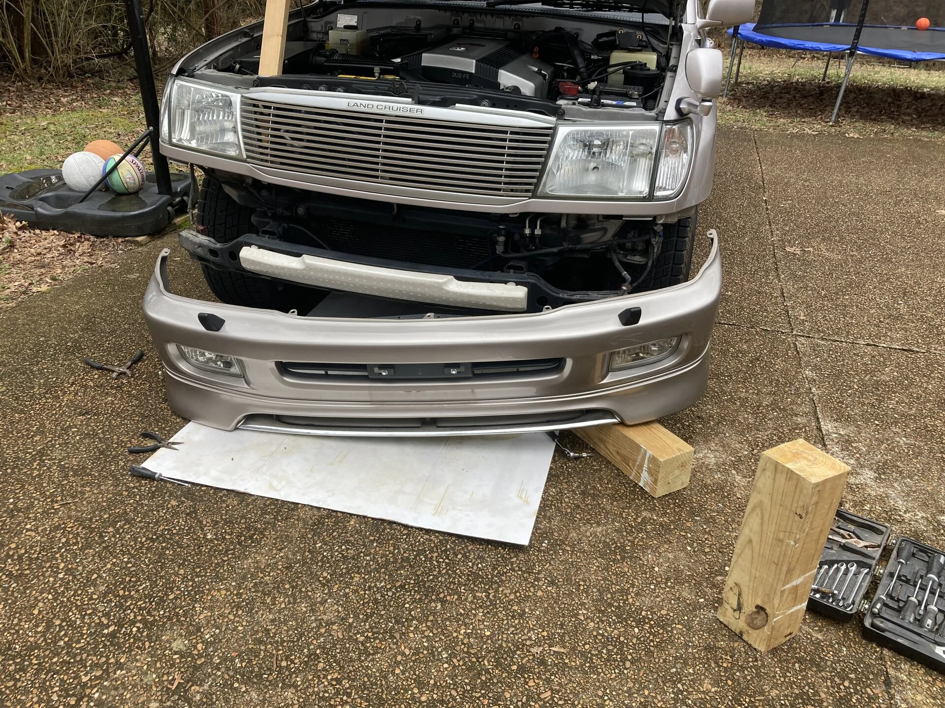

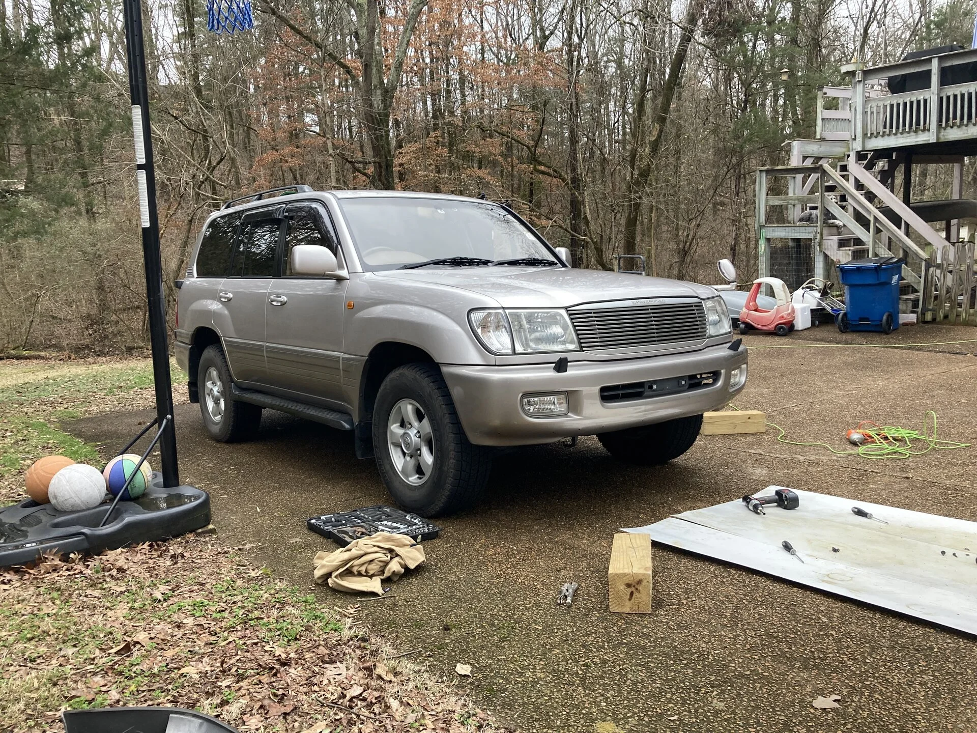

Update. Got the bumper lip off after much weeping and gnashing of teeth. You have to take off the entire bumper cover, unplug and remove the fog lights and since this has headlight washers, had to be careful not to break any hoses. Also had to drill the heads off of several of the screws becuase the nuts had seized and screws stripped.
But it was well worth it, looks way better IMO even with the holes it left in the bumper cover.
