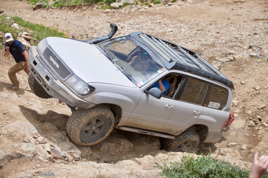

MONSTALINER on a 100 Series Land Cruiser
I'm not sure how I missed this thread before...Regardless, the results look excellent! If you don't mind me asking, what was your totally cost including prep?

Thanks! Probably was $500, but maybe 18 hours of my time.

And for those asking about the dirt/mud on the surface. From my understanding, the texture really doesn't cling to the dirt/grime/mud and so it sprays off pretty easily. Now this is VERY reliant on your surface texture so keep that in mind.

I haven't decided on my handles yet, they are still original. Luckily my color is so close you can't hardly tell. I also bought some black mirrors off ebay (for a RHD unfortinately but they do work fine) as my mirrors didn't come out great.
As for small dings, it does not conceal nearly as much as you would expect. Very minor door dings (something you could see standing 2-3 feet front he vehicle) are probably ok. If you can see it from 5 feet away, it probably won't do a great job concealing it. Its thick, but thick for paint, we are still talking about automotive coating here which is measured in thousandths...dings definitely still show thru. Luckily my body is very straight, my paint was just awful.

Not sure if you answered this before but how many liters/gallons did you use?
2 gallon kit, but that doesn’t count my roof which was done in black raptor, and I didn’t do my jambs.
