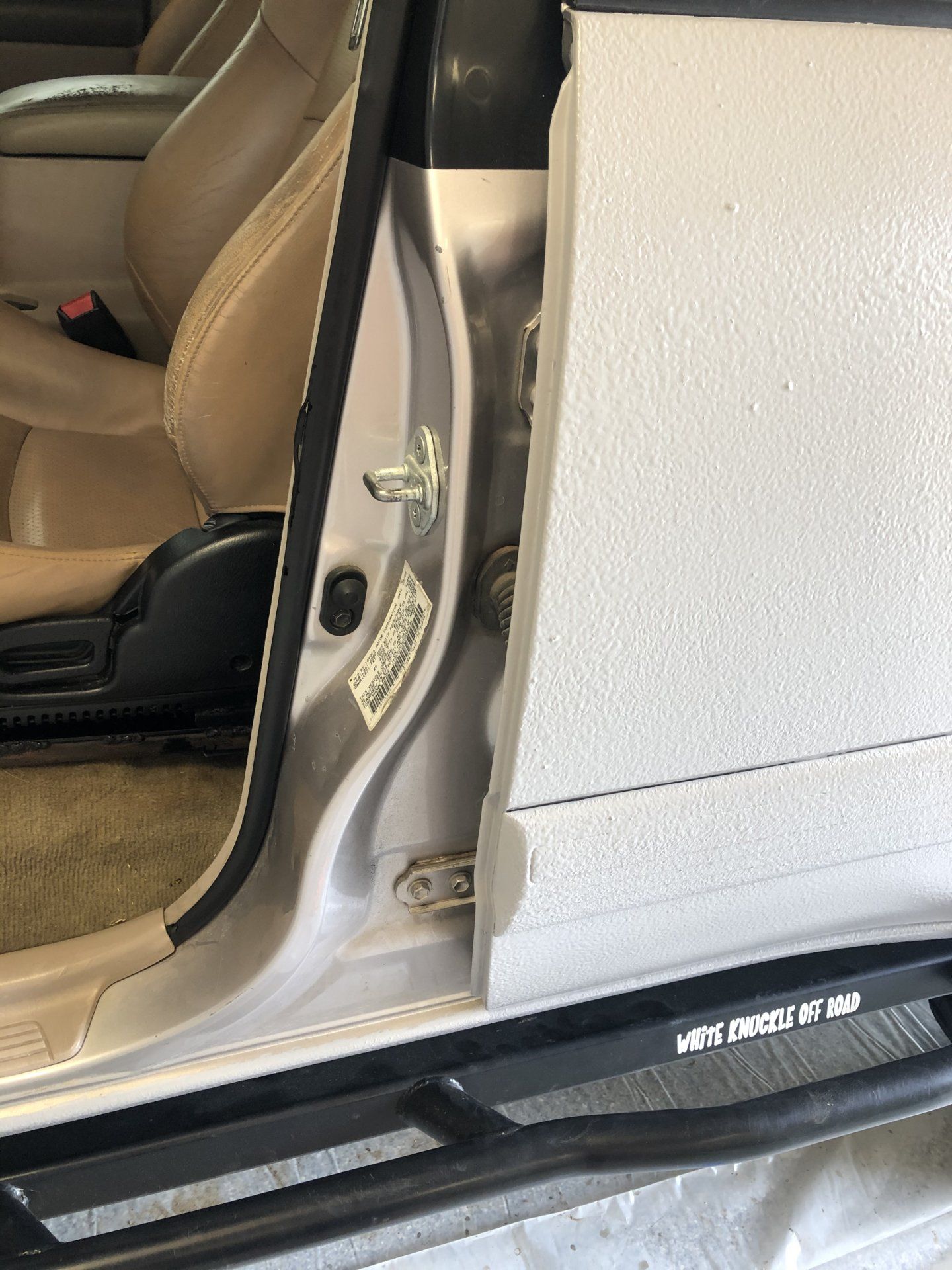

Yeah it’s just a running theory, I still think the big deal is how close you stick to original. For example here are my jambs (which btw don’t look completely ridiculous since the color is close).

I think it looks great. Couple of questions, as I want to do this to use this stuff on my ski boat trailer.
I see in the close-up pictures there are areas where you were able to lay it down almost perfectly, and some areas with "inclusions" aka little pieces of something. Is it dust, roller, brush, bits of the Monstaliner gumming up on you?
What temperature did you lay this down in?
These are the inclusions I'm curious about. Just to be clear too; I'm not being critical of how this turned out, I've done paint on vehicles before in my own garage and know its all balancing the result with prep and cost. I think a lot more people are going to want to do this as their cruisers age and am interested in how we learn from your process.
From other Monstaliner posts the "chunks" start to come from rollers as the coating starts to gel during application, and pulling pieces off the rollers.
All good. In my experience it one of 3 things. 1) roller chunks (myrollers really didn’t degrade) 2) just honest textural irregularities 3) chunks of dried liner from the bottom of the tray
this stuff dries insanely fast. To me this is basically a “$300 paintjob issue” and looks totally fine up close.
Was maybe 75-80 degrees moderate humidity.
