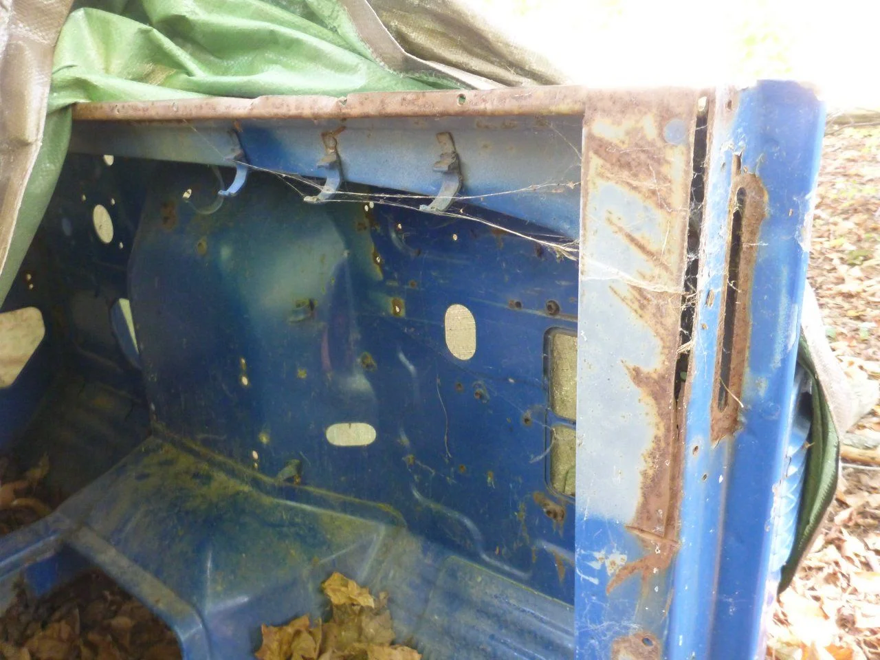

I have a mallote body tub for my 78' Fj. And I am not a big fan of the dash, firewall, and absence in the kick vents on it. So I am wanting to get rid of the fiberglass firewall and dash. And put my original firewall and dash on it as a whole front on the fiberglass tub. i will try to get a photo of how i have the original body cut up on here as soon as possible. and suggestions would be great!

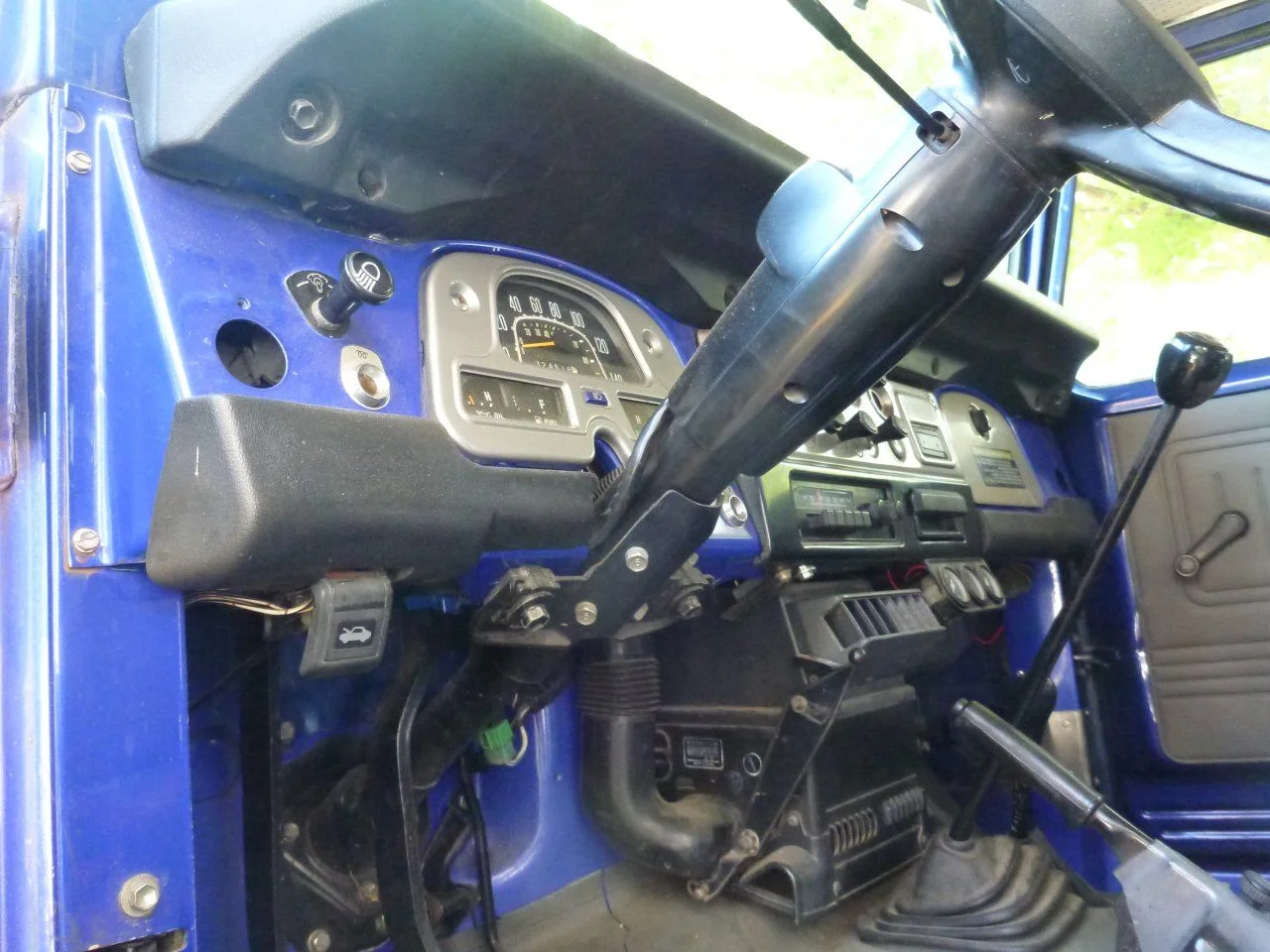

why dont you keep your first idea (from the previous thread) and just change the firewall ,so it keep some stuctural integrity by keeping the glass door opening . for the dash its not a big deal to cut from the metal tub and bolt it to the glass one , my 42 dash is set up like that , plus it is a nice place to use as a ground , and for the side panel with louver and kick vent ,you can glue and or riveted it
pic of the metal dash on glass tub
