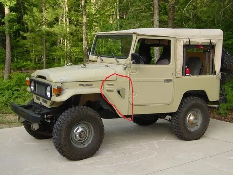

nice project , you have a malotte fiberglass body ,if you want a more factory looking 40 you can cut out the front side pannel on an old 40 (red circle on the pic) and glue it on yours ,so you get the kick vent and louvers , body shops now use special epoxy glue like 3m and SEM or you can use rivets , this part usually not to rusty on junkyard 40
Thanks for letting me know what type of body it is. I was curious and tried to do some investigating. We had to add some steel brackets and add some steel to a couple other locations, to stiffen it up for the doors and seat mounts. Now that we are done, I am very happy with it, other then a value point of view. Also, I messaged Coolerman on here earlier in the week about that heater vent asking him options, because my heater is not getting the necessary air to really power it. He connected me to an Ebay link selling that vent. Needless to say it is ordered and should be here any day. Thanks again
