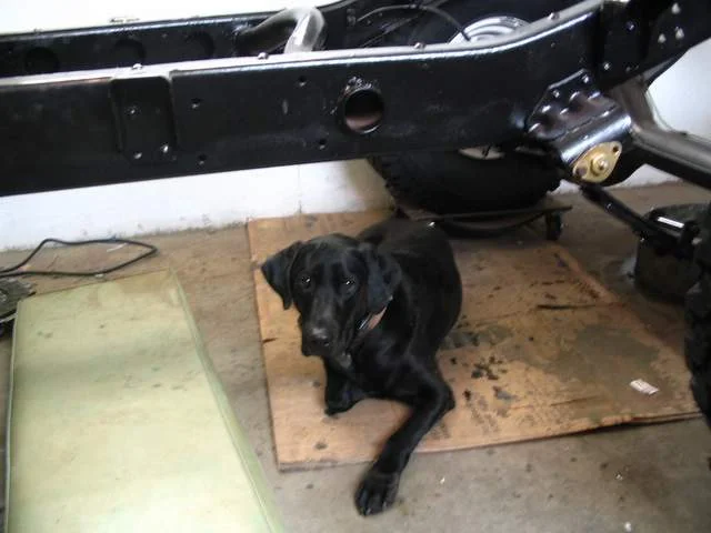

Cute dog....
Did you get that other leaf spring frame pin retaining bolt in yet? ;)

Cute dog....
Thanks for noticing that... I am missing two one in the front also... getting my bolts tomarrow so I should have one in there soon... :flipoff2: (PS I love this finger guy... classic!!)

Yea he is great!!! Unless we are hunting he is no help... but I like having him around! :)
