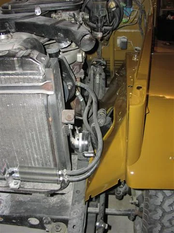

I'm running a standard P/S cooler - fits inside the front bib nicely and it's out of the way:

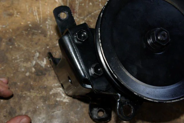

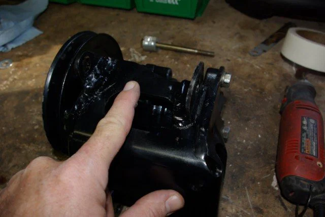

Here are some pics of my mini truck pump. Again simliar to Coolerman. I used the first pulley on the crank(closest to engine) to run the power steering. The original mini ps pump bracket was modified by to fit the F alt bracket. The top bracket was also fabbed(very easy).
I am a beginner so take these ideas in hat light.
Pic 1 bottom of mini ps bracket I moved original tab from where my finger is to the left edge. Added another bracket to the right that fit on the rear of the F alt bracket

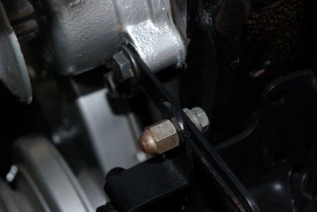

Pic2 The front bracket (belt tension). The holes for the bracket are already there. Bracket is on engine side.
pic3 Front bracket mounted and used water pump bolt for another bracket that would allow you to tension the belt.

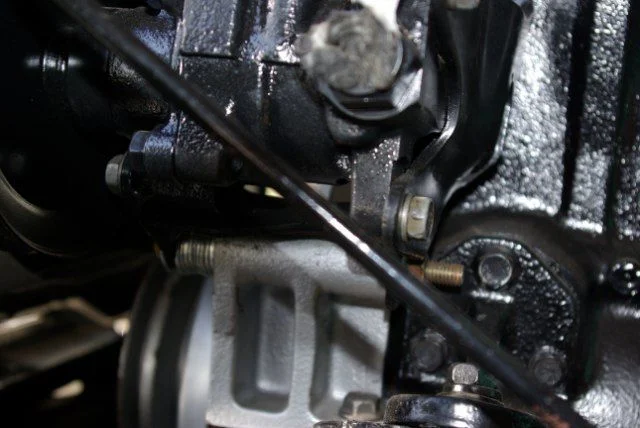

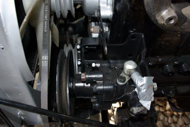

These are the pics of the pump mounted. I used washers to space the bracket to the exact location to make the belt straight (see pics). Then I measured the washers and fabbed a spacer out of pipe(no pic of spacer)
pic1 Mini ps pump mounted on engine
pics 2 same from the bottom see washers used for spacers then fabbed a good spacer
