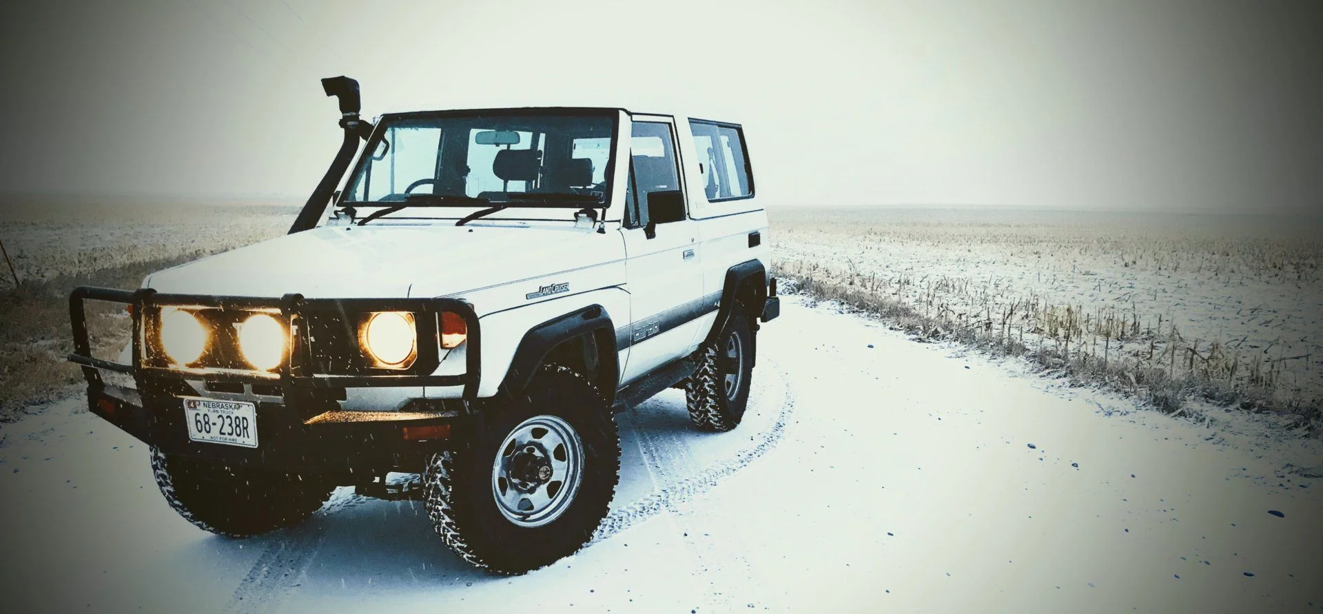

I run 255/85r16s which are a “trueish” narrow 33. Yokohama MT G003, smooth on road and excellent traction.
stock shackles and 2.5” lift.

Nice rig. Sit's about what I'm looking for. If I'm considering the swampers then perhaps I should think about expensive radial tires as well. I wish I could get Federal Couragias or another inexpensive radial mud tire in the size you have. My BJ73 is sitting on some chrome 15's that look like the same style you have. Not as many tire choices in 15". Thinking about going to the nearby LKQ and getting some 17" steel spare tires/rims off of tacomas or tundras depending on price............ I"m going to replace the bushings in my shackles. I'm probably going to get some 2.5" longer shackles which shoul give me about 1.25" lift. I'm thinking about getting another 1.5" or so with new softer thicker rubber body mounts and bolt them down a little bit looser/softer. That should provide me the "lift solution" needed for 33-34 tires...........................If someone not trying to sell me springs would tell me: "Brand X aftermarket lift springs ride so much better/softer and give you the flex/travel and 2.5" of lift you need than your worn out stock springs" ........Perhaps I'd think about that route. It's just alot more expensive. I had a samurai with lock rites front and rear and 29X10.50 swamper SX's that would go anywhere (except bottomless mud holes) and with all the extra traction I could go slow/steady and not break the vehicle. I'm going for similar off road capability with the 73.

Stock Toyota 15" rims that are ~7" wide at bead.
Off topic somewhat ... Tire selection in 15" rims appeared to be going extinct. So to gain better options in tire selection going forward, I bought a set of 16" Toyota steel rims from Onur. Same width rim. I am very happy that I made the change. The rims are very high quality and robust, plus the tire options increased as desired.
