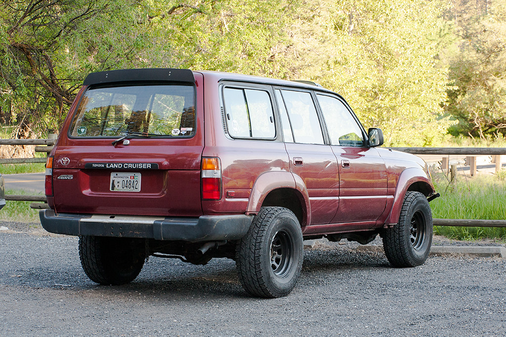

Took it on its longest drive so far. Drove down then up a pretty ridiculous ditch. It's not perfect but it runs and drives decently. The 32" tires are starting to look small to me...

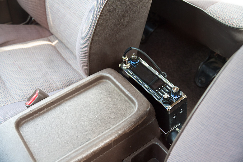

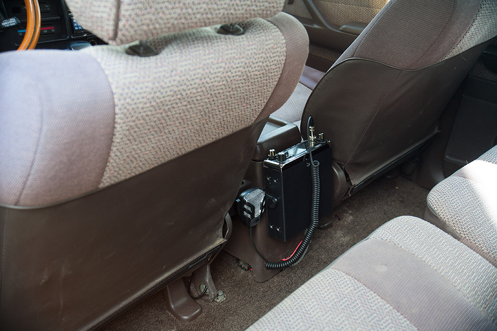

In other news I installed the CB radio which of course was an ordeal. It didn't seem like there was enough room remaining in the stereo DIN slot and I couldn't think of a good place to put it, so this is what I came up with. Stupidly I forgot to take into account the center console lid but it still opens most of the way. For mounting the antenna I made a bracket out of a piece of metal I found and it seems to work.

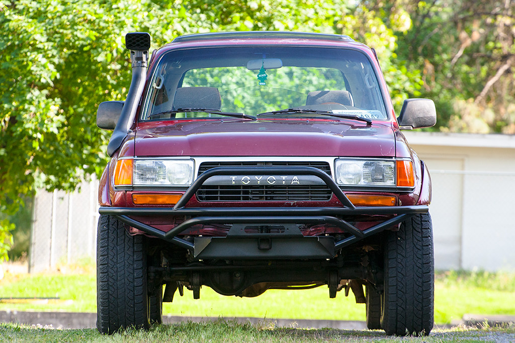

Just read thru the whole thread--nice job man. Especially the outdoor complete engine swap in "tent city." Is that a Badland's front bumper you went with?

Great car choices! The bumper is trail gear.
