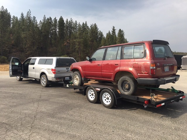

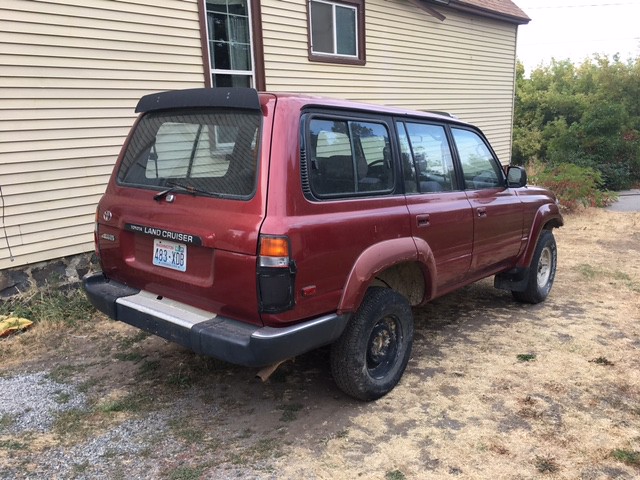

248k miles, started right up and drove onto the trailer. I figured how bad can it be, I can fix it, right?
Made it home with no issues, the F150 is savage and pulled it like it was nothing! No front bumper, s**t wheels and tires...

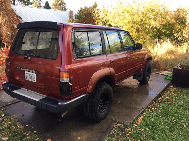

The paint has seen better days but, it's mine!

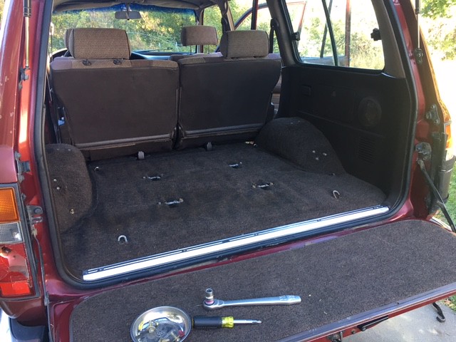

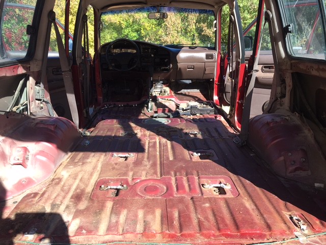

The interior was a s**t show but it's not the first time I've gotten a nasty rig, so the first thing I did was tear it out and clean everything.
Much better!

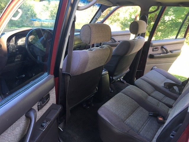

Pretty good besides the ripped front seats...

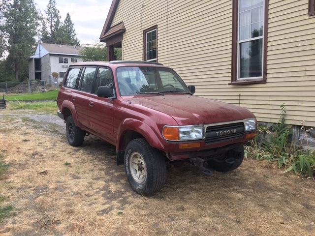

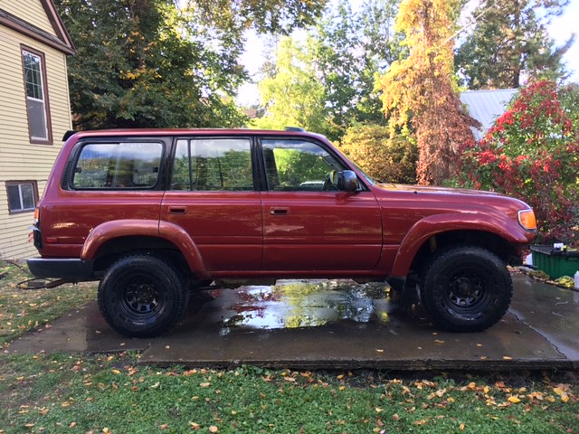

Next was wheels and tires. Got a cheap set of steel 15" 32x11.5 from craigslist and washed the outside of the rig... I like the looks of the black steelies, always have.
Is it lifted? Seems like it. Still need to replace the wheel studs on one wheel but I figured I'd better take the engine apart and get the head to a guy I know.

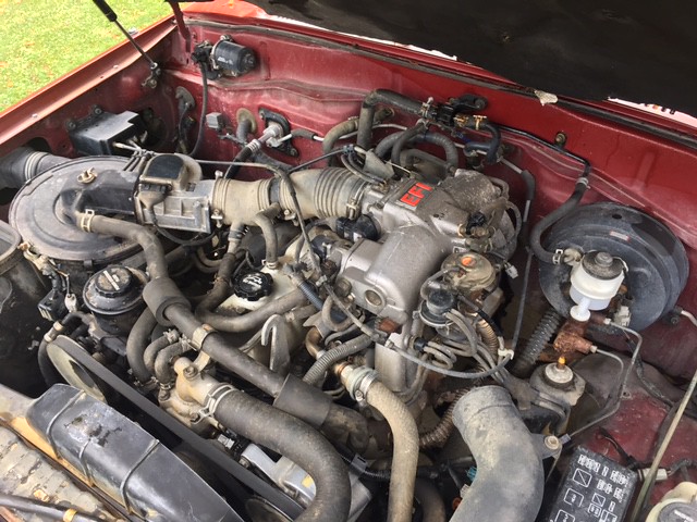

Normal, dirty engine bay.

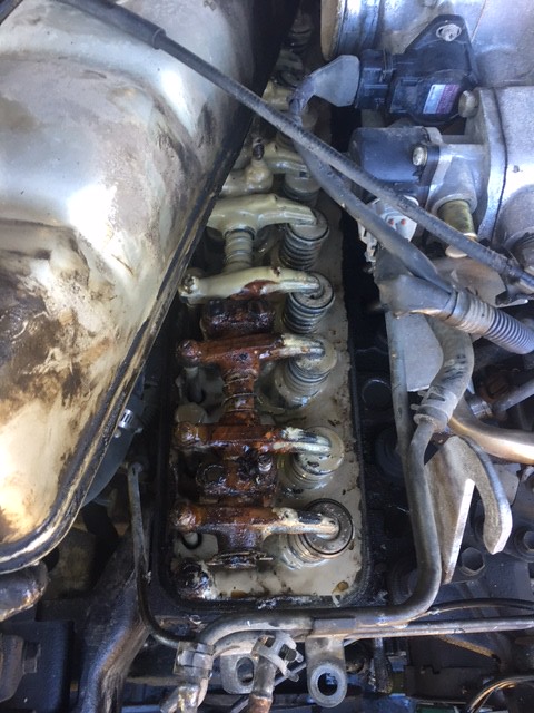

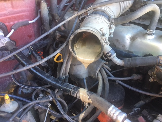

Well that's gross, how was it still running? It idled a bit rough and blew white smoke but it wasn't THAT bad?
Nasty!
Why is everything so rusty? All the coolant hoses were rusty! Why?!
Well, I've seen enough. The motor is disgusting and seems to be rusted out inside. I found pieces of metal in the coolant. Not good.
Wait a second, it was still running like that?
Pull it and rebuild it. It's probably in better shape than you think.
That might be very optimistic. Lots of coolant in the oil along with other goodies. I can't imagine that the mains and crank are looking good at this point. Add in all the crap that's now in the throttle body and a nasty looking top end. Not sure it's worth the time/money.

Dang that looks nasty.
The few 3FEs I've seen with blown head gaskets have been severely neglected.
