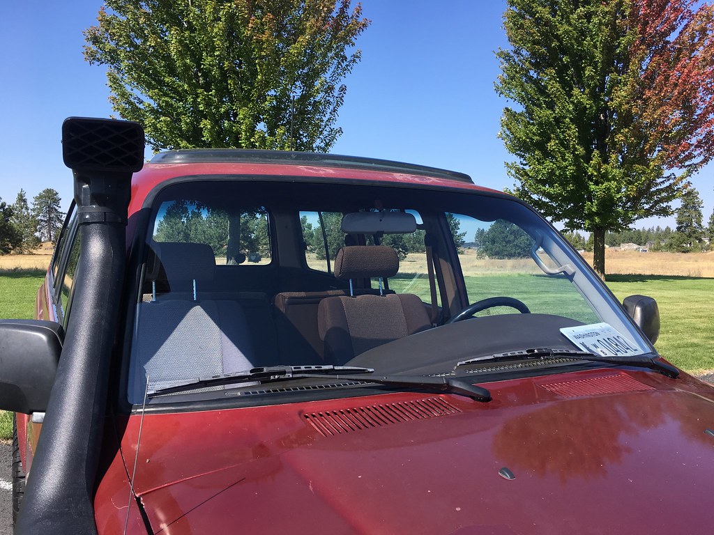

New windshield installed today. No more crack and pitting! The safelite guy even vacuumed my carpet... lol

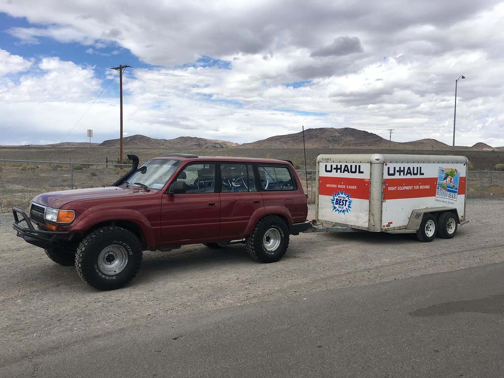

Well I haven't made an update in a while. I did in fact end up moving from WA to CA! The landcruiser managed to tow a full 6x12 u-haul full of most of my earthly belongings. Never doubt the mighty 3F-E.

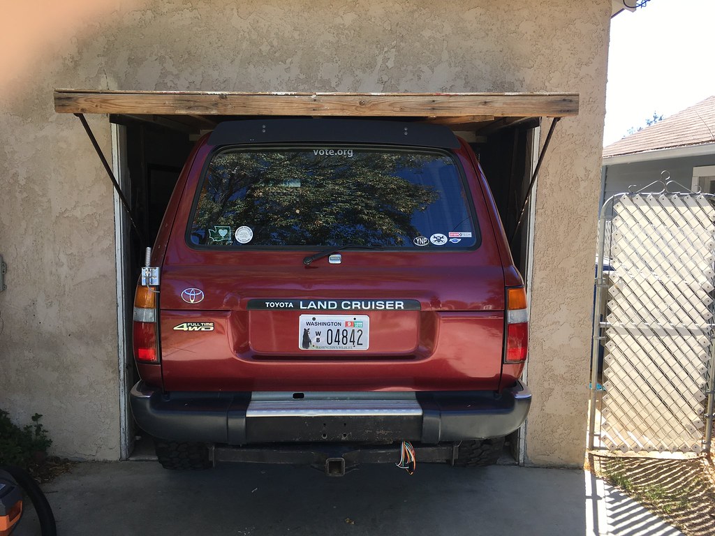

it barely, and I mean BARELY fits in my garage - but it does fit if I need to put it in there,
