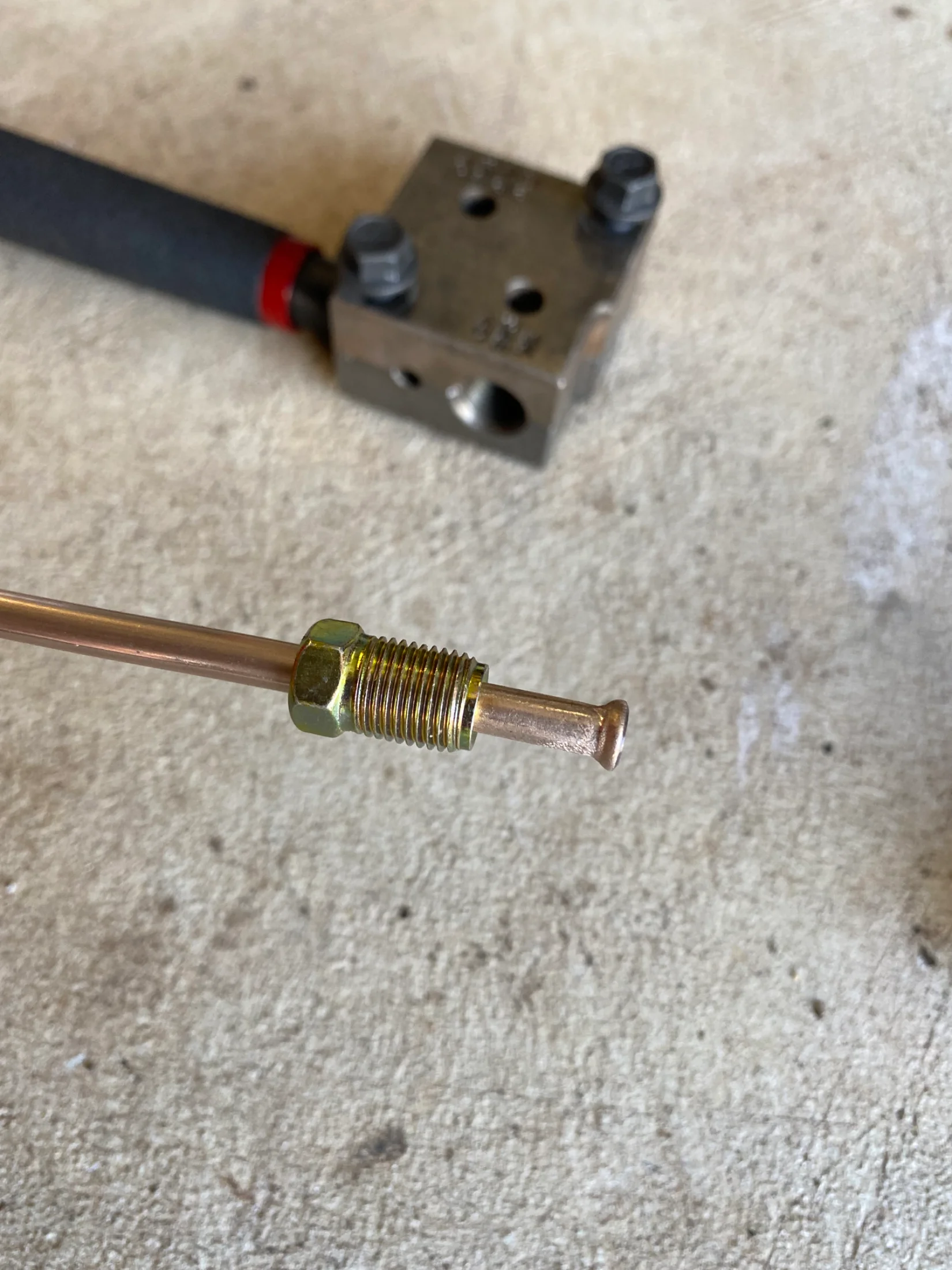

Also, you can bend up you own lines for very low cost. It’s so easy a girl can do it!…just kidding about that, but a YouTube tutorial and simple tools can get it done. I help bend up and replace the brake hard lines on my ‘75 Fj40 restoration.
All of the materials were purchased from Amazon and are pretty simple to use after a little practice bending them. This was for my fj40, but the concepts are similar on later models. I will be doing the replacement hardliners on my 94 Fzj80 in the next couple months. You should definitely try and do it yourself first, you can remove them and just copy the bends and lengths.
