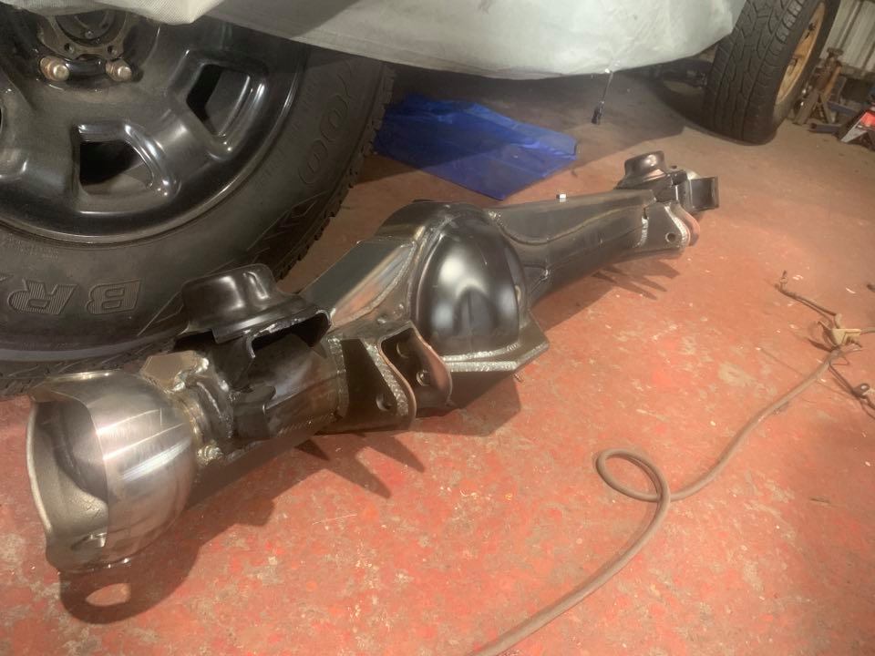

Might be easier just to grind the crack until you're almost all the way through or even through. Clean with brake clean, and fill it back in with the pretty blue light.
If you do go the reinforcing route, I'd suggest looking at common mods done down here in Australia for inspiration. These guys are worth a look:
In particular, check out this kit:
You probably won't find ready-made plates for half these mods state-side, but someone who knows their way around a welder and a plasma cutter could have a fair go at replicating them.
Nice
That the best looking knuckle brace that I have seen !
Thanks for that, very helpful. I have a plasma cutter and all sorts of metal fab crap that I can use for this project. As mentioned already, you're introducing a TON of heat into this housing so keeping it unwarped would be a huge challenge.

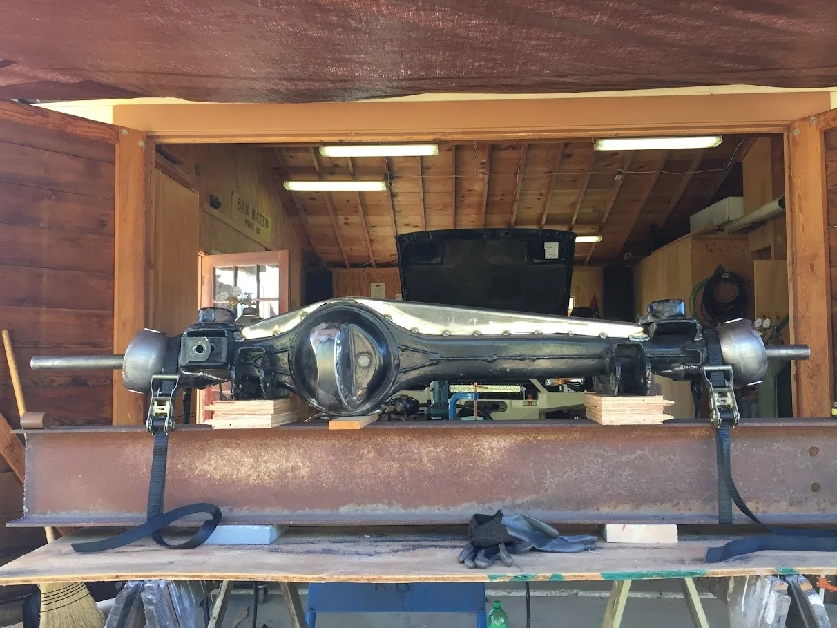

Here's the set up I used
that's a great visual, thanks for that. I'm not seeing the balls being gusseted, did that come after this pic was taken? Love the round straight bar through the whole enchilada. Thanks again.
Some entrepreneur types on Etsy can sell the DXF files of all the bracing plates for the 80, which would help us out 😁 I noticed Rampart is also bracing the rear part of the chassis as well, which also has me thinking 🤔
The knuckle gussets are there, they are modified Marlon Crawler mini truck gussets.
The bar passes through a gutted diff with spacer instead of bearings, the spacers are the same size of the rings at both ends of the diff.
The idea is weld and then spin the bar if the bar starts to drag you know the housing is getting to hot and starting to warp.
Thx for explaining, and the bar rotating makes a lot of sense. If I go this route, I'll have to look into doing this as well. @Tank5 do you have this bar?
I do.
