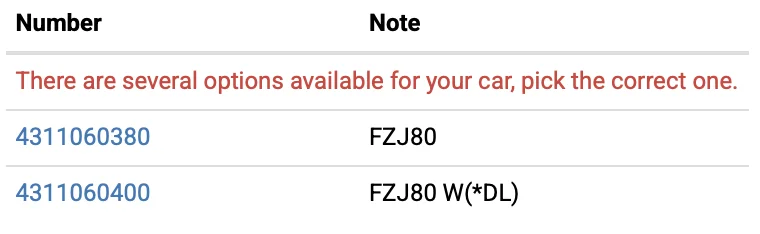

Anyone know why the 380 PN is almost double the price of the 400? I'm assuming the 400 is for a diff locker housing? Would that work with a non-diff locker 3rd member?
Check multiple sources US sources, Oriseman, Olath, your local dealer; look/ask for discounts. Importing something like that may not make sense at the moment due to tariffs, shipping, duties, taxes, ---. (there are multiple threads ongoing about tariffs so IMHO no need to start a new one here)
I know you can convert a front that doesn't have a diff lock to accept diff lock by welding some holes up and drilling a few new holes. Never done it the other way around. I would think there are quite a few non diff lock axles floating around.
