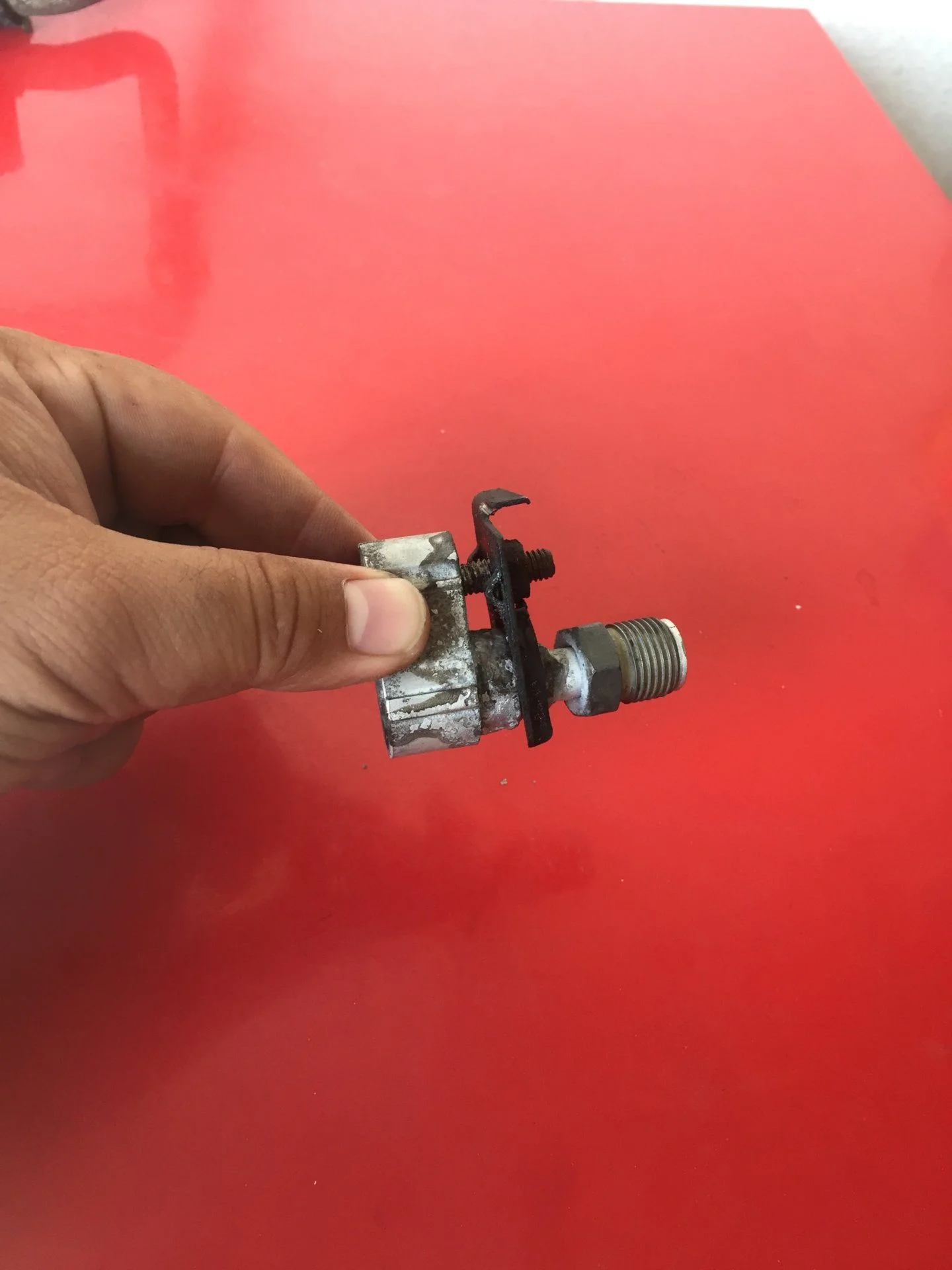

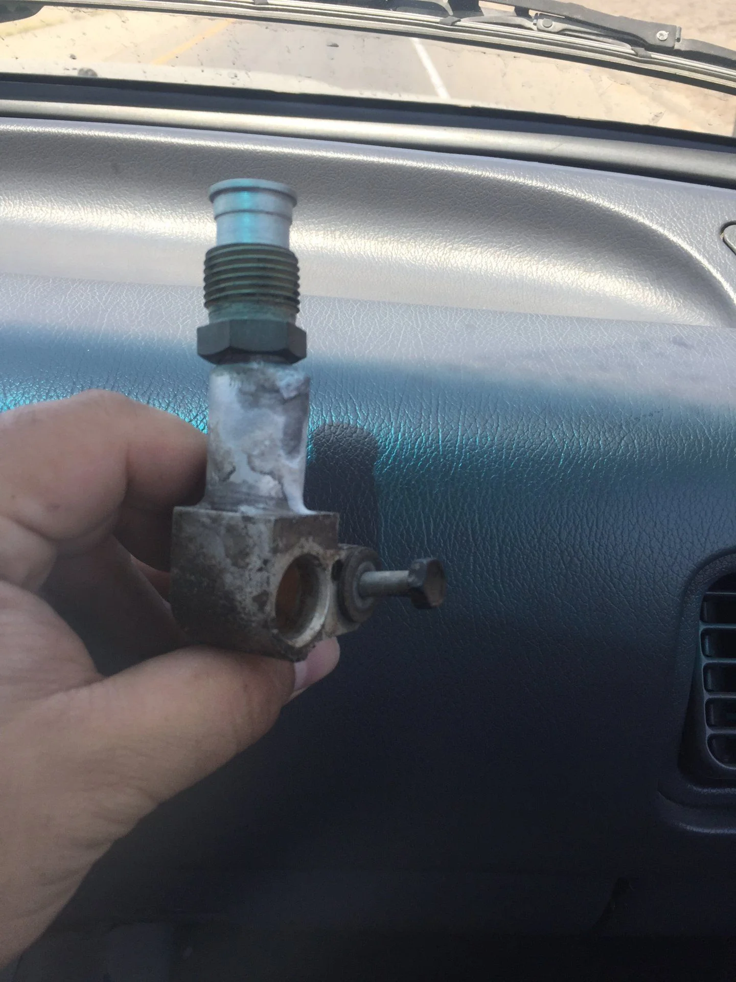

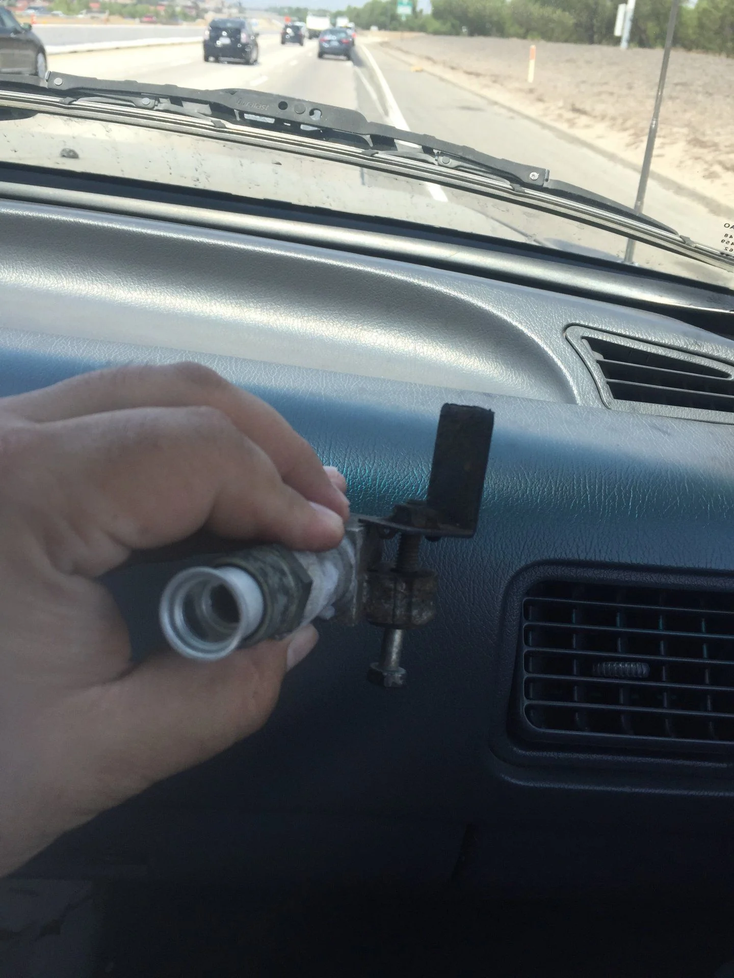

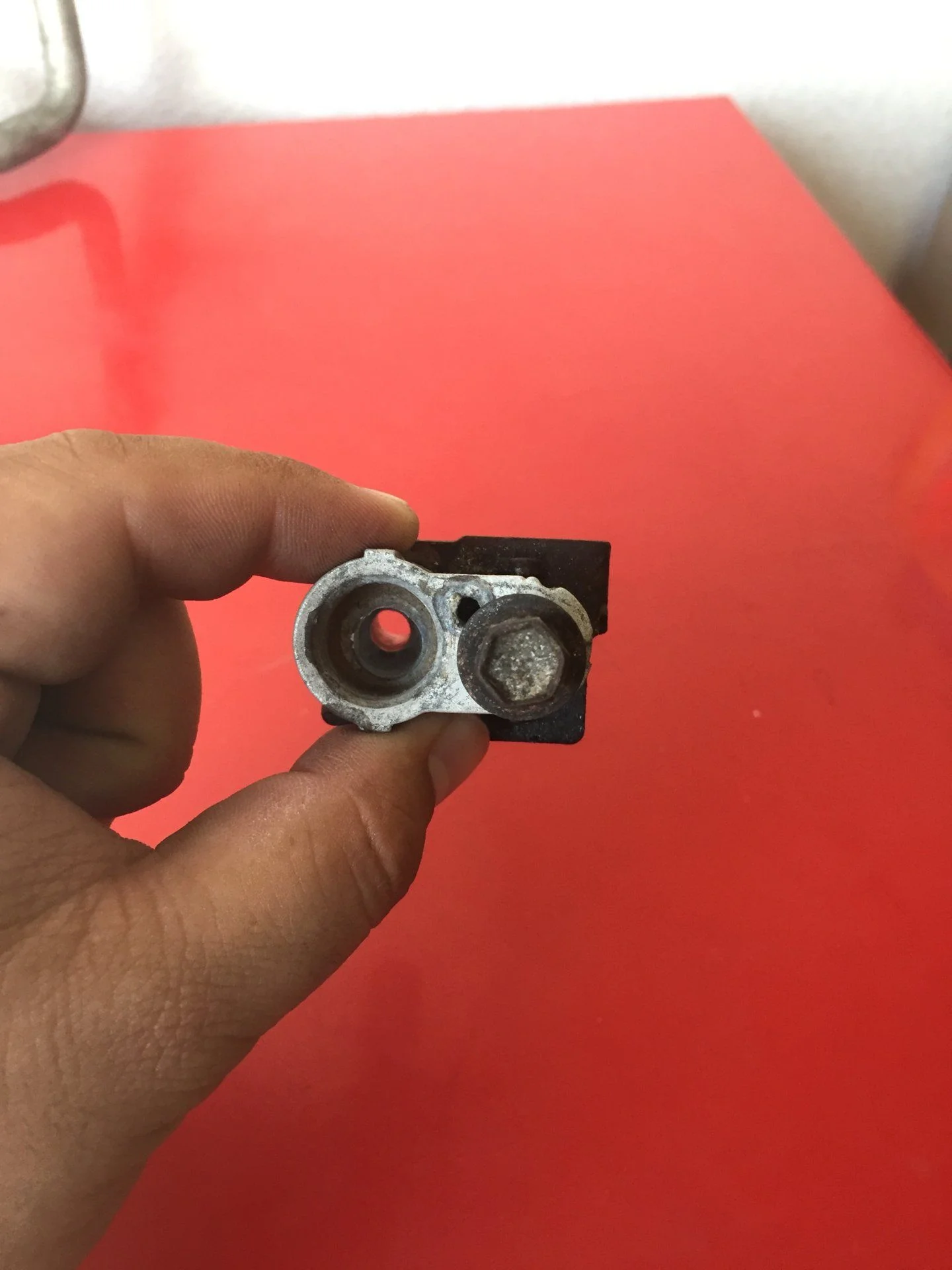

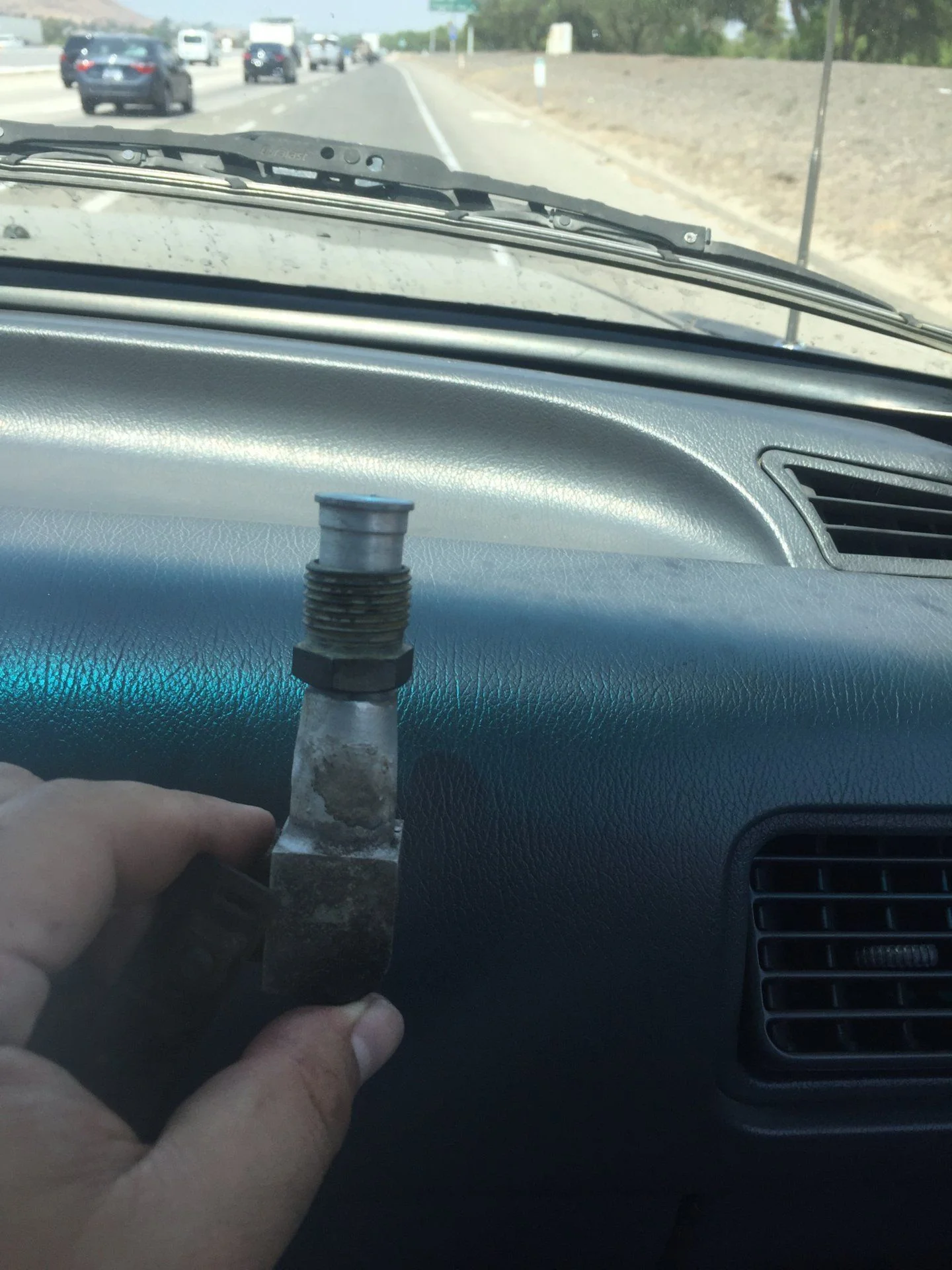

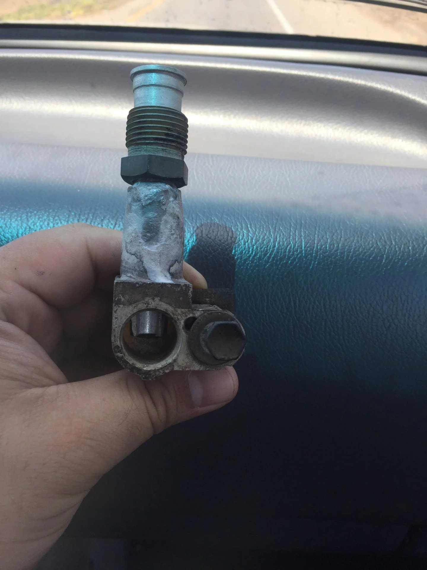

I probably could find something there but would take a lot of time sampling each and every fitting. So I thought if i make the 2 condenser fittings and the tees universal AN type, it would be easier to add anything to the existing system.
Here the condenser inlet with #8 AN fitting.

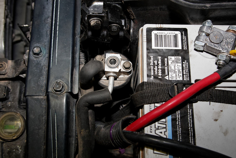

You the material wrapped around the #10 hose from evap to compressor?
No, it's like a foam, about 1/8" thick. All along the driver's fender and around the trinary valve by the battery. It's a foam insulation that needs to be on the hard line prior to braising.

Very nice. So you can use those adapter lines to your OEM blocks. Perfect!

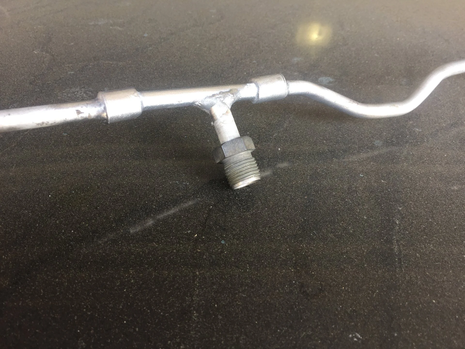

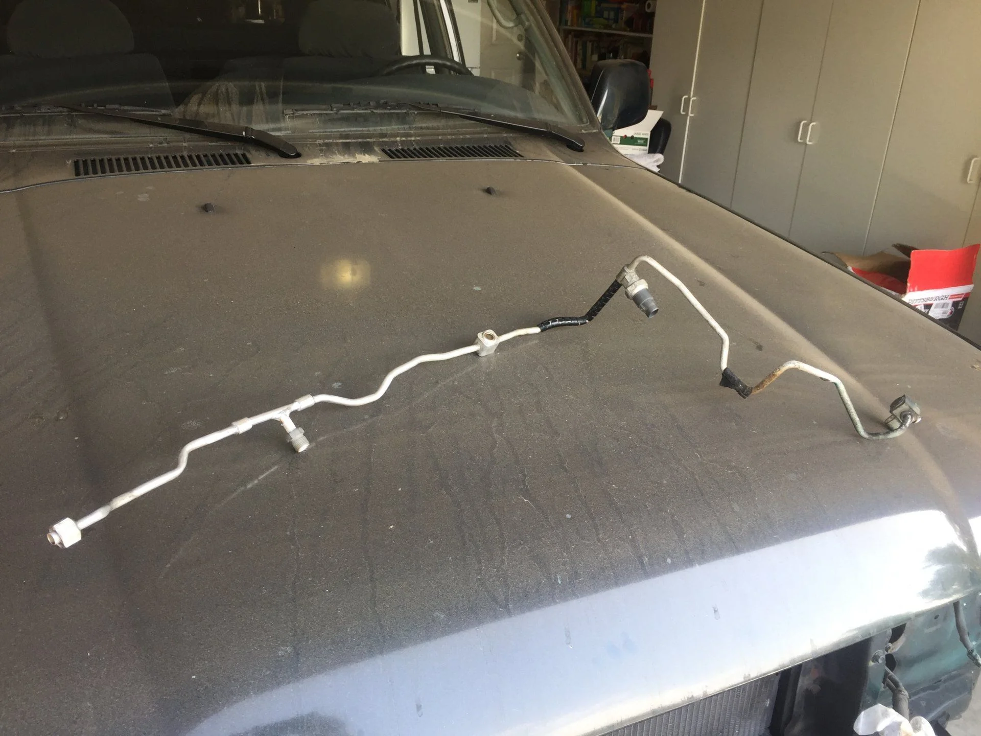

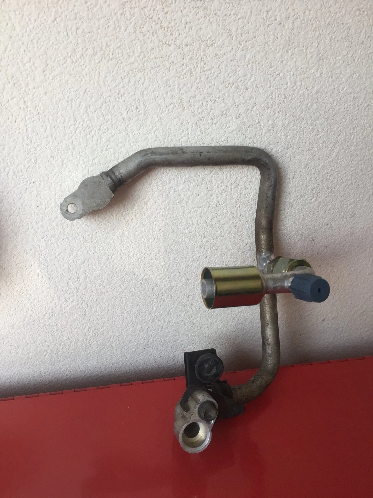

You're planning on hauling down the OEM lines from elsewhere in the system to the shop to have the tee's braised in then?
The lines are coming from my dads cruiser that we're experimenting on. If this is successful then maybe i could do my other 2.

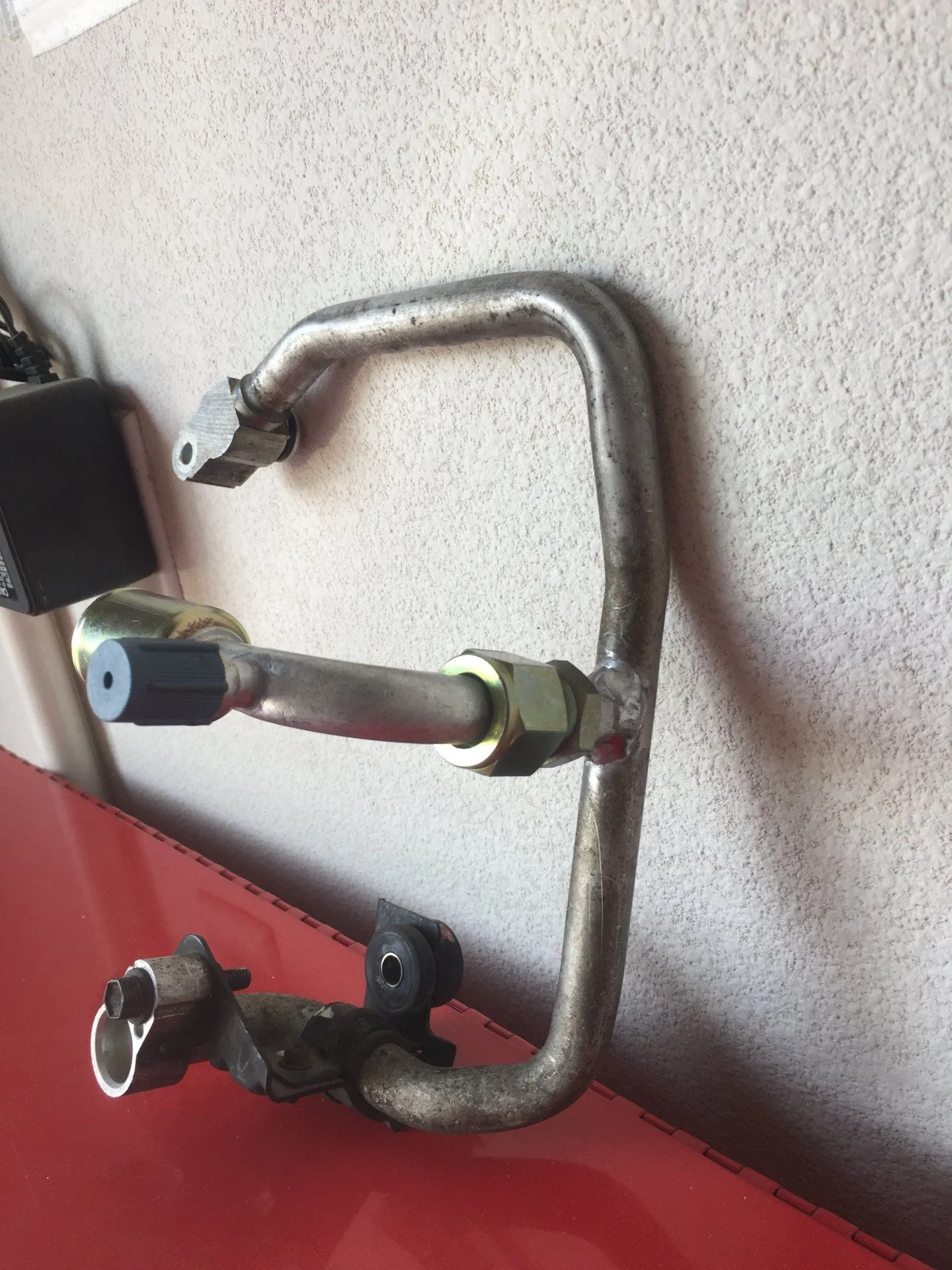

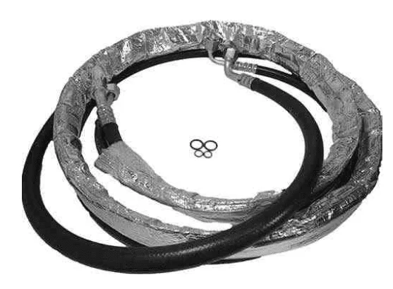

I've been reading up on hard lines vs. hose for rear evaporator lines. Aluminum can corrode and form holes, I've not seen that with rubber hose. The new multi-layer hoses seem very durable. Maybe provide additional protection behind the wheels and cover with reflective insulation around the cats and other hot spots. I just found a replacement set for a Chrysler New Yorker that had original rear air and this is what they look like. BTW, these are $200 so that price for the custom line seems pretty in line.
