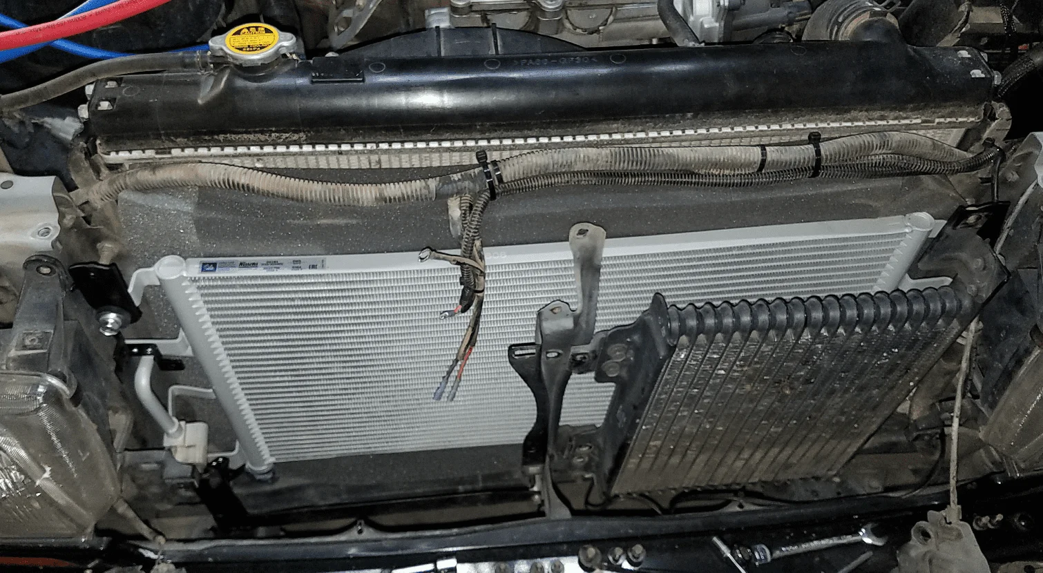

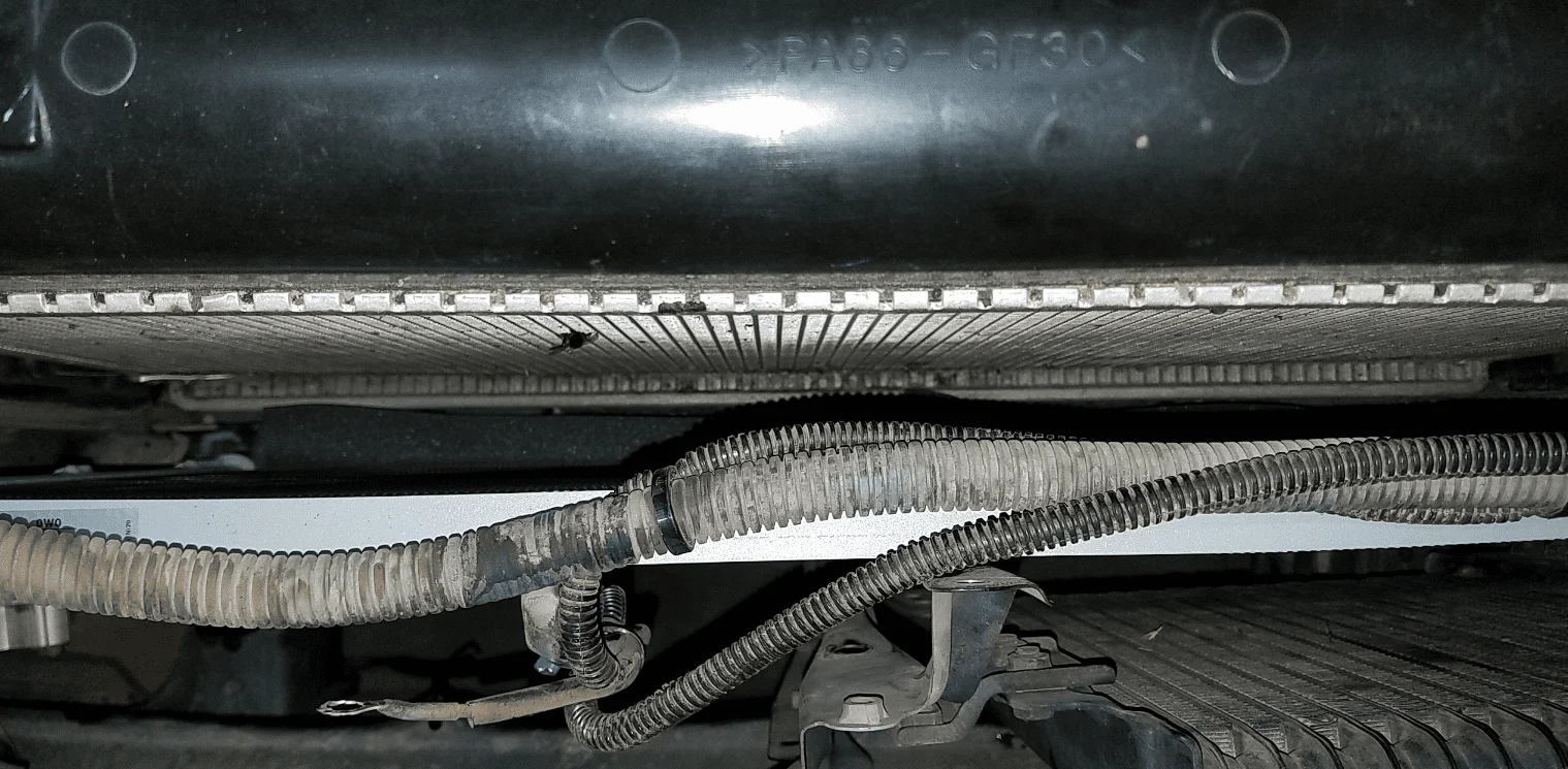

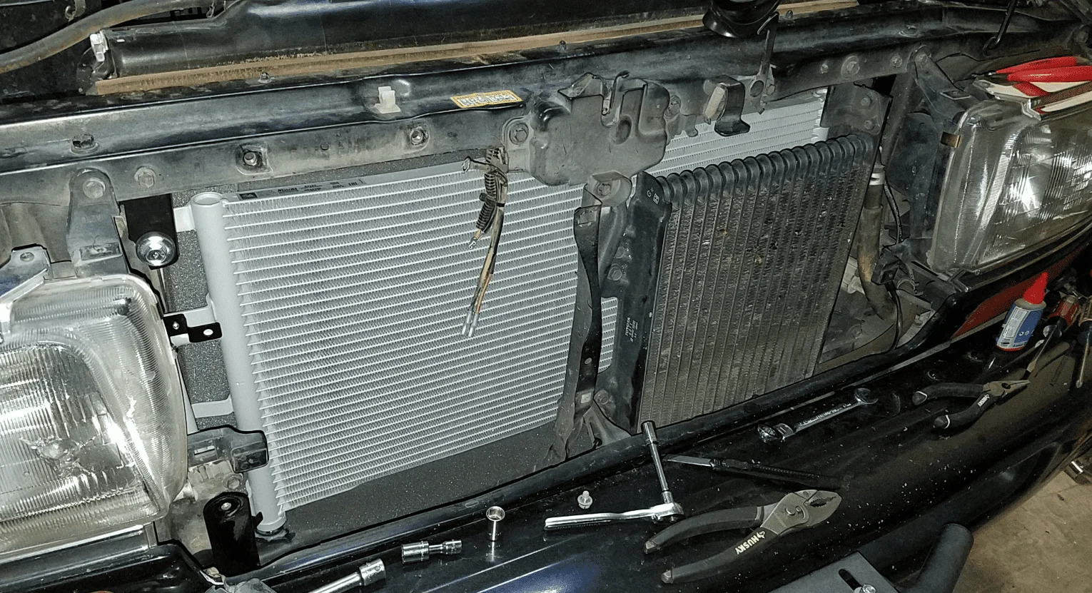

Here's some more pics from my install. Part 5.
View of the bottom from above
Sides and top foam. The bottom was under the condenser, the sides and top were between the condenser and radiator.
Top view of the top foam.
Reinstalled the top beam of the radiator support. All done!
@Dissent I found your write-up after I've been struggling with my Nissens condenser install for a bit. Without adding any extra foam, I wasn't getting sufficient airflow through the condenser at idle. I've added a couple of those 2x2" foam strips to the sides (which has help a decent amount), but haven't yet added foam to the bottom or top.
A few questions:
- Are you still running this foam, or did you upgrade to sheet metal? If sheet metal, any chance you could snag some pics? I know your post is years old at this point, but it's the only other Nissens setup I've seen pics of.
- Have you had any issues with the foam on the top staying put? I'm a little nervous about it falling down in front of the radiator. i suppose i could just double-sided tape it to the metal cross support, but i'm still weary.
- For the side pieces (at least on mine), the foam is blocking about 2" of the radiator. I assume you haven't had any issues with radiator performance because of this?

Wow, I just saw my original post is over 5 years old.
Yes, the foam is doing great on all sides. The top foam is holding strong and just pushed in place. The original foam was taped in but was mostly dwgraded over 20 years...ironically the tape is still there. LOL. No issues with cooling at all in the Phoenix heat blocking that little bit on the sides. It actually helps pull the air through the radiator better. Still love the ice cold air I've enjoyed for 5 years!!
