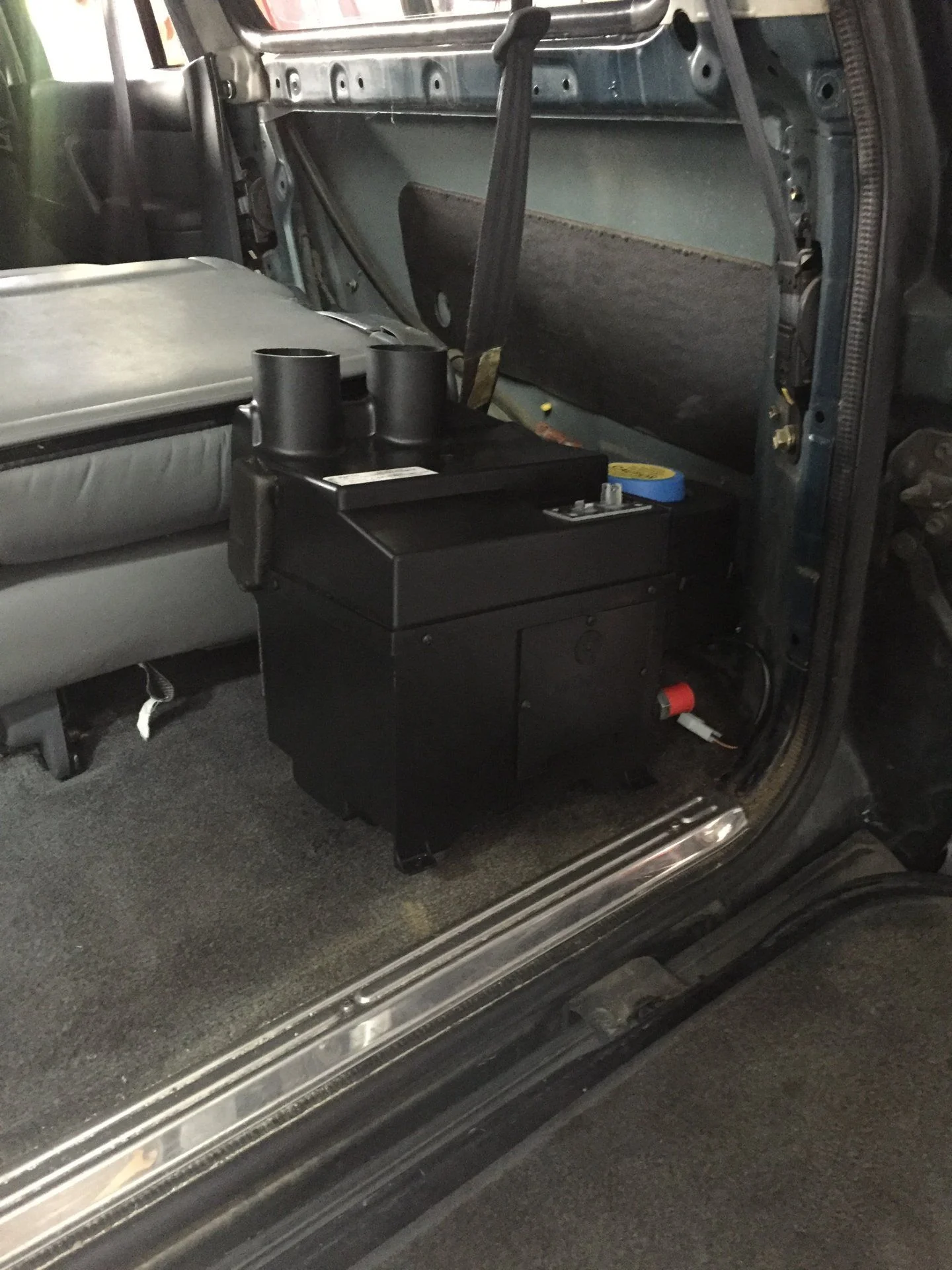

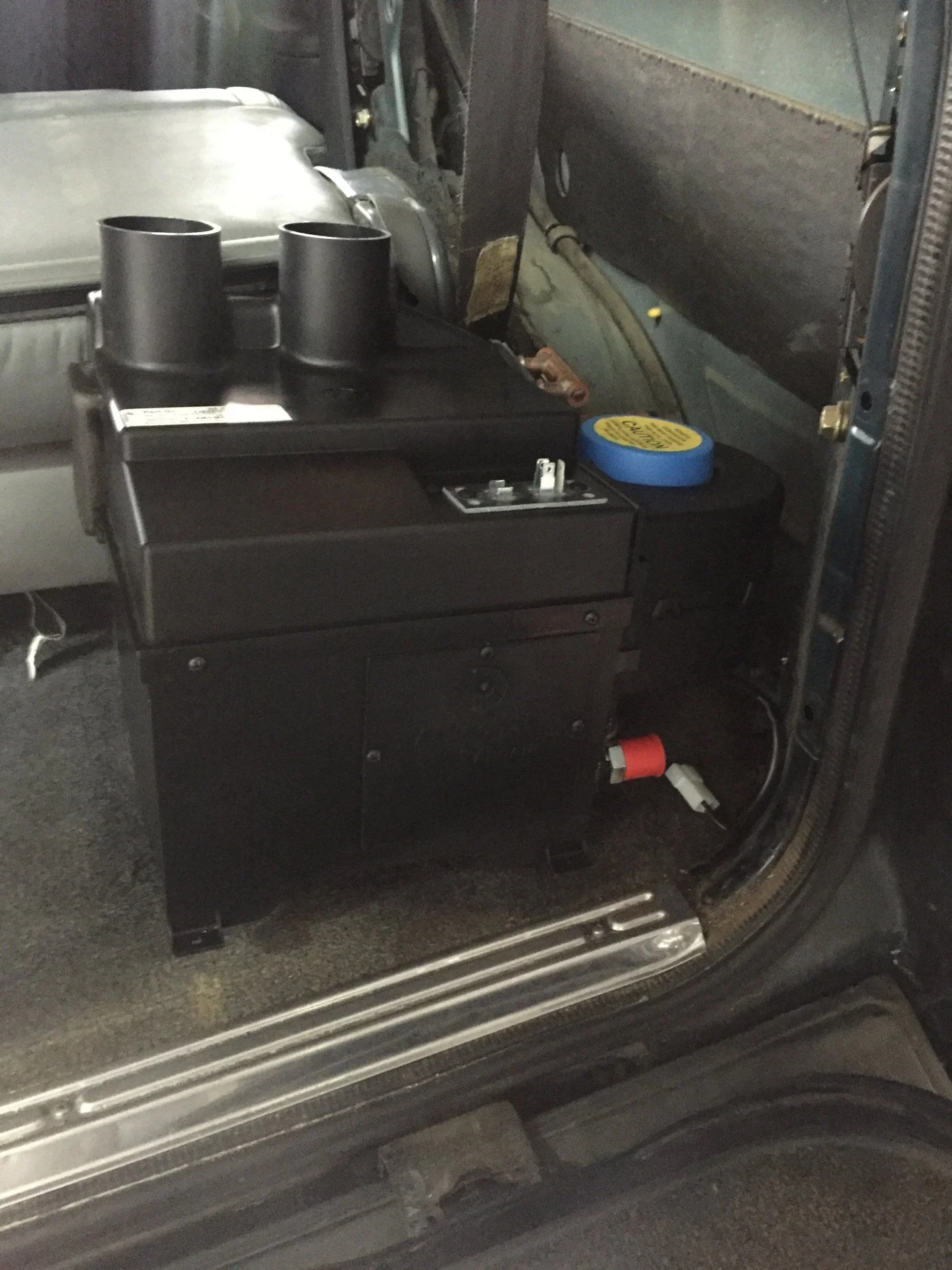

Proair air tech 2. Its huge. And its a problem. To retain 3rd row seating, I would have to mount it behind the seat as pictured. Impossible to mount it to the quarter panel like the oem unit. I looked at the smaller proair 1100. Even though its slimmer it still wont fit with the seats folded up.
Thanks for the pics. That unit is HUGE! I only have about 17 inches front to back, 9 inches wall to fridge and about 12 inches tall. That 1100 unit is closer to my needs. you may have to go with a slim unit to fit in the wall.
Vintage Air has a nice L shaped trunk unit that would accommodate the 3rd row nicely.
The heater stuff is what made it even bulkier. Im thinking about opening the unit and chopping off the heater part but thats just crazy.lol. The 1100 wont help me either. If only its easy to source the oem rear evap and blower id be all over ranma's set.
Have you looked into sourcing those parts? odds are the blower is available, the evap could be elusive.
After measuring my space, I only have about 7Dx11Wx18T. Now that ProAir 526 would fit great on my chrome attic rack with about 1/2 to spare heigh wise. That would eliminate my vent and duct issues too. Similar BTU output as the AT II.
The 526's size is 5.5x33.75x12 / 23.5lbs.

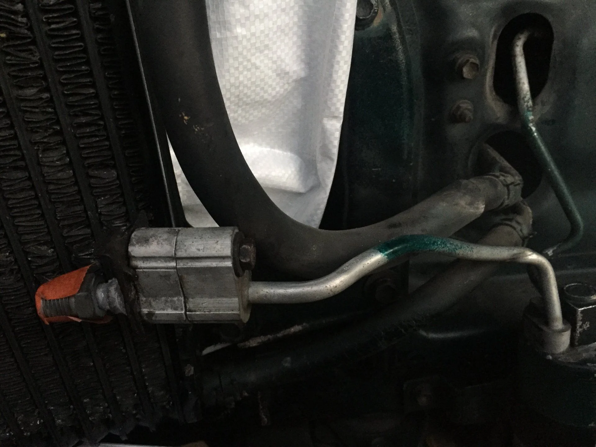

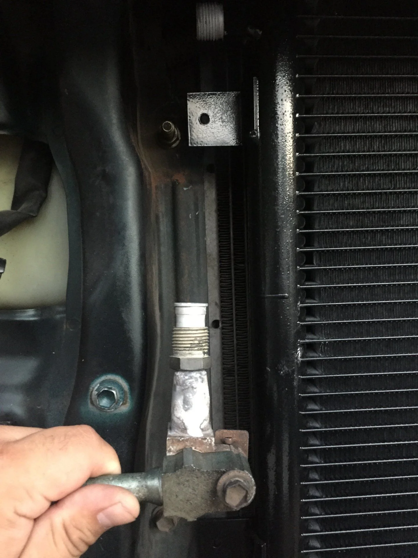

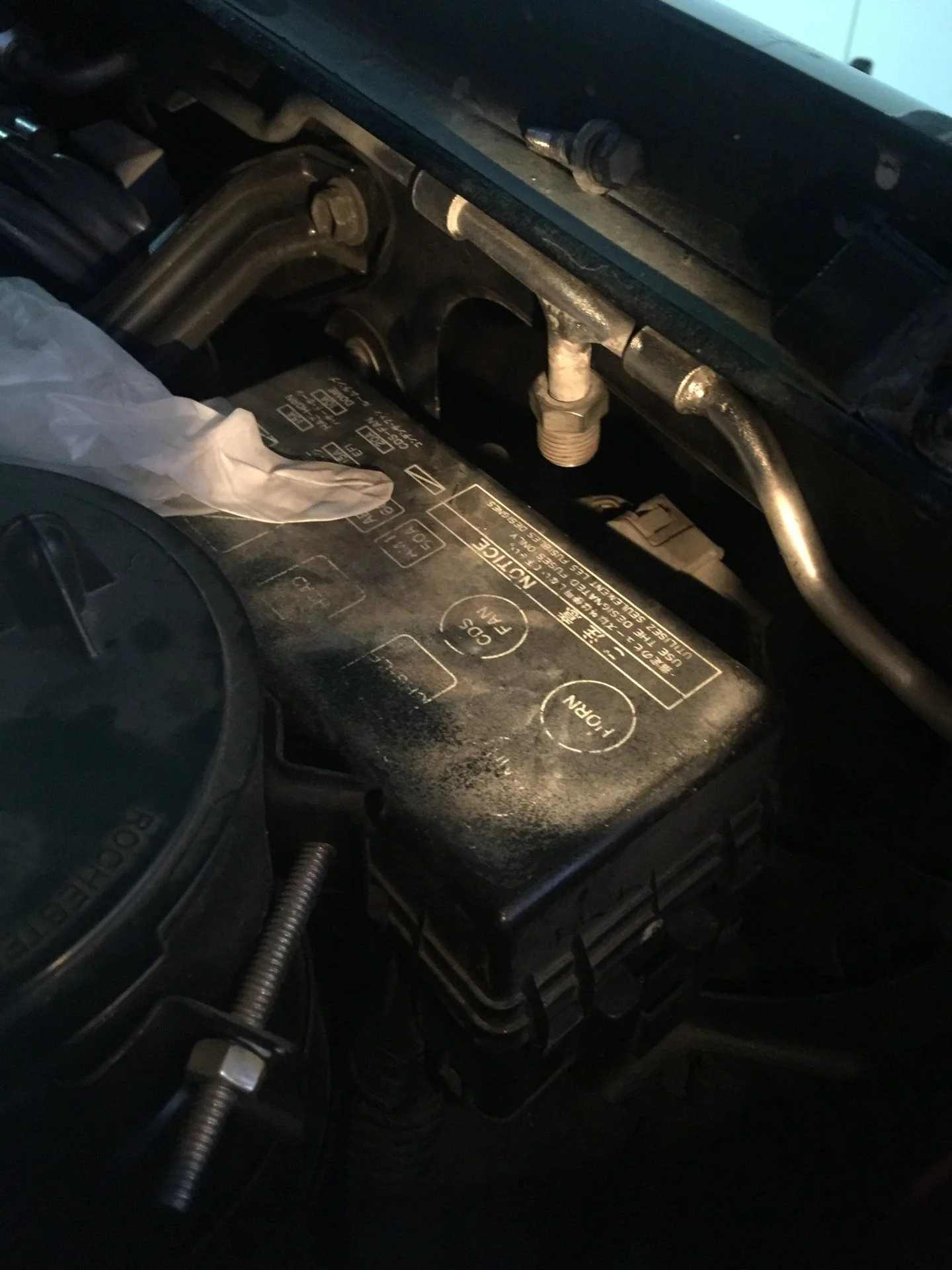

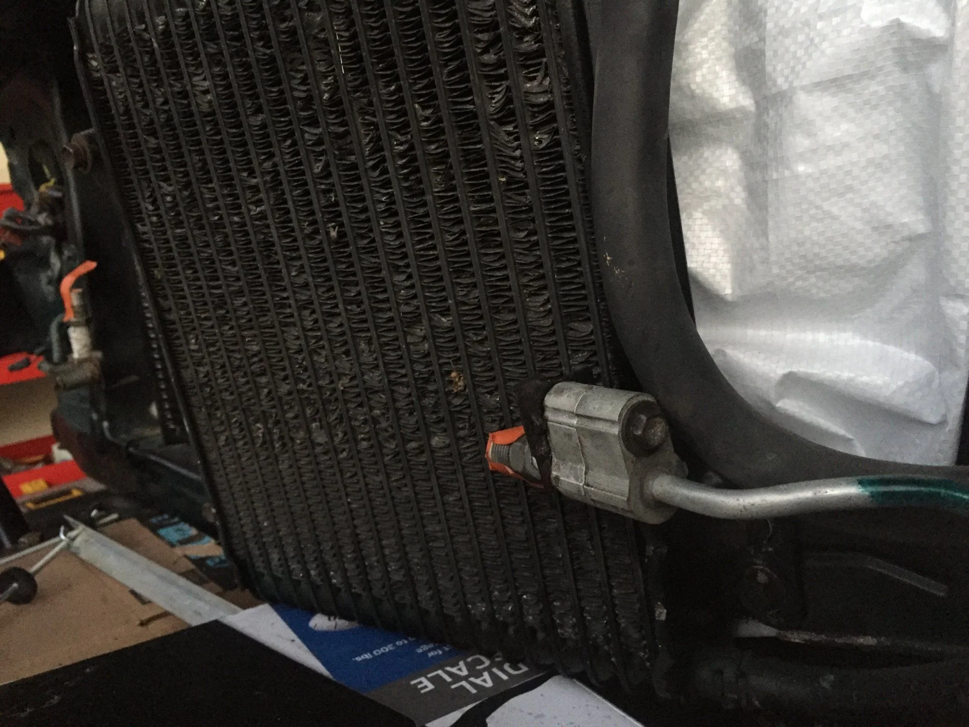

Ok heres whats happening right now. I had the shop chop off the fittings from the old condenser and weld a male AN type fitting #6 for the out and #8 for the in. They are also welding a #10 AN fitting to serve as a tee for the return from the back and a #6 AN fitting as tee to supply refrigerant to the back. Im gonna crimp my own lines with female ends to bridge the tee and the rear unit. $75 per welded fitting. So thats $300 for all four.
Ouch....! Are they welding the fittings (as in TIG), or brazing them (a completely different procedure)?
Brazing aluminum tubing (using braze type fittings) is not difficult. All that is needed is a piece of emery cloth, some flux, some brazing rods (Super 5) and Mapp gas torch. As long as you can remove the parts to be joined and get them up on a bench...its an easy process.
Doesn't sound much different than sweating copper.
They brazed it. I was just using the term weld loosely. I was looking at the process and kinda looks like soldering. Doesnt look to difficult. If i were to do it again. I would just invest time to learn it.
