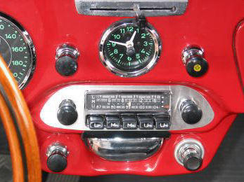

Why not a vintage black knob?
Just an example.
Porsche 356 tulip knobs.
Blaupunkt Radios for 356 Porsches
I might make something like that eventually, but the volume control is integrated into the unit, so I didn't want to mess with wiring up a different control. I'll have to make a knob that works with the existing control.
