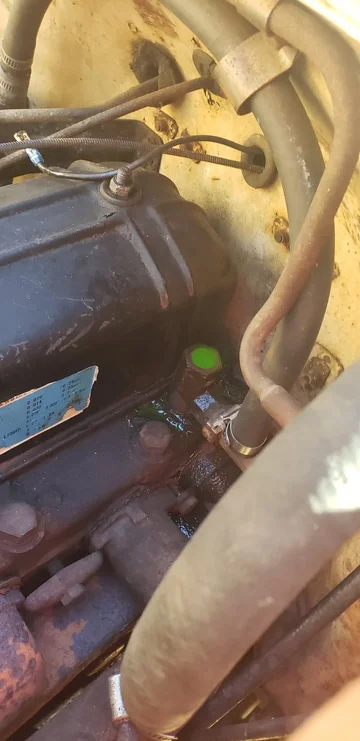

Namely the cooling system. I installed one of those Prestone flush kits that puts an in-line garden hose connection on the heater inlet and went to flushing.
Head drain was flowing, but absolutely nothing from the block drain!
Found out why... here's the drain. Completely plugged!
It still wasn't flowing even after removing that, so some digging around with a pick finally broke the dam free!
I'm going to go ahead and take a wild guess that my high temps on the gauge were legit. As I was running water through the system to flush it with the engine running the temp gauge never went above the 1/4 mark.
Glad we've got coolant circulating again! That couldn't have been good before. I'm surprised my head is in good shape..
Alright! Coolant has been flushed, did a thermocure treatment and refilled/burped the system. She's back on the road and driving great!
