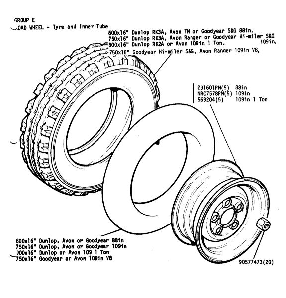

Extract Land Rover series parts book. LR series were built until 1983
and the later Defender came with tubed rims too.... see above.
the end. :)
