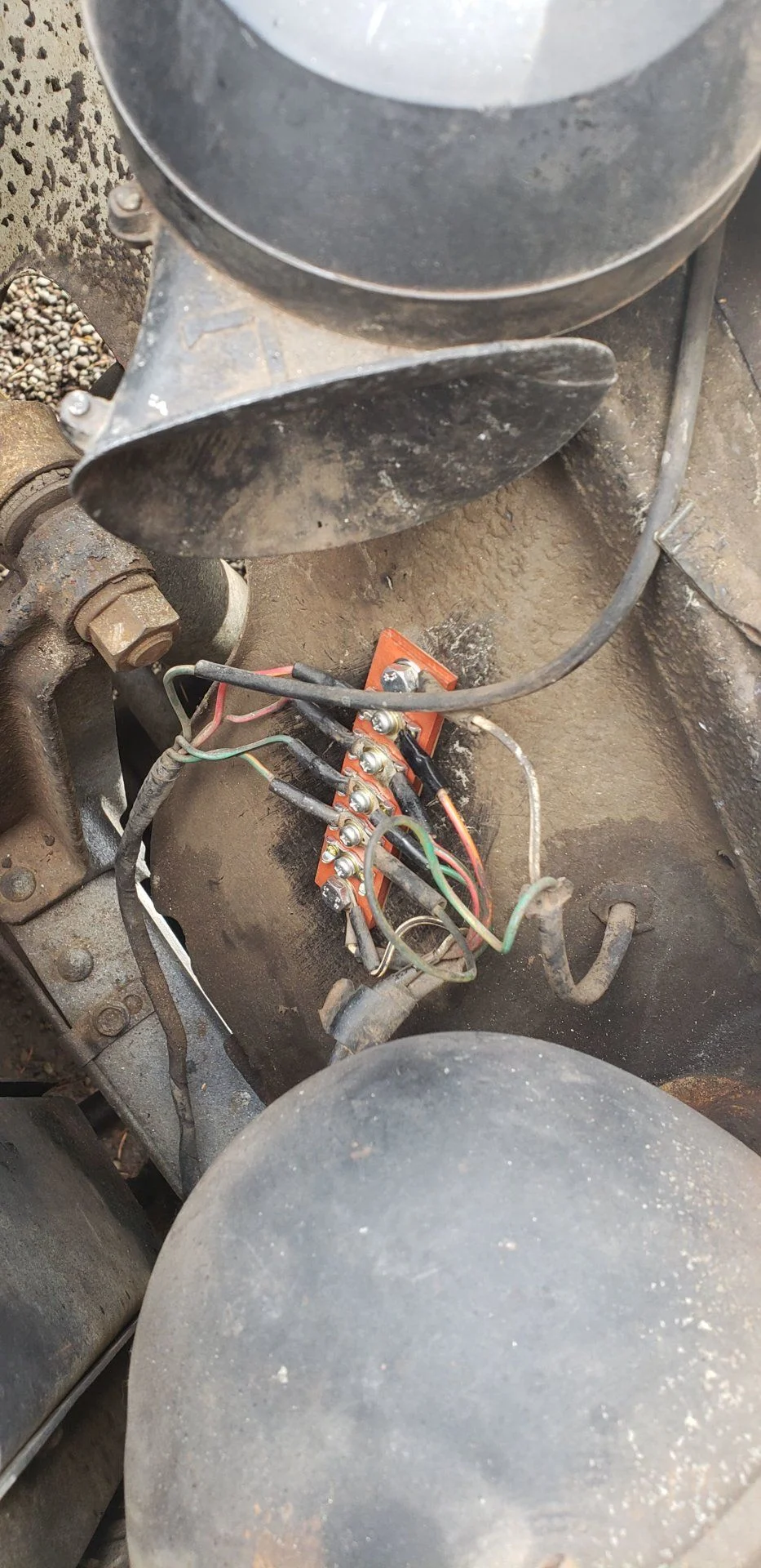

Currently having a bit of a wiring nightmare. Found a melted wire going to the ignition switch (BR wire from BAT).
Traced where it went to in the harness and replaced it, but in the process I must have disturbed some of the voodoo magic keeping everything else working, and now my lighting circuit doesn't work. Heads, tails, front markers all dead. Turn signals still work, oddly enough (I know they're on a different fuse). Lighting circuit fuse, however is not blown so that means my problems lie somewhere else down the line. My guess is the junction blocks under the hood. So i'm going to start there.

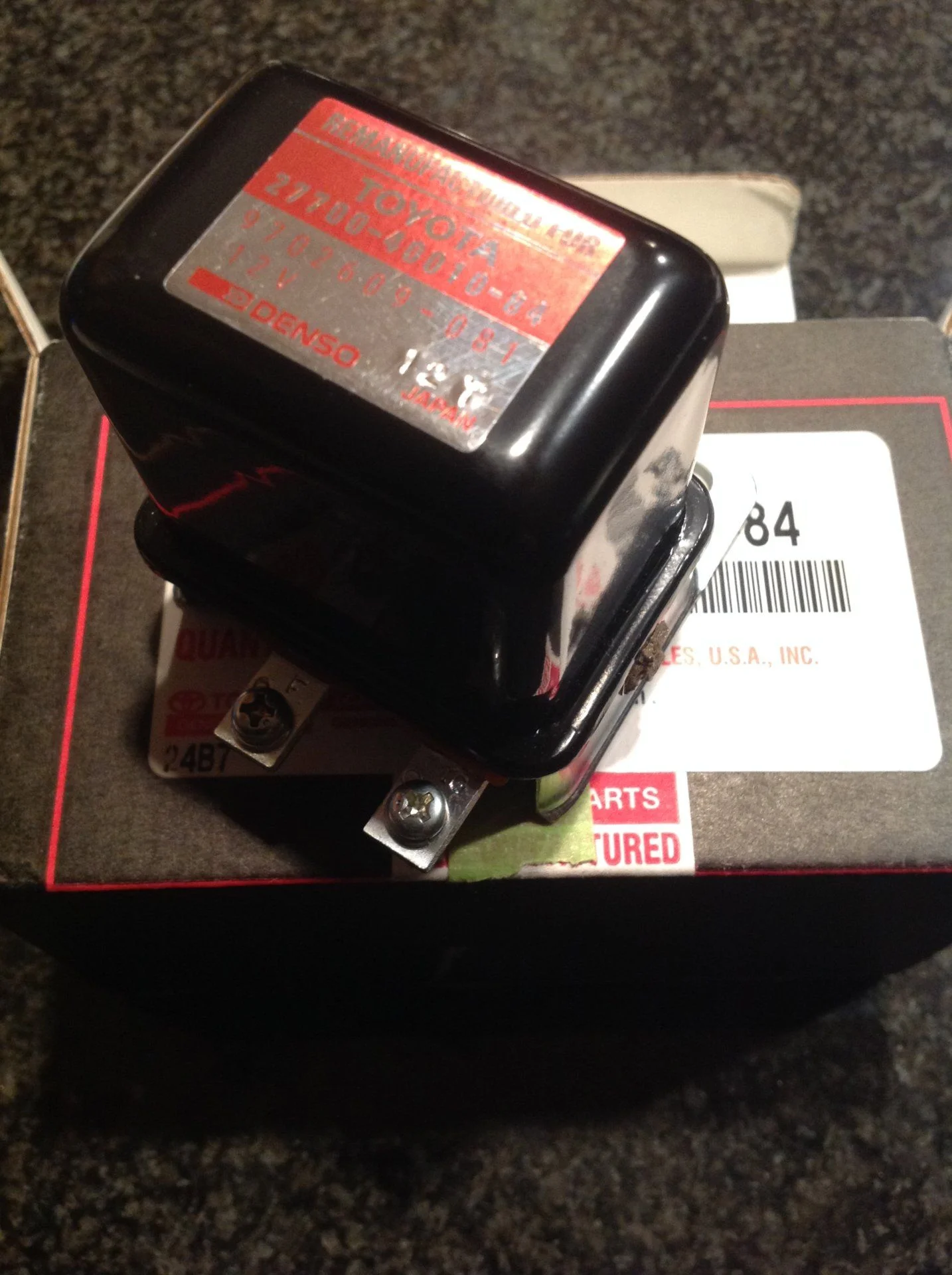

Also vaguely curious about the Voltage regulator which looks to be in horrible shape externally. as this style is NLA I'm wondering if I should switch to an alternator with an internal regulator?
Anyone have a good write-up for going from an early system to a more modern one, and how to bypass the old regulator?

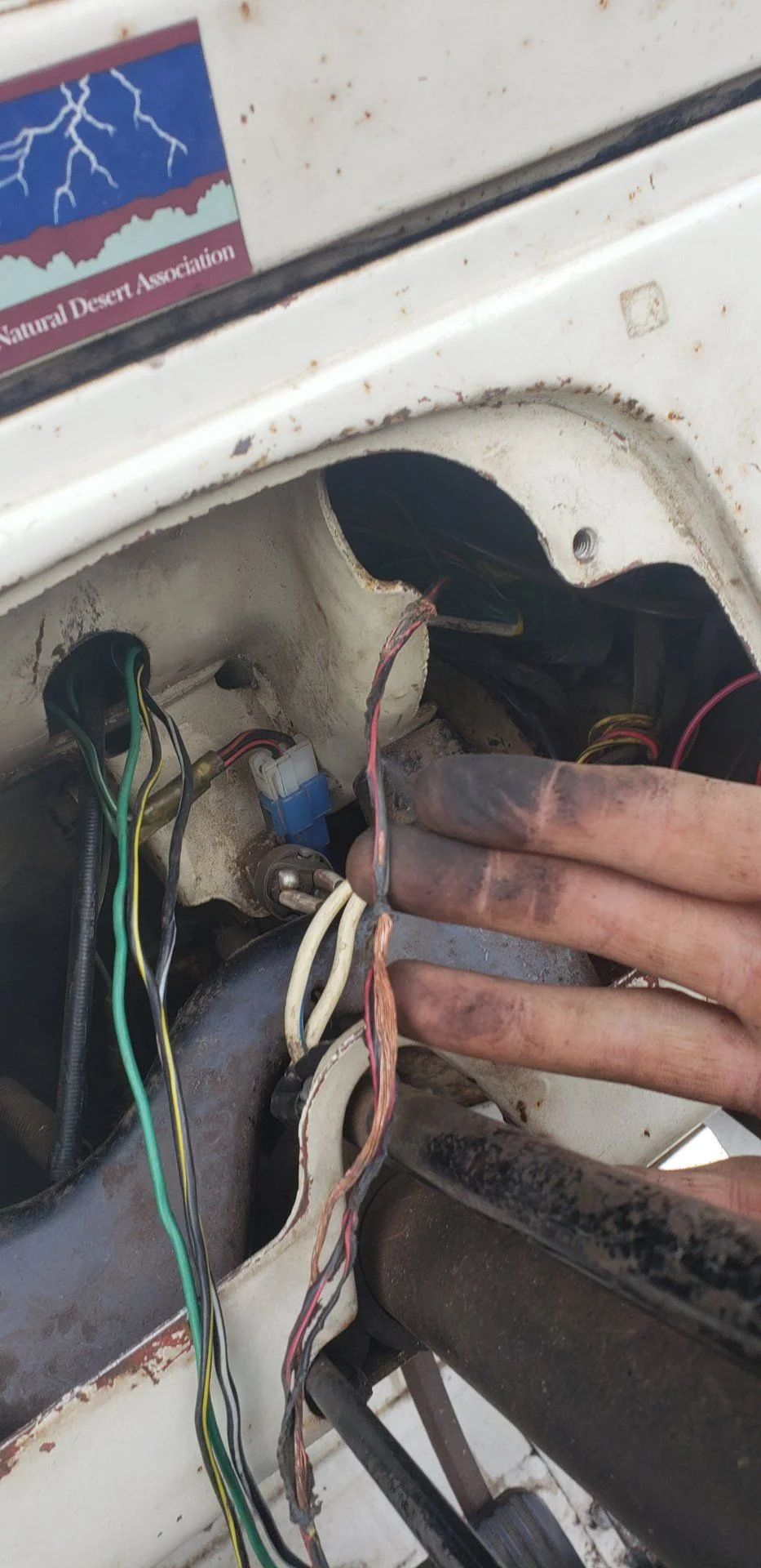

Debating starting completely fresh, and building a new cowl harness entirely. Sent an email to @Coolerman inquiring about getting all the right connectors, and already found all the correct color wires. Doesn't seem like it would be too bad to do. Especially if I used my old harness (and all of the schematics I've been able to find that match what I have).

I guess the other question i have is, can a different external voltage regulator be used if I can't get this specific one?
I used an FJ60 alternator on my 40. Got rid of all that stuff. So yes. You can bypass it.

IMHO given the completeness of your rig I’d probably go a new harness from @Coolerman. That voltage regulator is a thing of beauty though.

The plan was to put together a harness myself with the correct color coded wires and connectors from coolerman. I like the idea of doing it myself instead of sending my old harness out for reproduction. Actually sounds like fun to me and I get to learn more about how it all goes together.
I plan to stay as close to factory as possible.
Original still available from Toyota if this helps. It's a remanufactured original part.
Well I did a thing today. Was definitely nervous going into taking the harness out, but once I got going I realized just how simple this thing actually is. Everything is labeled except a few plugs that weren't hooked up to begin with. Will be trying to figure out what those go to, but everything important is good to go.
Looking forward to getting started rebuilding it.

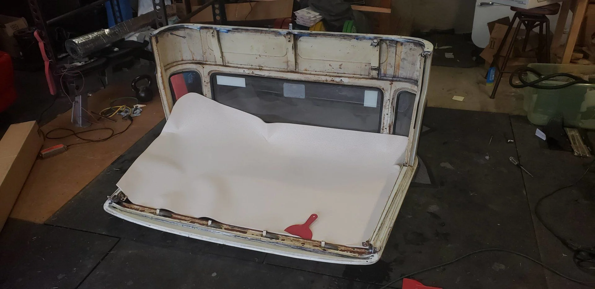

Another big project was a new headliner for the top.

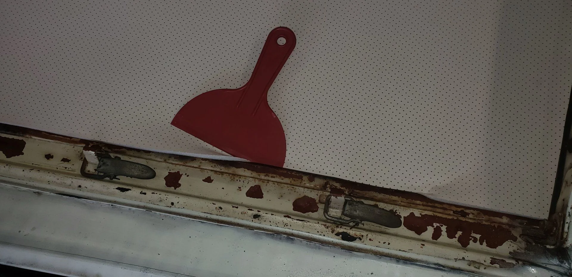

Started off with a pre-glue test fit. I found that the most important piece would be to secure the liner under the front channel. These flexible plastic scrapers were very helpful in getting that pushed into the channel. Spending a lot of time getting this lined up properly is very important, because in the next step you lock it down.
After I was happy with how the liner fit without glue I used a block of wood and hammer to crimp that metal channel down onto the front edge of the liner. Locking in the front edge.
