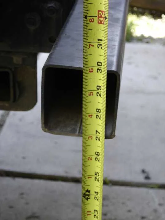

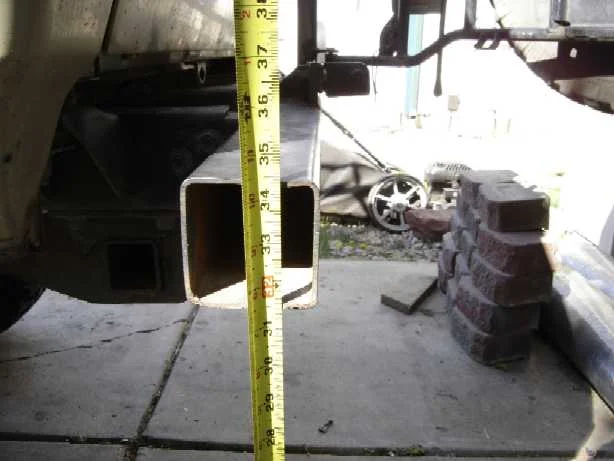

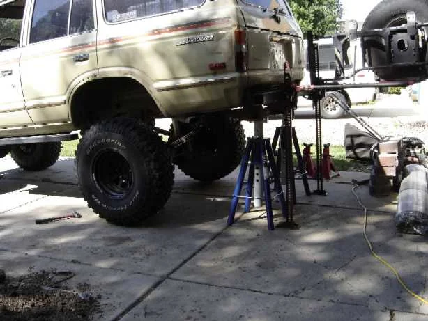

needed to level out the rear after putting on new springs a week ago.
old springs were jack cause of no wrap bar.
broken pinion in moab.
So, i ordered a set of the long add a leafs from MAF.
was able to do this without removing the springs.
love the ride of these,way better than the shorties.
before ride height and after pics.
and i got to use my new 10 ton jack stands :grinpimp:
after install ride height
all level
soooooo much better.. :D

i ordered two sets(i'm glad i did) comes with longer,way longer center pins .
boogerd the first pin up.
i dont remember if the u-bolts were stock,i already had a shortie add a leaf in my old spring pak.probably would be a good idea to get new u-bolt(longer)for doing this.mine worked fine.(probably not stock)
right now,yea,over 4" :D
well see after awhile how it settles,the ride is smoooooooth and sweet.
i also run the rancho 9000's in the back.

4 inches easy on stock 60 springs that were flat to begin with. :D
we'll see what happens later after they settle :bounce:

you'r right .. ! on flat spring is easy get 4" adding it .. :)

got the stands from carquest $250. a pair
they go up to 47 inches
