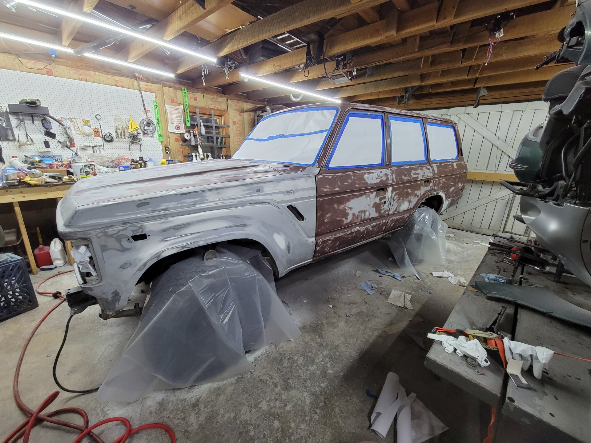

Well since that epoxy primer was sprayed on many hours of sanding followed. A shine has a way of showing all your faults and there (are still) many.
I start with a blocking of the whole truck to find the low spots. Don't really need a guide coat yet, just look for where it's still shiny after you block it with 180. Sooooo many dings there were. The hood and the roof have given me fits. The hood had a large shallow depression. Probably from years of it not being supported by the frame, and the big ass low spot was right in the open spot of that frame. Probably every time it was slammed closed it stretched the skin a little more. It wasn't much, but enough that you could see the low spot after blocking. Thank goodness for 24" Durablocks. And I've decided the PO was a tap dancer and practiced on the roof. There were probably 20 dings. Hail dings, depressions from the rack, stuff poking the roof while on the rack, etc. I'm sick to death of sanding now. I've had enough fun already.
I am really happy with how the rear arches turned out. It took a few adjustments to fix the various high spots. Skim sand, tap the high spots down, skim sand, tap, repeat. But in the end I got it nice and flat and smooth and the curve looks pretty good I think.
So tonight I sprayed another coat of epoxy primer. From here on out it will just be spot sprays till all the blemishes are fixed. The I'll scuff with 320 the whole truck and get ready for color. For that all the doors, tail gate, rear hatch and hood will come off so I can spray the jambs. Also it lets me make sure all the hidden bits are clean and I can mask better. I'll hang the door, tail gate and rear hatch from the rafters so I spray them in the correct orientation, since the paint has a little metallic in it. Hood will be on paint horses. Then comes assembly.

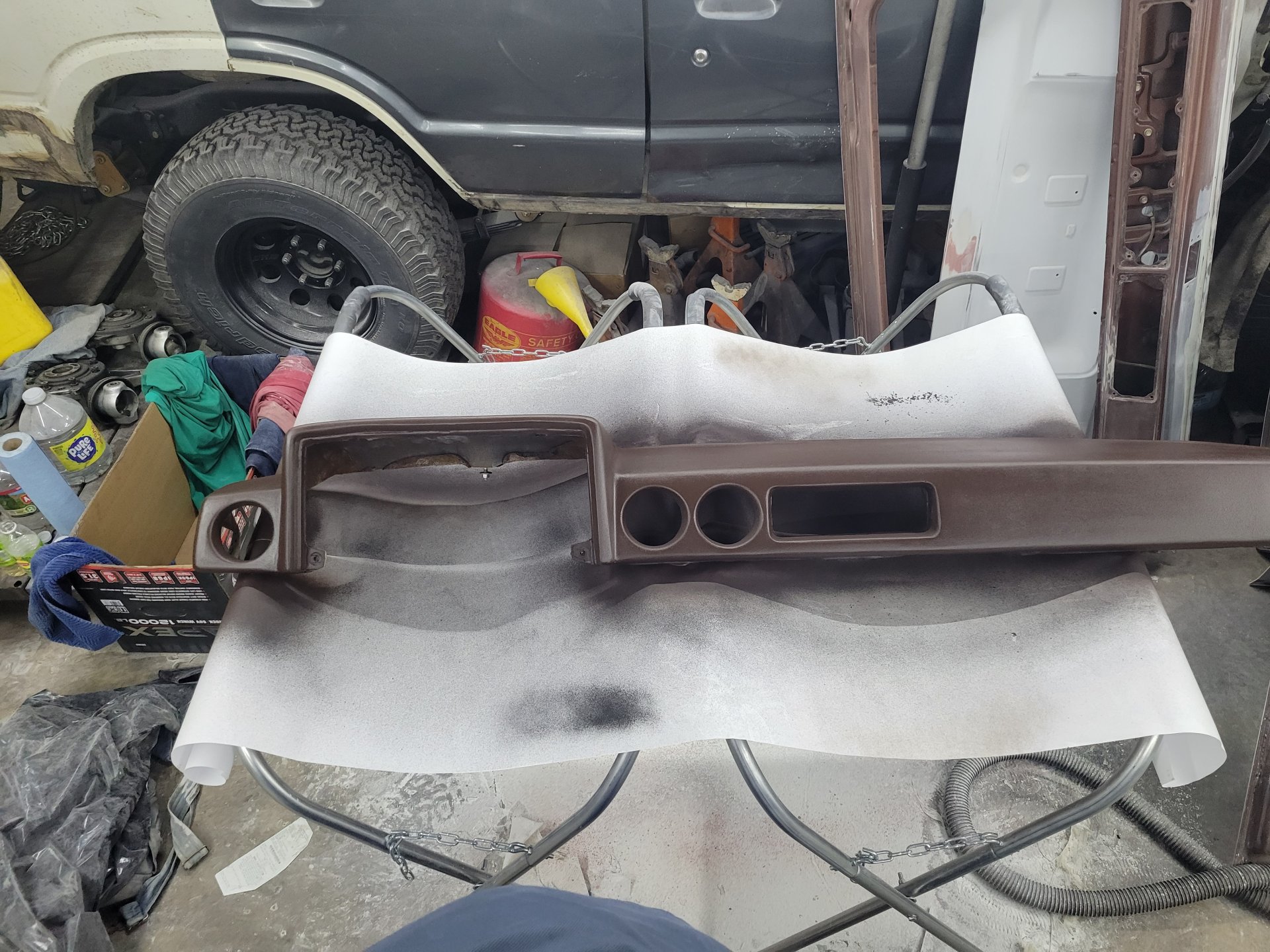

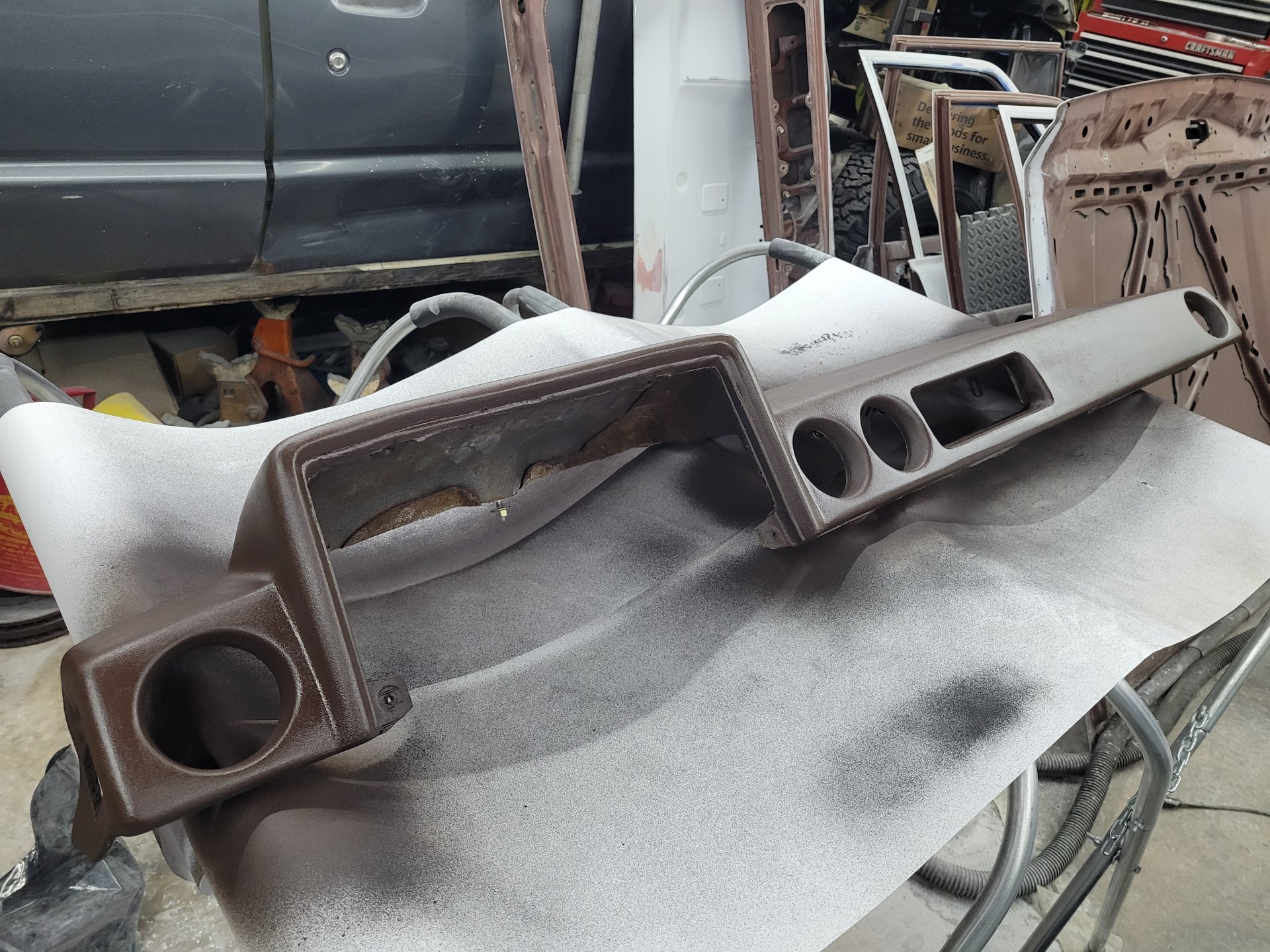

Since I'm waiting I try my hand at restoring the dash. I've watched lots of videos on the topic but have never actually done it. I get to work cleaning up the old cracked dash. Note: use a heat gun to soften the vinyl and it will cut instead of cracking.
With the worst of it cut away I sanded with 80 grit since I will use fiberglass as a top layer. But first I have to fill the cracks with body filler and sand. Here's after the layer of fiberglass.
Now I need to get the surface totally smooth and ready for paint. More body filler and lots of sanding. Then I use the SEM texture paint as the initial base coat. Once dried I knock the high points down to give it a more even surface, but still retain the texture. 320 grit paper with very light pressure here.
Then I wipe that down with a rag that was lightly misted with water to remove the dust. Wait 15 minutes to ensure it's dry and start topcoat. I gave it 3 passes, 2 light and 1 wet coat. Once dried I got it with 320 grit again VERY lightly to get everything smooth without removing the texture. Then hit it again with topcoat.
I think it turned out alright!

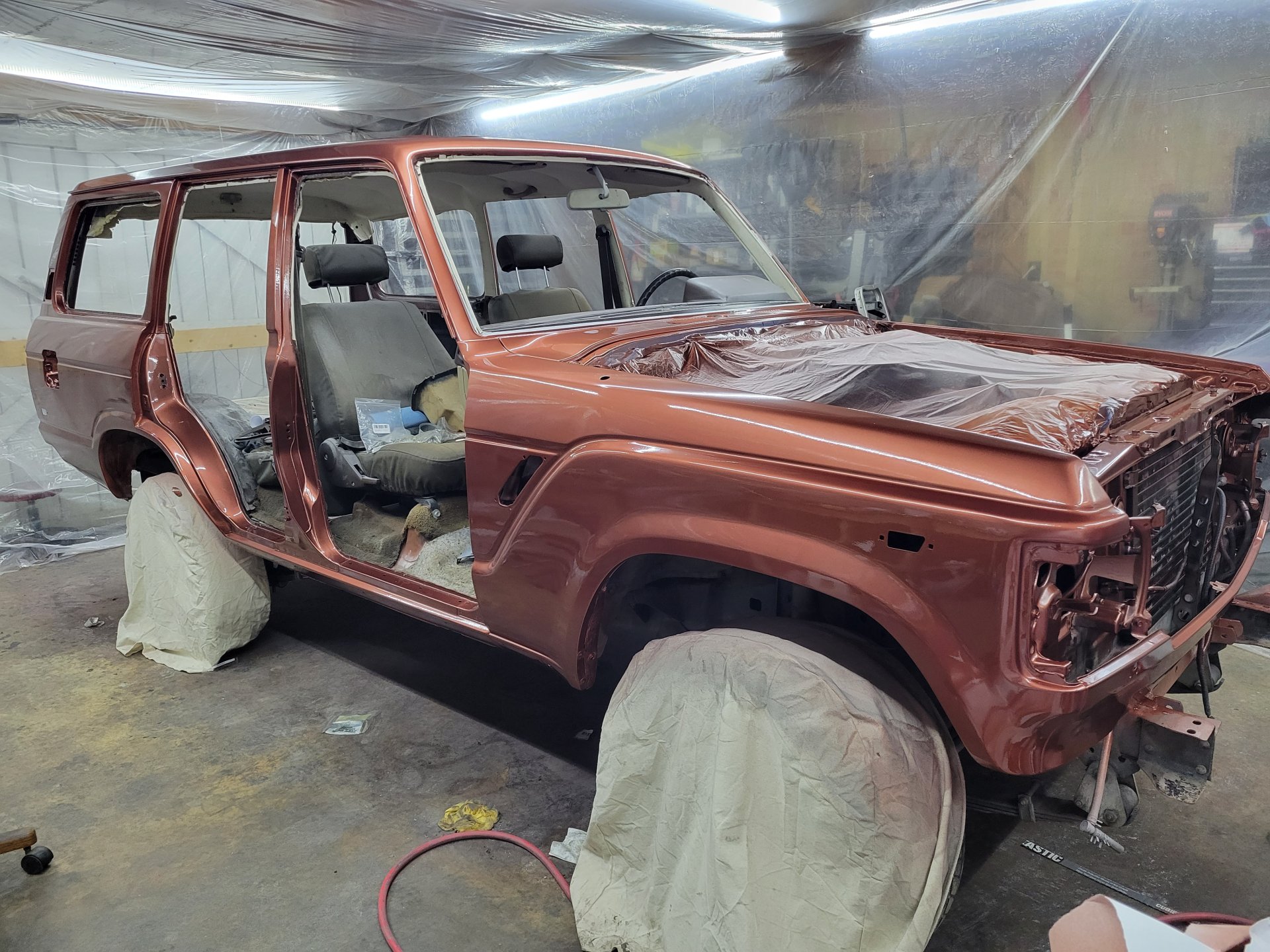

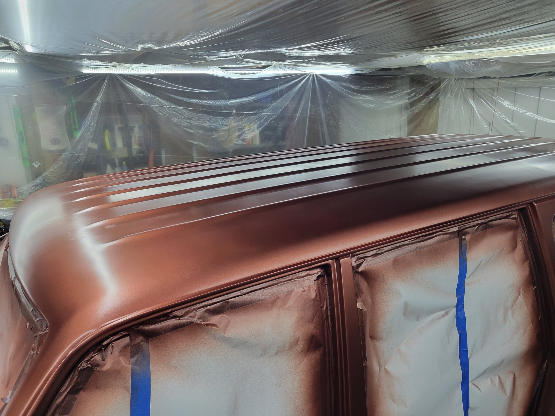

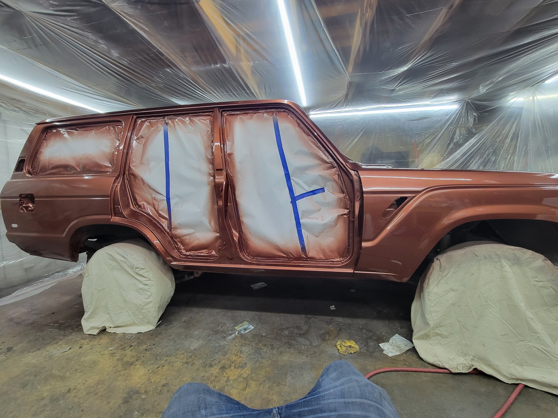

Now, let's get back to the truck. Yesterday the weather was about as good as I was going to have for the next week or so, so I decided to move forward with painting the main shell. Since I'm doing it in my shop I want to hang plastic everywhere to minimize over spray throughout the shop, but also to minimize crap getting on the truck. Hanging the plastic was no fun, lemme tell ya.
With it all up I arranged all my fan to create a negative pressure to clear out the shop when spraying. I got everything in order, and got to spraying. 3 coats of base and 3 coats of clear.
Today as I look at it I've got 7 small (3/4") runs to fix, but otherwise I'm real happy with the results so far. I'll need to cut and buff, of course, as I've got some orange peel and dust to clean up. But otherwise it went on real well. The clear laid out nicely. It was probably 85 degrees in the shop and the medium reducer was just right.
It's a Toyota color, a little lighter than the original. The original paint code was 474 Copper Metallic, this is also shown as Copper Metallic but the code is 4T9.
