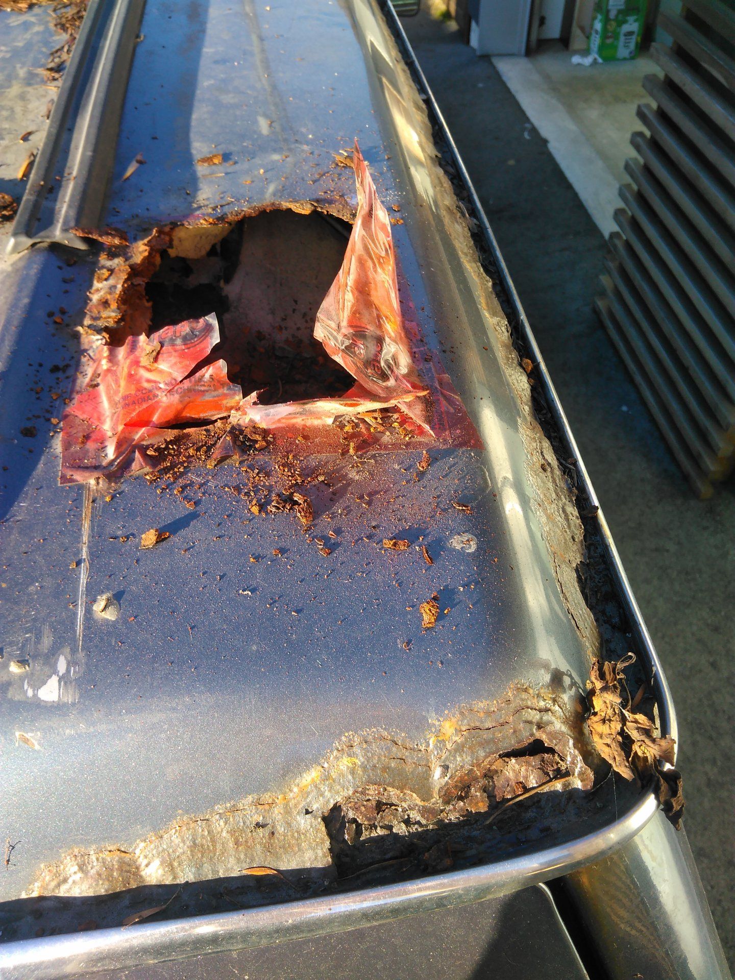

Well today is a 1 step forward 2 steps back kinda day. I realized I needed to get the roof rack off and once off was greeted with some lovely stretched holes created by the big ass sheet metal screws holding on the roof.
So this requires the removal of some of the headliner. I guess I'm lucky it's not the factory liner as the glue was pretty easy to soften with a heat gun. Once in there I pushed back all of that Japanese drier lint they stuffed in my roof and went to work closing up the holes. Note to self: wet the drier lint BEFORE welding the hole, s***forbrains. Thankfully I smelled the smouldering and got a wet rag into there lickety split. Moving on, I wetted the underside of the roof then welded the hole close and ground them smooth. Used a hammer and dolly to get them back into shape. One step forward.
I've been curious, so I looked under the bottom driver's side corner of the windshield gasket. I saw exactly what I hoped I wouldn't see, FFO. F#©<ing Ferrous Oxide. Awesome, now the windshield has to come out. Well, I had been looking at the scratch on the passenger side, but I figured I could live with it. It not in my line of sight afterall, so I figured Screw It. But now I gotta pull the friggin thing, dammit. One step backwards.
Luckily it's had a windshield in the fairly recent past as the gasket is nice and supple. It get the top corner walking out pretty easy and using light pressure. It was at this time I heard that noise. Sounds like a quick tap on the windshield and I watched the crack race across right in front of my face. Well uckfay emay. I guess that scratch isn't going to be a problem after all. Hopefully the 62 windshield is good or this just got a bit more expensiverer. Big step backwards.
Now for the rust, I've got a few spots to deal with under the gasket. Also have a skinny line of rust where a windshield guy ran his knife along the bottom cutting off a gasket. A couple places the rust has popped through, not much, but still.

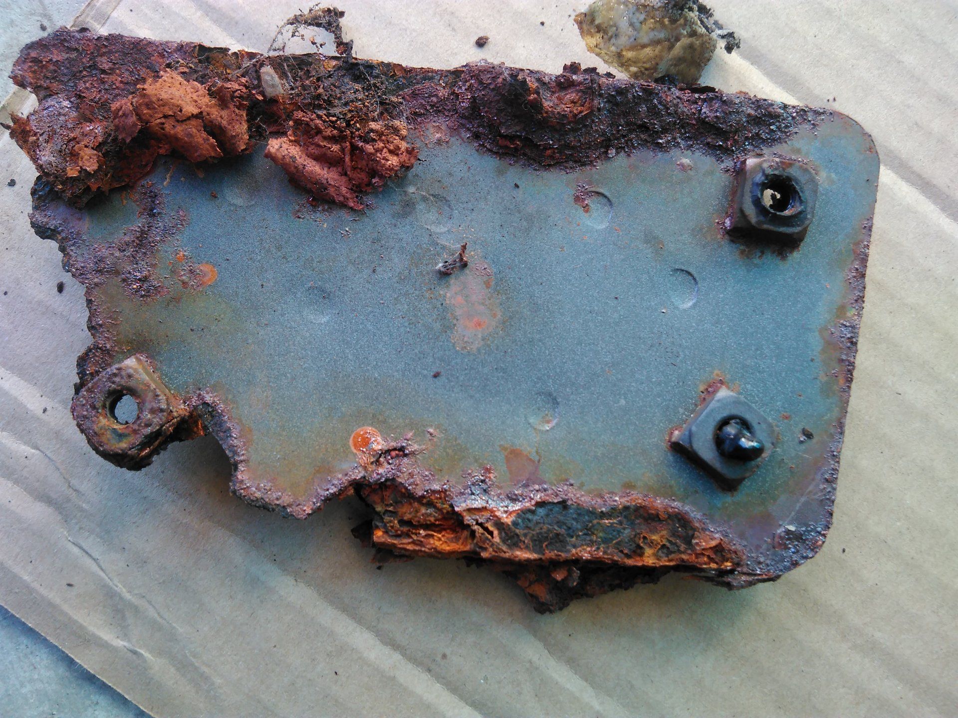

The stock roof rack on my HJ60 had a backing plate with welded nuts to hold on the rack. Toyota does it properly, even if it does leak and cause a ton of rust 30 yrs later...
Shlt fire, that looks gnarly. Having done a roof in that area I remember how much fun that wasn't. But yeah, I wonder if the stock rack accessory would have come with backing plates and someone was like "No thanks, I'm not pulling the headliner. Sheet metal screws will do just fine."

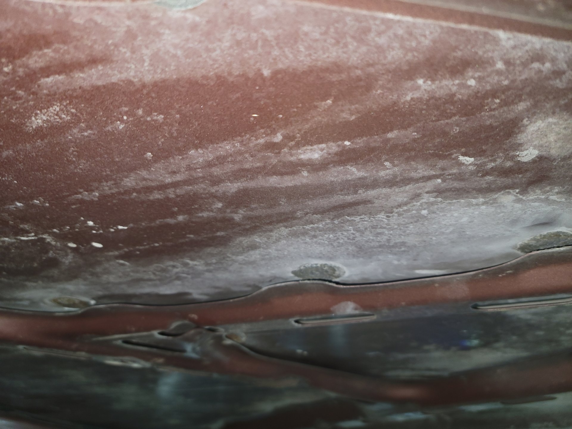

Anyway, so while I was back there I pulled the carpet back and removed the weather stripping and found a little rust. You kinda expect it there, TBH. I couldn't tell if the surface rust was running up under the factory sound deadening, but most of the deadener was pulling away from the deck. So to be sure I popped about 8 inches of it back all across the rear. There was some surface rust that had climbed up under the deadener, but by and large it was clear. The weather
stripping lip was eat up in a couple spots so I went to work on that. And that damn body sealer, aka Rust Ensurer, had let a little get down in to the seam of the lip. So I popped off all the rust ensurer to see if it was everywhere. It was only in a couple spots and I was able to get the convertor down into the seam. I cut off the bad metal and prepped the area for new weather stipping tab in those areas.

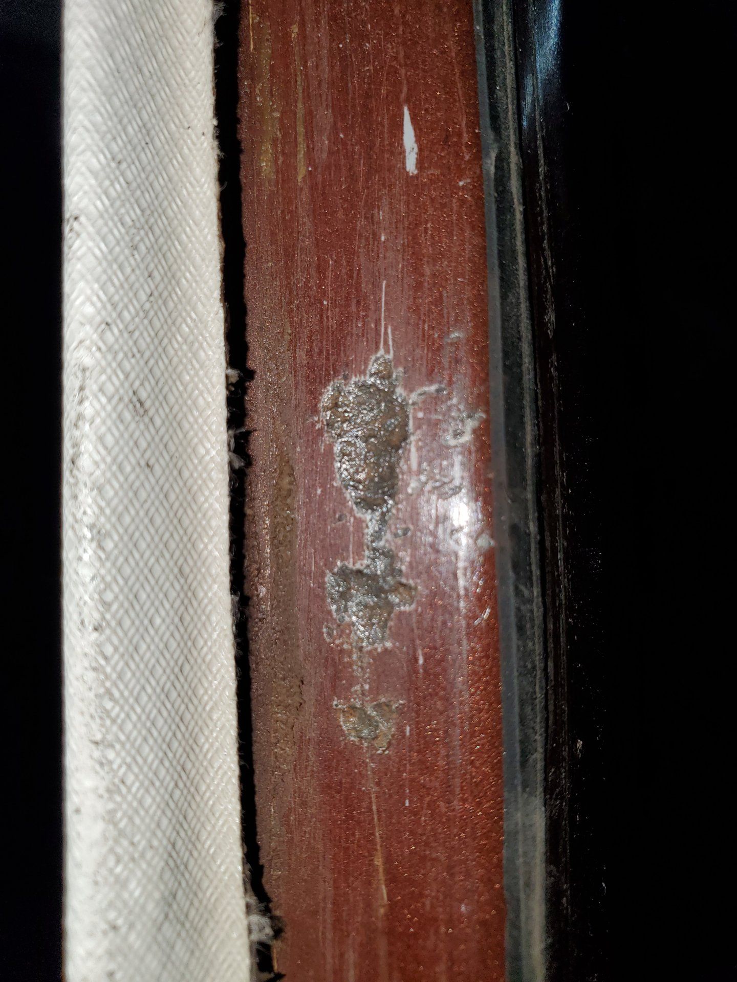

I spent some time on the lift gate to see what's up with that Bondo I found. I took the flap disc and got to work removing it all. It was kinda thick in places but once it was off I could see what I was dealing with. It was pretty bumpy under it all, but the bare metal was clean, so no moisture got under it. But it needed a good bit of work to get it much closer to the original state.
You can see some of the holes they drilled to pull the dent(s) out
I pushed the Bondo out and used the hammer and dolly to smooth our the metal. Then I welded up the holes, smoothed off the welds and covered everything in 2 part epoxy primer. While in there I went ahead and got rid of all the seam sealer and put some rust convertor down in the seam below the glass. There was a little surface rust, but nothing serious, but I did it purely as a preventative measure.

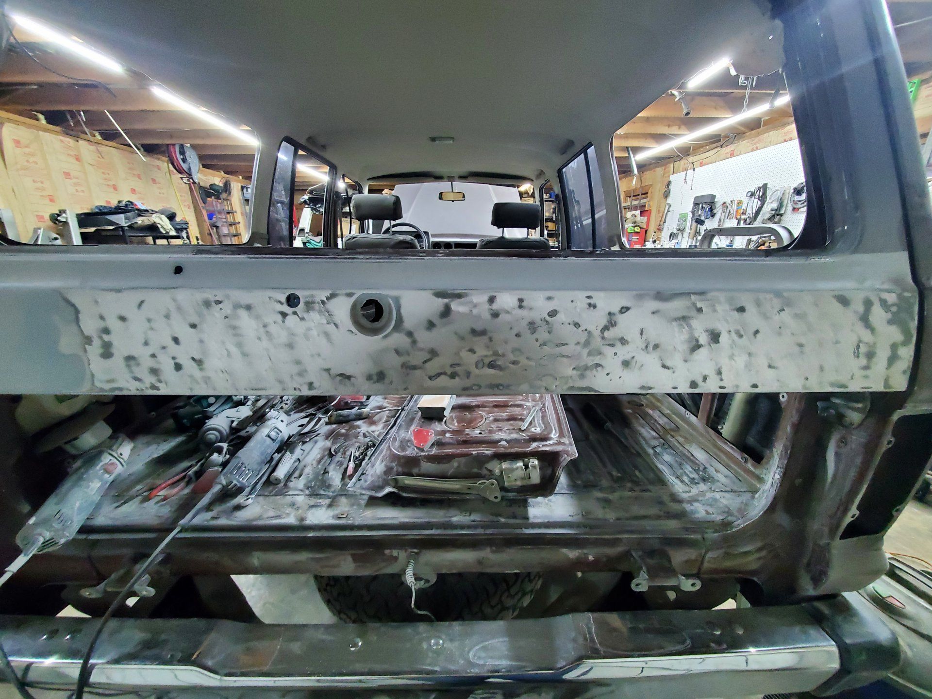

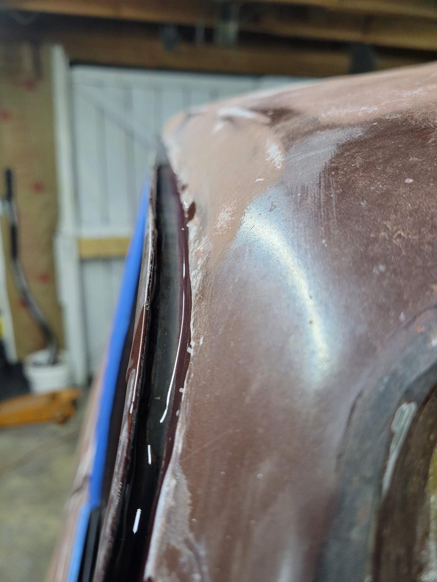

So I have moved on to the part of these projects that I really do not like. It's slow, it's tedious, but it's so critically important to get it right. Being a bit OCD about some things means I will spend WAY too long on little stuff that most people might ignore. But I know that if I don't take that extra hour or two here and there, I will see it every time I walk up to the finished product. I'm going to have little things that will still be there that I just missed, but if I see a ripple in the paint because I was too lazy to spend a few more hours block sanding then that's going to annoy the hell out of me forever.
So I'm working on the hood first. It's big, it's flat and it's pretty easy to start with to get back into the swing of using body filler. I actually like the smell of this stuff, but I always forget a few things. First, use less hardener than you think. This is especially true when it's hot as hell. The first two batches I made were setting up in like 3 minutes. Second, don't try to do this with 320. 80 grit is your friend. And if you've got the cheese grater tool, use that first. Third, sand it down right after it's set up. It won't be crazy hard yet, so it will cut down pretty easily.
You can see in the pics below I'm working through all the hail dings, but I've also got some big low areas. I suspect this is caused by two factors; 1) The adhesive between the hood subframe and hood skin is gone. This happens with age and will cause you major grief if you don't resolve it. I have some 3M NHT arriving today, hopefully. This adhesive is made for this application, and while it's $50 for 200ml, just pay the money. Amortized over 40 years, it's cheap. Some people use urethane window adhesive, but I didn't want to have to screw with this again or see waves in the hood because I wanted to save a few bucks. 2) because the adhesive had disintegrated with age when the hood was whacked in the front driver's corner, that stress tweaked the hood and the skin developed these shallow spots. Not a huge deal, just means I will have to skim larger areas and block them to smooth that section out. The depression is like .5 deep, but when you get shiny paint on it, it will be very easy to see with the naked eye.
Anyway, once I'm done with the hood which should be this week I'll be moving on to the rest of the body. Every panel is going to need a good bit of skim to smooth them out. This truck has been well-loved and well used over its life, and life has left it with a few bruises.
Here you can see the gap between the hood skin and frame. The 3M NHT is good to fill up to a 1" gap. The idea is to simply bridge the gap between the frame and skin with the NHT adhesive, ad this used to be filled with a foam adhesive from the factory years ago.
And a couple of shots of the progress of the hail damage. You would be surprised at how much time it takes to fill and sand a single ding. Oh, and I remembered another thing about using the body filler; use less than you think you need. You can always mix up more, but if you slap a ton on there you will be sanding for a week to get it all down to the metal again.

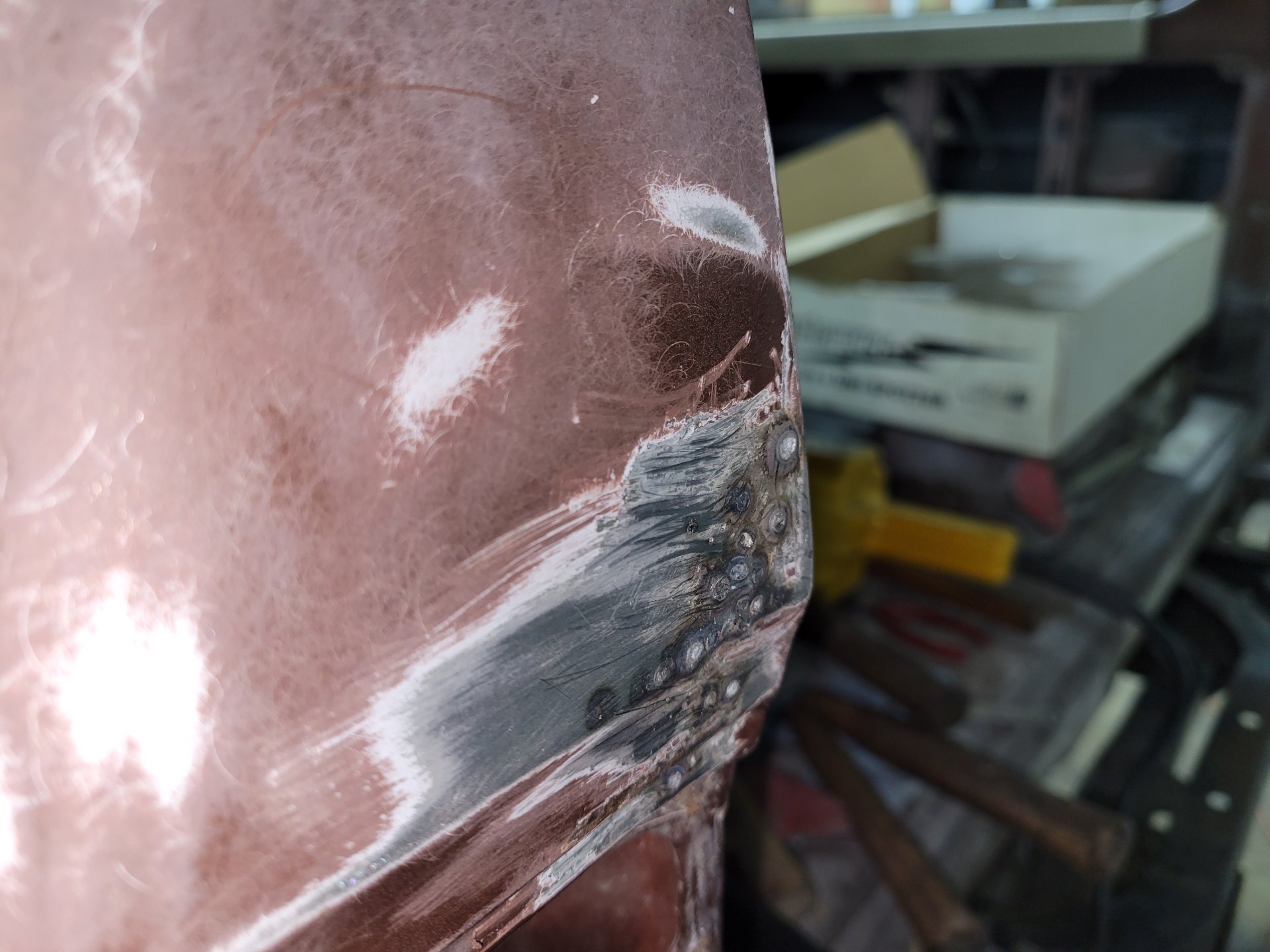

Since I can't do much on the hood I am moving around the rest of the body and fixing dings here and there. And since 7 months had passed I'd forgotten about one little area that needed some attention. If you will recall the rear lid had been whacked and someone did a decent job of straightening it out, skim coating it, and then spraying primer all over it. I removed that since I had no idea what they actually used for filler and they didn't use a moisture barrier topcoat, so it could have had high moisture content if they used something like Bondo instead of a good one like Evercoat. Anyway, when it got whacked the stress pushed in the rear corner just above the driver-side rear tail light. The crease was about 1/2" deep and ran up almost 2 inches. The main problem was getting in behind it to push it back out. I could get my hand back in there through the interior opening, but it was curved so no way to get something like a wooden dowel behind it and bang it out. I could rig something up like a J hook and pull on it but then I remembered something I was given about 10 years prior. It's called an Autoshot stud welder. I tried it once on another project but that was a very long time ago and I really didn't know what I was doing at the time. Anyway, I dug the box out blew off the dust of dead bugs, and opened it up. I had 3 1/2 boxes of studs in there the gun and the slide hammer.
First I used the regular-sized studs with moderate success. The basic process is to get a flap disc or something to remove all the paint from the area, load a stud into the end of the gun and then press the stud against the body where you want to attach it for pulling. It's spring-loaded so the stud will touch first and then you keep pressing until the grounding ring around the tip is also touching. Then you pull the trigger for about 1 second. You will see it glowing in there and a little smoke will come out. Be careful and don't hold the trigger for too long, a second is all you need, much longer and you could melt a hole through the body at that point. Let off the trigger wait another second for it to cool and then pull the gun away. You are left with a stud sticking out from that point. Get the slide hammer and put it over the stud, roll the little locking wheel onto the stud, and then pull tension on the stud. Now while keeping tension slide the hammer forward and then start whacking away. Don't slide the hammer too far forward and bump the back of the stud lock as that will cause it to release the stud. Just keep pulling until either the stud breaks in half, which they do frequently, or you've pulled it as far as you want. Also, don't go bananas here, you don't want to tear the sheet metal. Like most all bodywork it's a lot of watching what the metal is willing to do and coaxing it along. In the end, I got the dent 95% out and close enough that a little skim coat is all it needs to look 100%.
In that picture you can see where the paint is still shiny above all the pulls, that's because the crease ran up that far and the sander couldn't touch the paint there. As I pulled it out all the surrounding areas came back in alignment. This is the kind of stuff I enjoy doing, y'all can have the block sanding.

Another part that needed to be addressed was the rain gutters. As we know these are what get the roof rot going and are deadly to these trucks. The factory filler has long since turned rock hard and cracked, letting water into the panel welds below. Then it traps the water in there and cancer starts. Once it's in there good it runs the whole length of the seam and eventually, you have what I faced on the FJ62 project. A total F'ing nightmare to fix. Luckily this truck had no real rust up there. I popped off all the old sealer many months ago and hit it with a rust converter back then, just to be sure. Then today I used the 3M self-leveling seam sealer to fill the channels all the way around. If you are going to do this you will need two of them, the special gun and a fair bit of patience. Here are my lessons learned; when you are filling the channels fill the outside of the gutter first. I just ran it along the gutter expecting it to flow completely into the channel. It will flow, some, but it's not like honey, it's more like warm peanut butter. So get the nozzle back up under that lip and run it there first. I had to go back and run the nozzle along the underside of the rain gutter lip to ensure coverage. This is time-sensitive, you've got about 10 minutes after it comes out of the nozzle before it starts to set up. So ensure cover WHILE you are in the area. Next, as you are pumping along and need to move to another area you will need to relieve pressure on the gun so the epoxy stops flowing out. Otherwise, you will have the stuff dribbling out while you are trying to move about, or it will just keep filling an area and you'll have too much in a particular spot. For the front channels next to the A-pillar, you are going to have to help it a little. The gap is too narrow to get the tip all the way down in there. I filled it a bit heavy at the top and let it flow down and then slowly went down the front with the gun perpendicular to the A-pillar. I was putting more in there than was actually needed, but I needed it to flow to the bottom of the channel, and I used a razor knife to run along the channel to hopefully allow any air pockets to escape. I used the knife because it was there, anything very slim should do the job. Then let it run down, it's going to dribble down into the door hinge area, but you can clean it off later. Once you get all this done let it just sit, and it will flow out nicely and will be set up in about 30 mins. It never gets really hard and is very much attached to the truck now. It's very good stuff and I would recommend it highly. Another one of those things where you just pay the money.
You can see the bare metal through the sealer. This is about 5 mins after application and it's flowed out nicely. This stuff should be good for the life of the truck.
