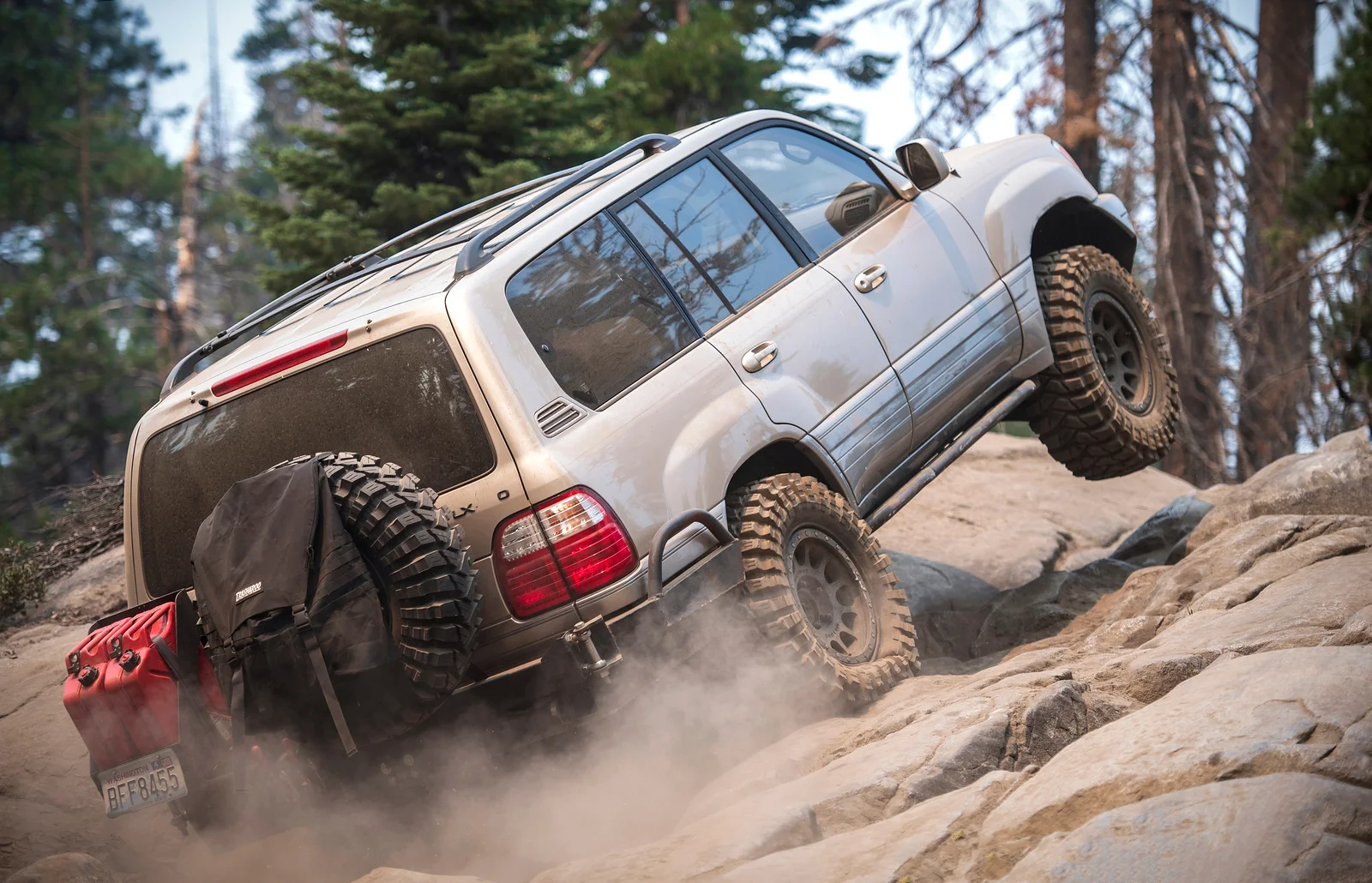

I'm with Greg on this, I have rigs that are tripple locked, rigs with CC and A-TRAC, it's not even close, Lockers give you so much more control over obstacles, you need less tire spin going through obstacles(but can have it when you want it) etc... It's really night and day in my opinion! Just my 2 cents after beating on LC's for over 30 years 🤪 A classic version of an "Overtrail" HAH

Ken your photos are “chefs kiss”

amazing shot!
