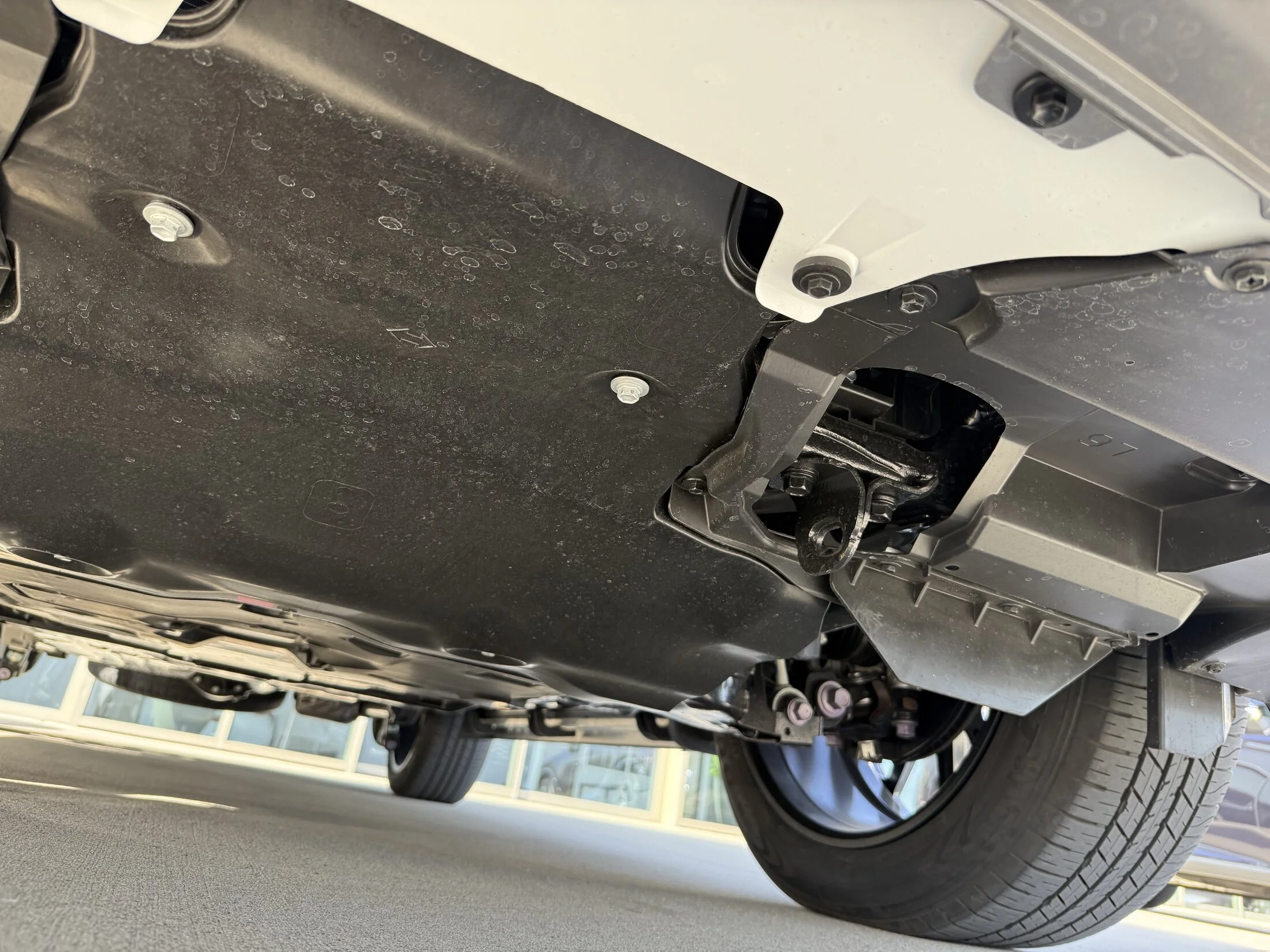

Not sure if anyone has asked (searched Mud this morning) but do we think you would be able to put the Overtrail Skidplate on a regular LX600?
I went to the local dealership and did a bit of comparison a few weeks ago, but after searching in their part system they didn't have any luck finding the metal skid plate as far as we know. The only number we found was 51420-60110 but he said this was universal to all LX's (most likely the plastic one).
Does anyone know the Overtrail skid plate part number / have an Overtrail they could look for the number on?

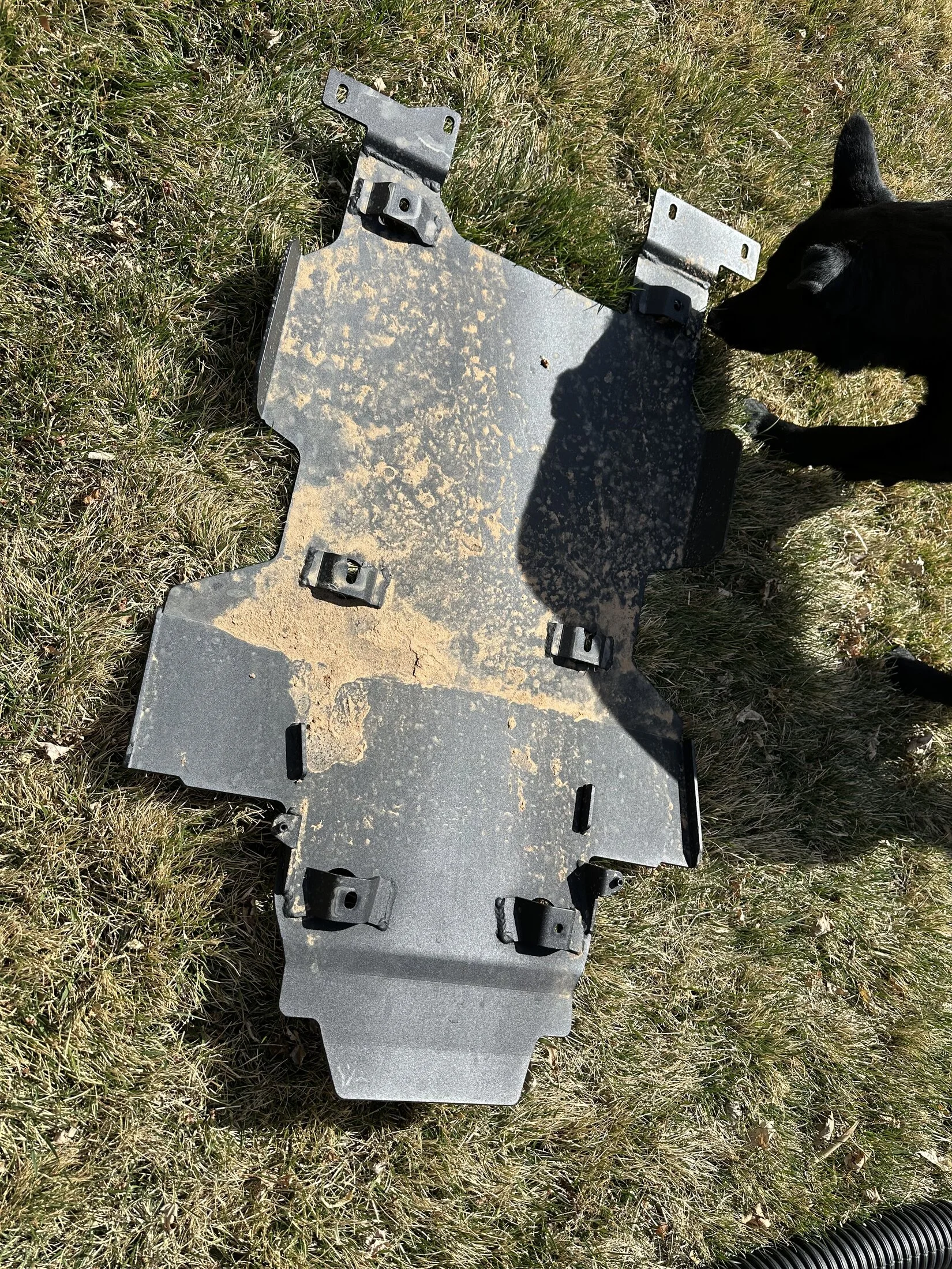

I've had my skid plate off and there was no part number on the back of it unfortunately.

My gut tells me "no", but I don't know for sure. I don't have access to a 600 to test. If anyone in in the Indy area has one, I would be happy to pull the cover off my 700 and test fit it for you.
From my memory of removing mine. It looks like the same mounting points, and rear tabs. Goes to one piece at the front too.
How does the skid plate to the rear of it look?
Or is it completely one piece all the way back? In that case probably looks different.
