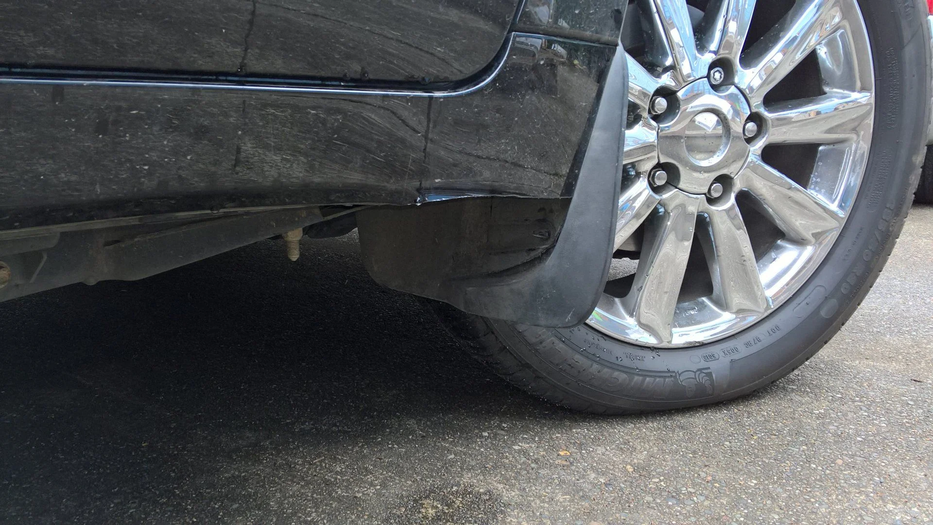

I also recommend taking off the mudflaps and trimming them flush with the bumper. And you can remove the aero flaps under the front. These are all low hanging plastic.

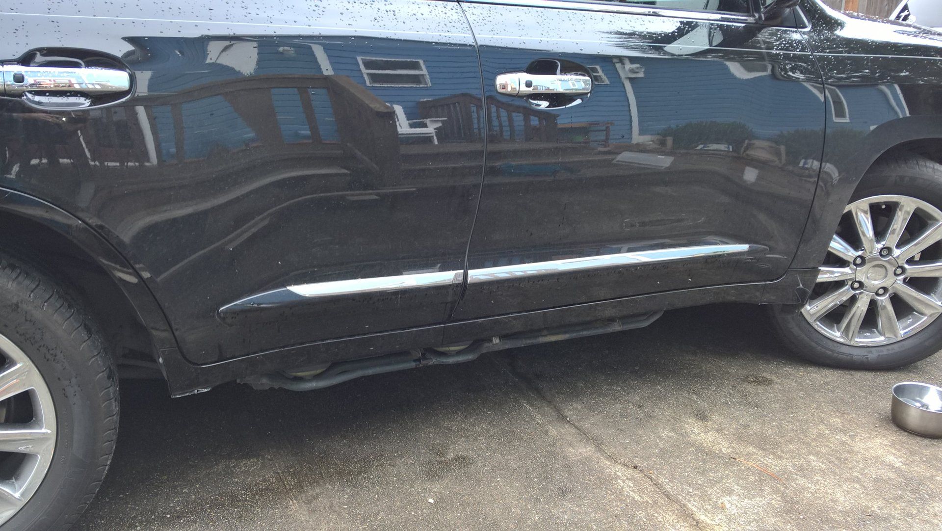

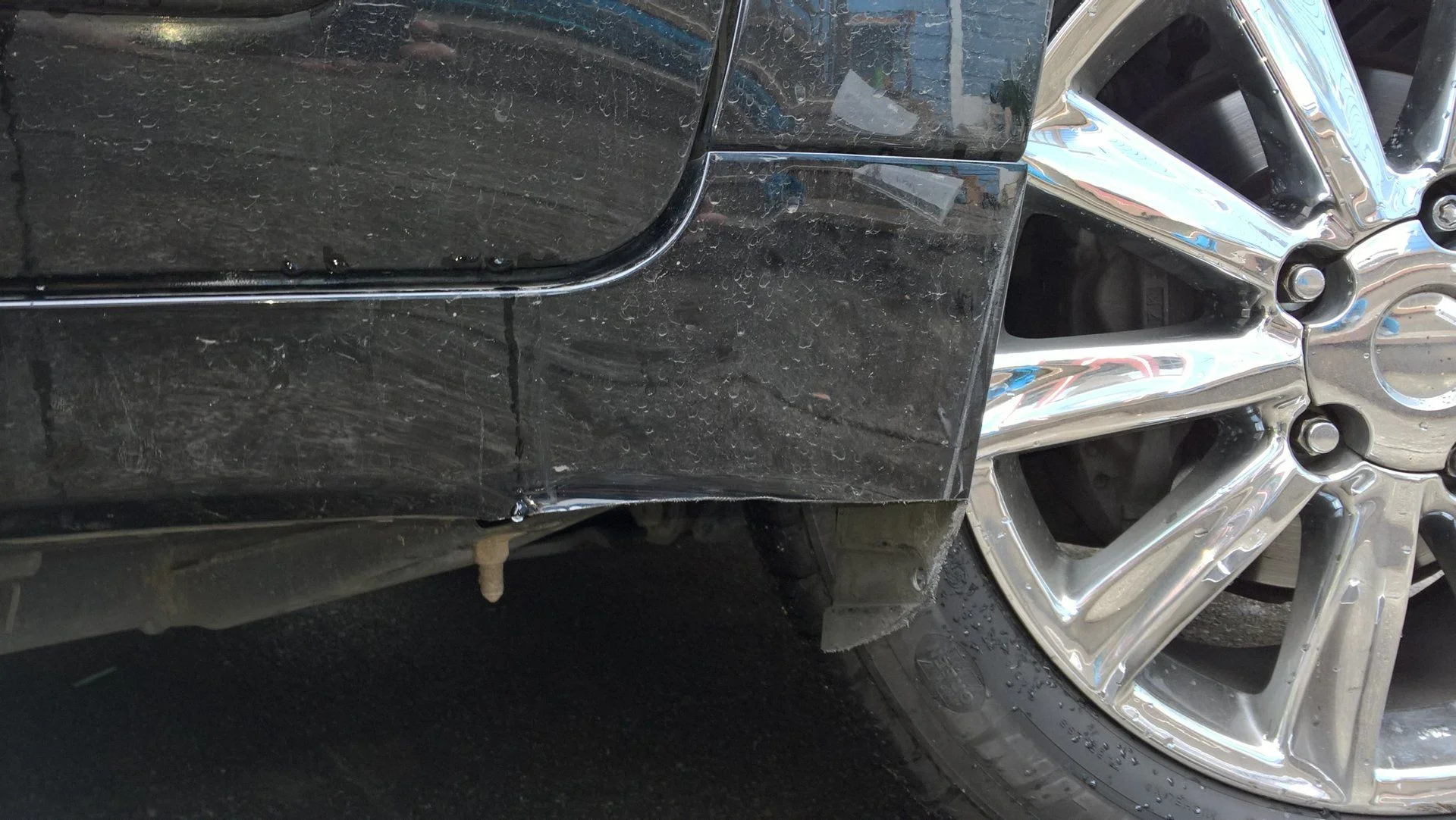

So the plastic is very soft and will cut with any tool really. I used a hand powered coping saw. My blade wasn't tight, so I got a bit squirrelly on the first cut until I realized that. Smooth sailing after. It will pass the three feet test, and if it really bothers me I can superglue the error and sand it. It doesn't. The other easy fix is the put some of the trim on it that people use for bumper trimouts. Anyhow.
I cut the front more straight across then I had taped. It just seems the right thing to do. I kept the part that backs the mudflap, and the mudflap, but that could easily be removed, even on the car.
I would say that unless you were and EXPERT and were looking for it, there is no reason to use the TLC trim piece. Looks fine. I expet the other side where I can apply learning it will look completely perfect.

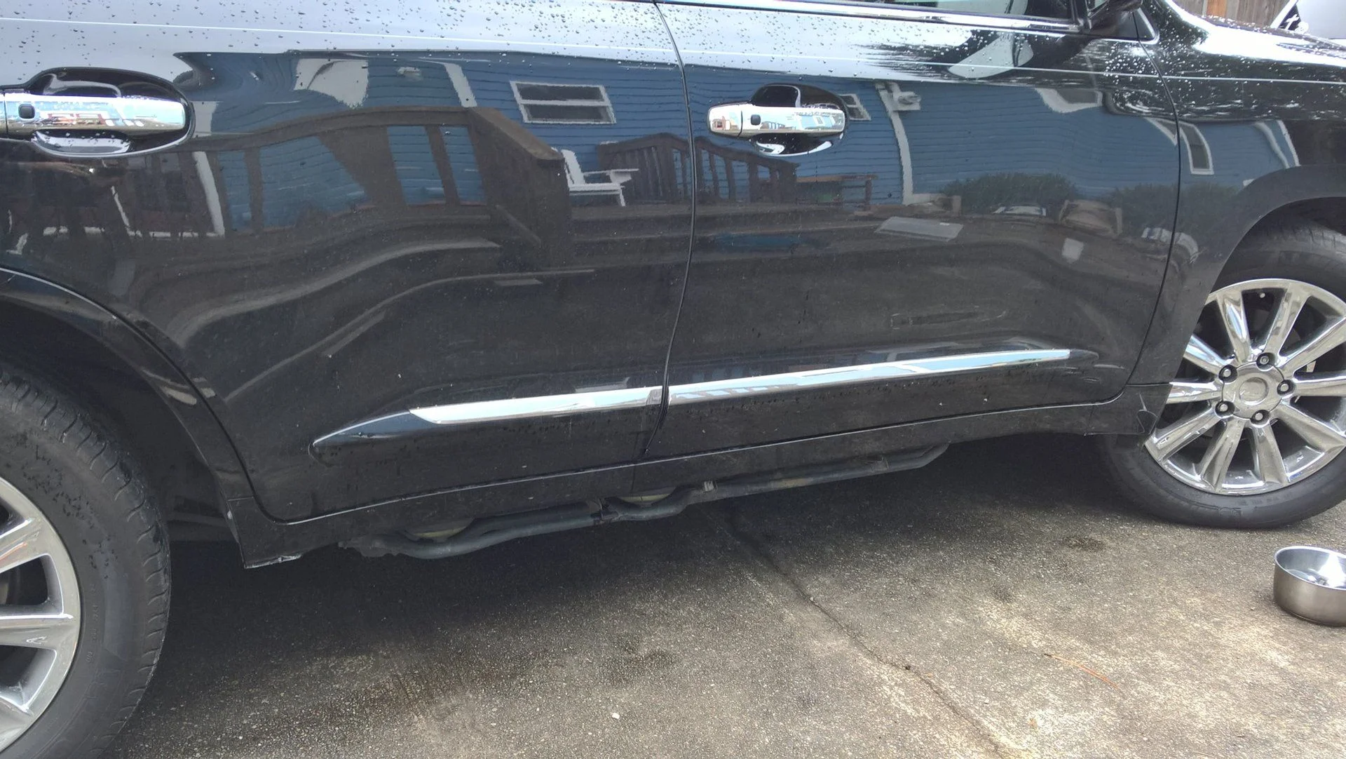

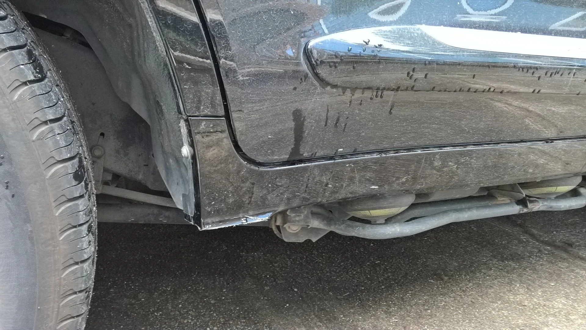

The AHC stuff is fully visible, particularly the AHC slider parts.

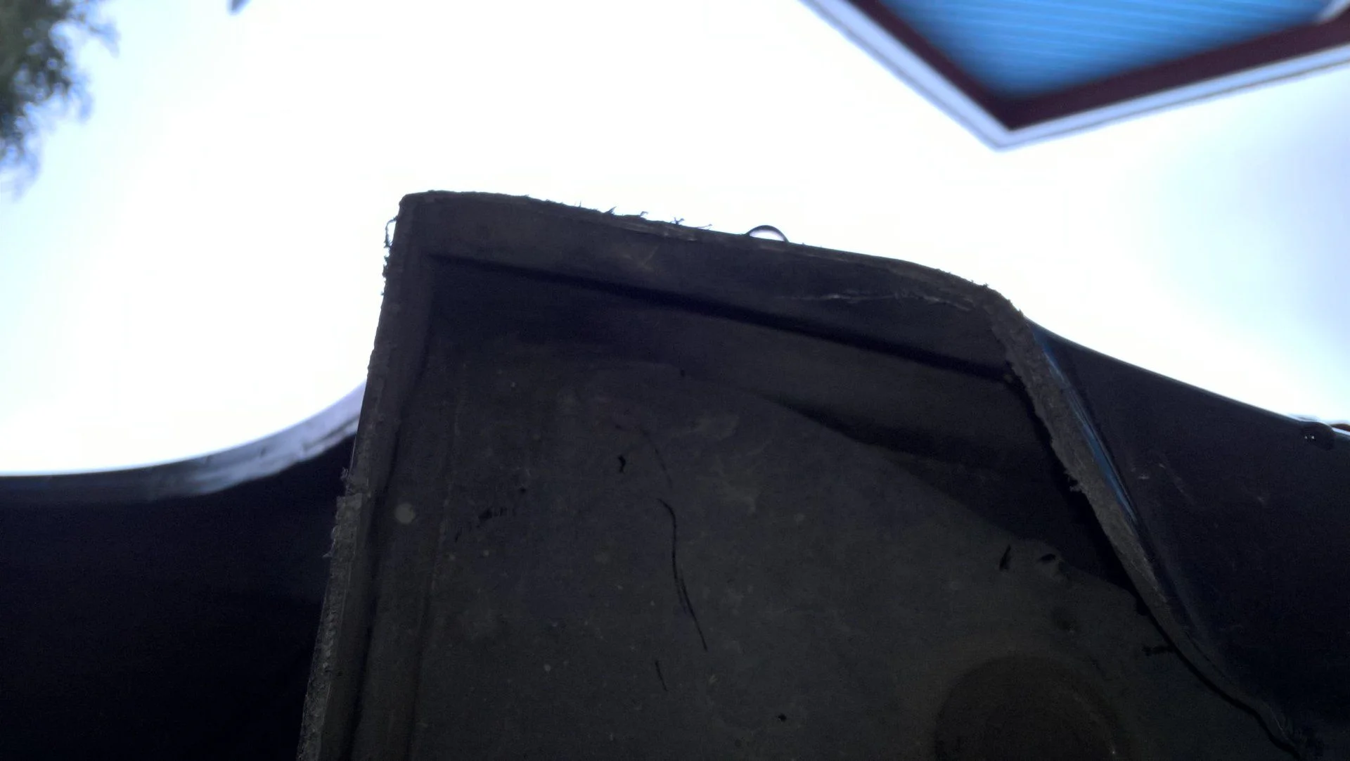

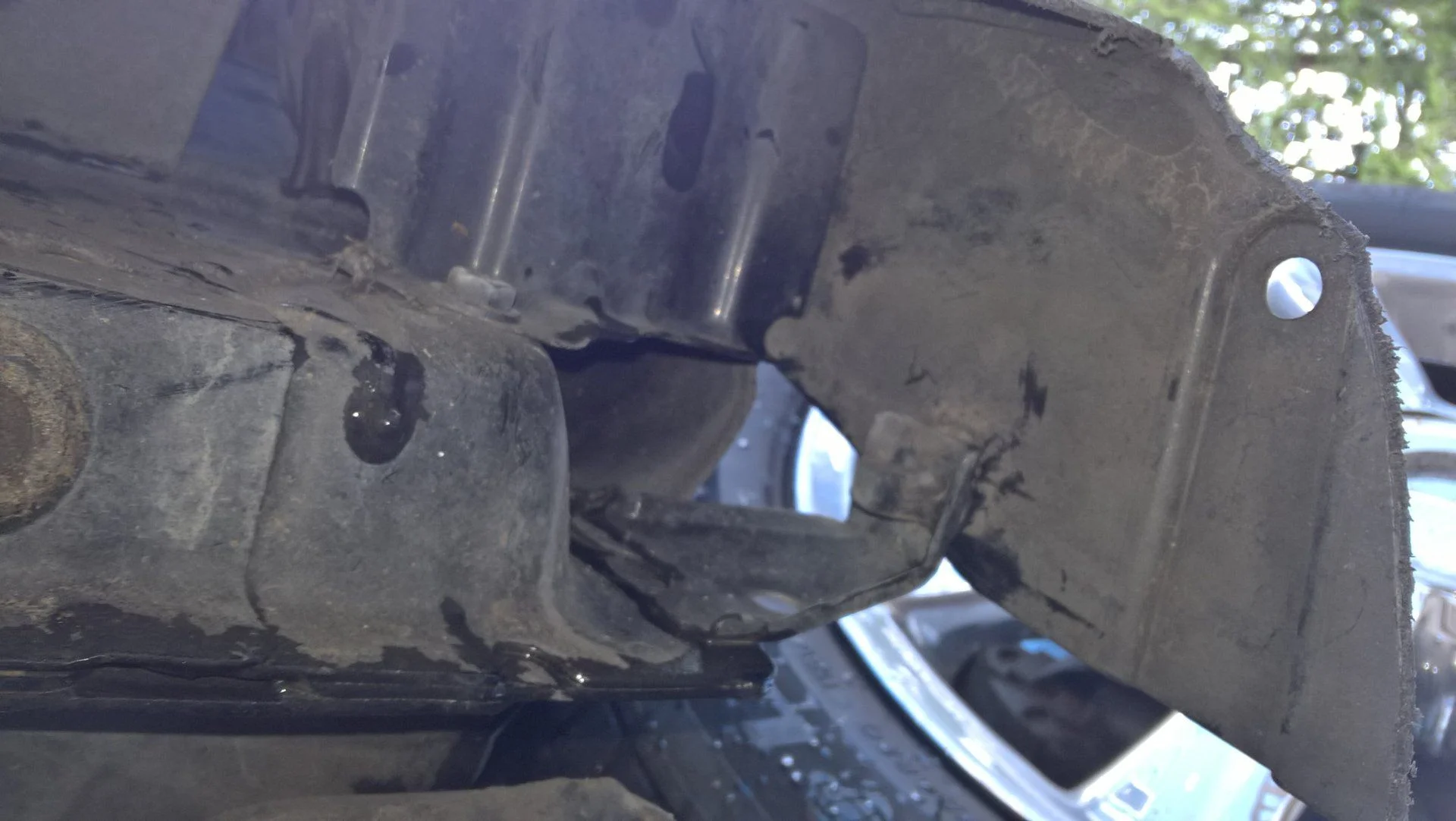

For those that want close ups.It took less than five min to cut, mount, put the flap on, and deburr.
Here's the back
<edit - this is prior to cleaning up with a file >
Here's a full view. and the front after mudlapping.
All the pics are before final filing. I don't have any from later on.
I think I'll try my tin snips on the next pieces, or perhaps the kitchen scissors.
No regrets here. Saved at least $200 per side, and I can't imagine the retail solution provides any significant improvement.

Glad it works out with so little actual cutting involved. For the majority of the rocker (the middle 60" or so) the trim actually curves back perfectly just under the sheet metal. I bet this part of the profile is EXACTLY the same as the TLC piece. It only is different at the ends to incorporate the all in one running board/step.
I think the driver side will be less than an hour all in.

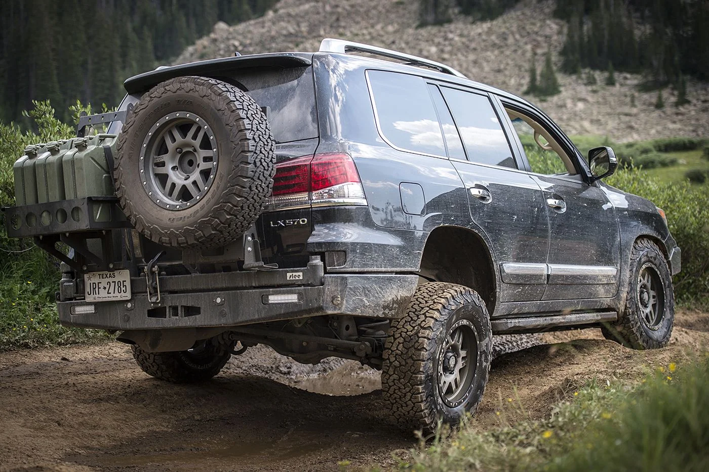

For inspiration, LX570 with sliders. You're getting closer...

So I had a looksee at the AHC bars. They are mounted at five points to the frame, with what look to be 2 bolts at each mount. The mounts take up a fair amount of space each, so I'd agree with the pic, it should not be too much challenge to reuse the holes (and bolts?) on aftermarket heavy slider brackets. The existing brackets are generally narrow and tall - looks like it would fit a flat or box stock solution better than a pipe solution. <edit - went and looked again, there is a 3x3" pad at every mount point except the rear, that one has a rubber hose obscuring it. Also note I'm too lazy to go look at the driver side, so for now I'm assuming it's a mirror of passenger, I'm sure it isn't though>
The AHC accumulators appear to be at lowest point level with the frame, I'd consider losing a 1/4" of clearance and putting some shielding in place for the AHC parts so that they don't get pointy rocked.

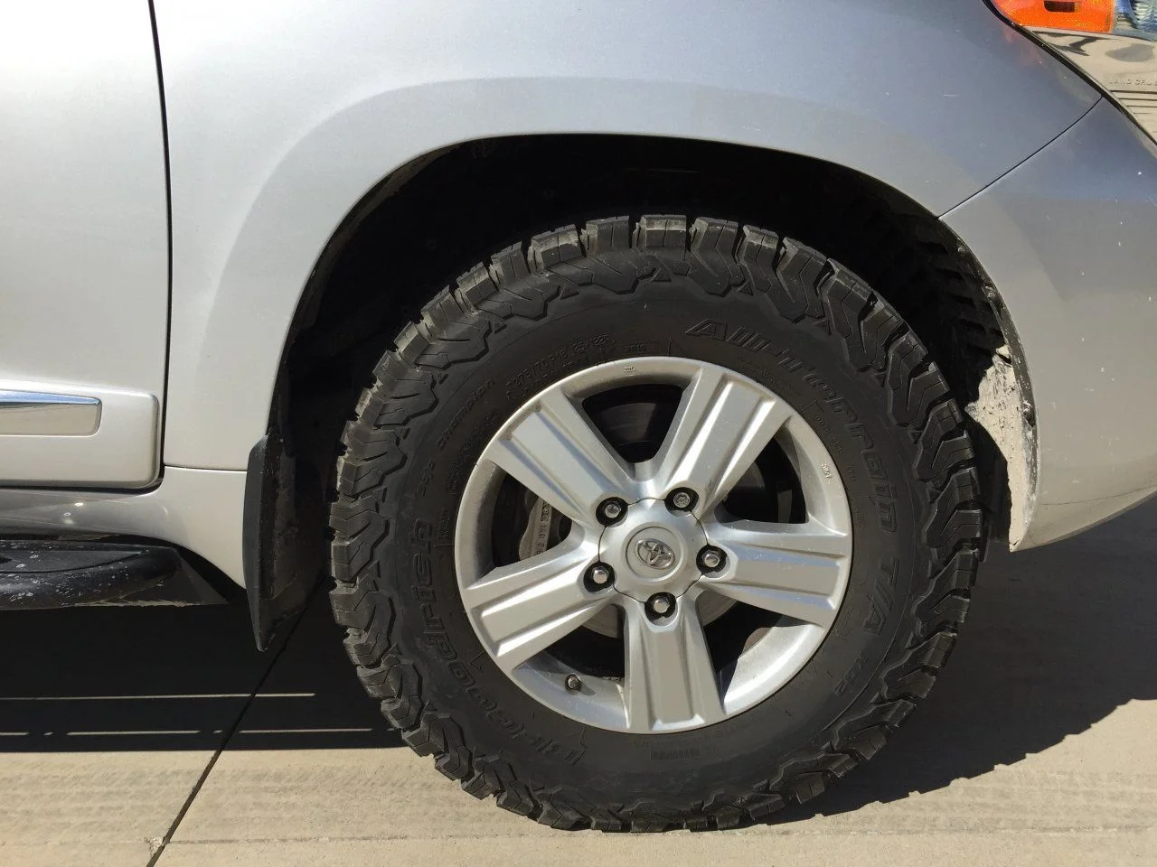

I stole this pic from a will my tire fit thread. Looks like for cutting at the front wheel one could follow the curve in the trim and have it go lower on the mud flap. No need to go horizontal. I was worried about slider clearance there, but obviously if the TLC trim if curving down an off the shelf slider will come in behind or around.
