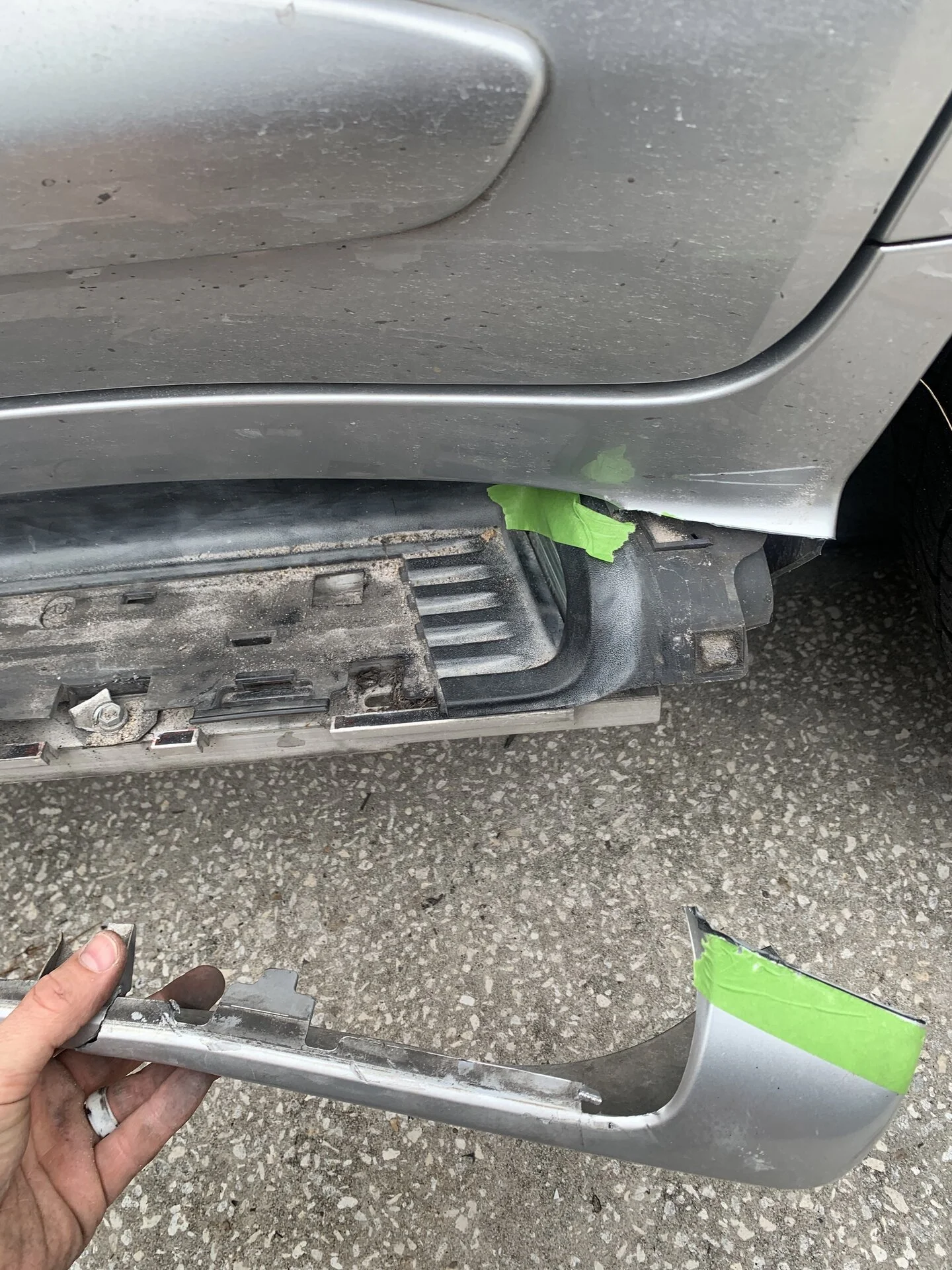

Did mine today. Popped off the plastic grip, broke the black clips holding in the painted tabs, removed the inner black plastic, and finally removed the boards leaving the moulding on. Messed around with a hacksaw/hackzall for a bit but didn't like the results. Ended up using a sturdy box knife with a brand new blade to cut everything. Highly recommend that, made everything easy and gave really clean results. First one took about an hour and the second took 15 minutes.
View attachment 2332870View attachment 2332873

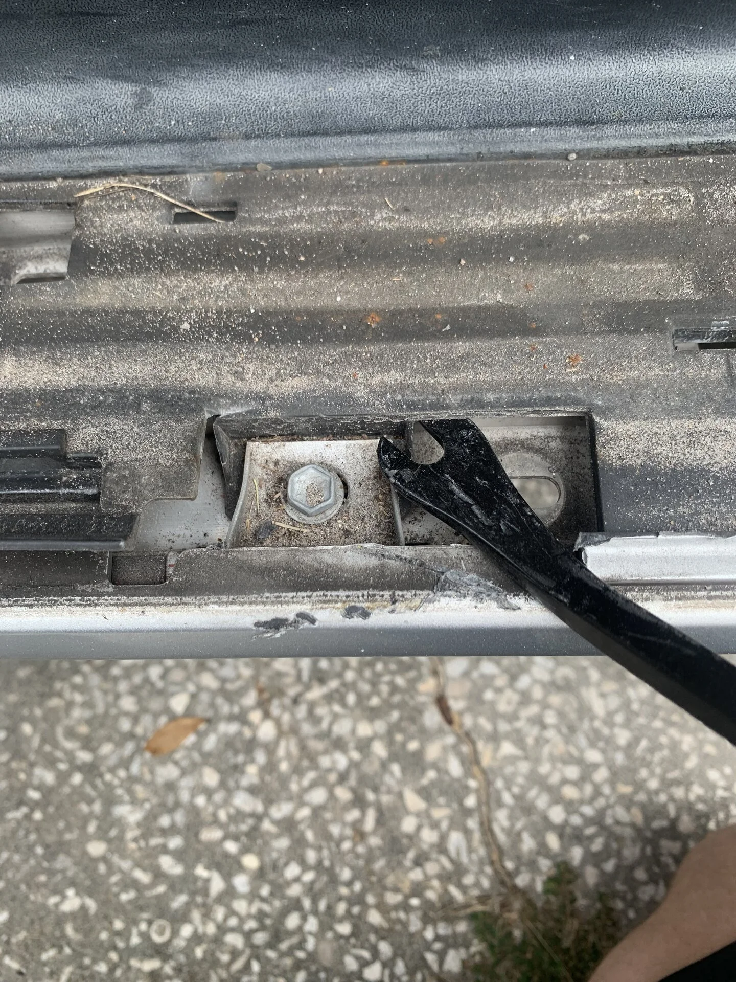

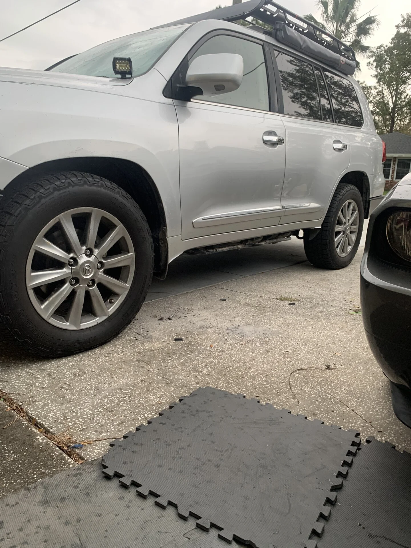

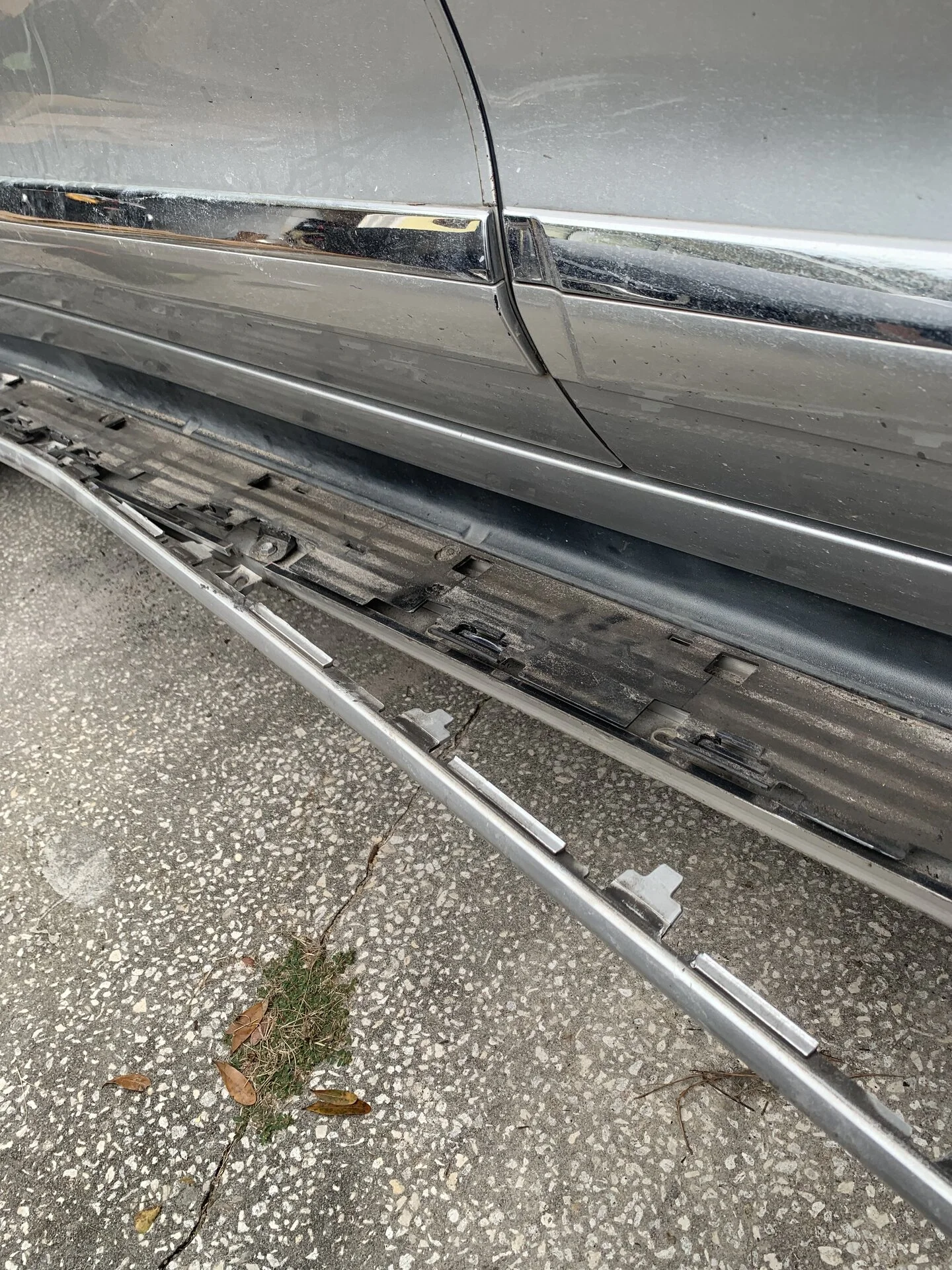

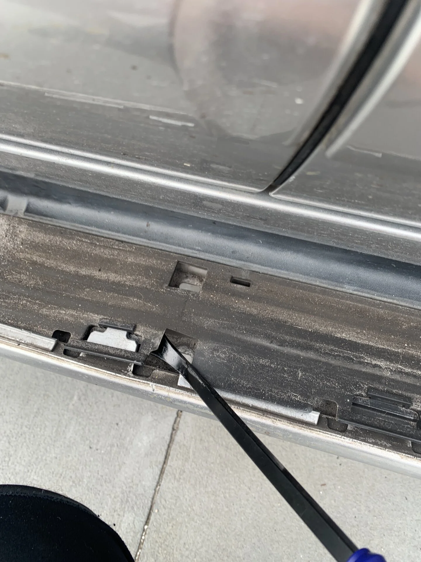

I found this thread very helpful. I took the route of this post and took a couple photos to show what the poster was talking about regarding:
The “plastic grip” is what I’d refer to as a tread plate. It’s plastic and popped off very easily with the trim tool you see in the photos.
I also, due to my inexperience, erred on the very conservative side of how much plastic to cut off…I used a piece of tape to mark where I figured the line should be…then I cut about a quarter inch lower.
I plan to use sanders to form everything around the sliders once they’re installed.

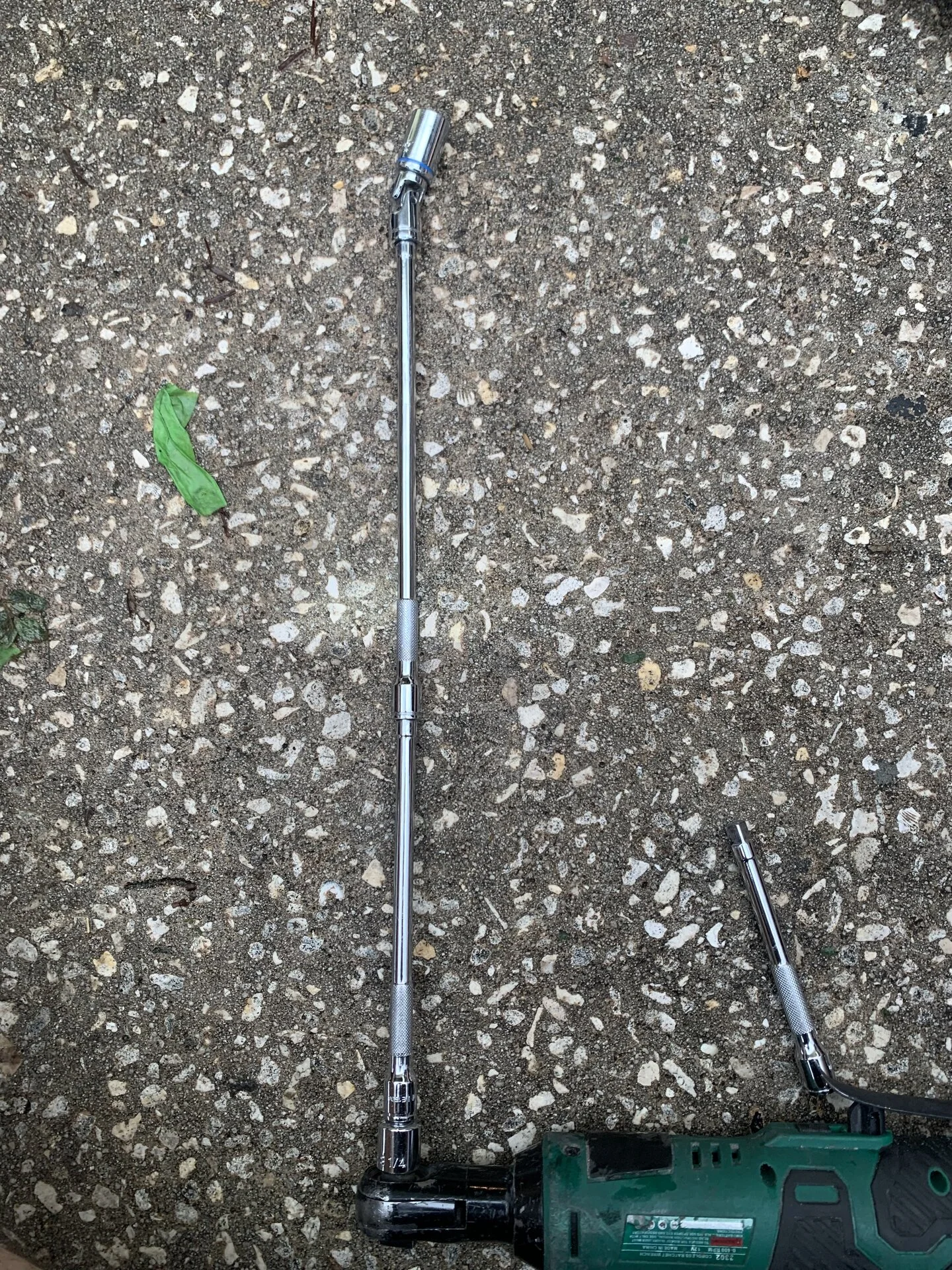

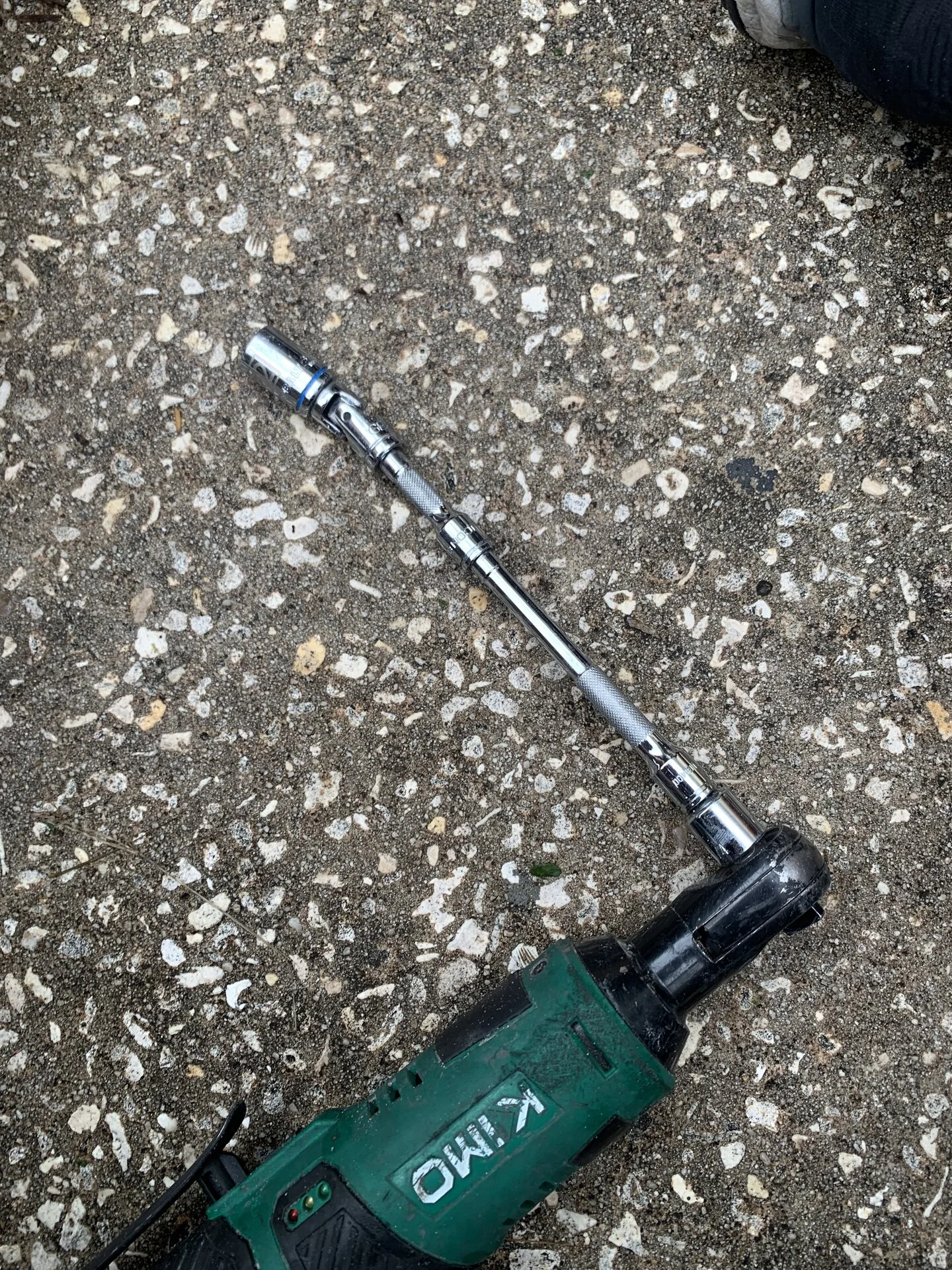

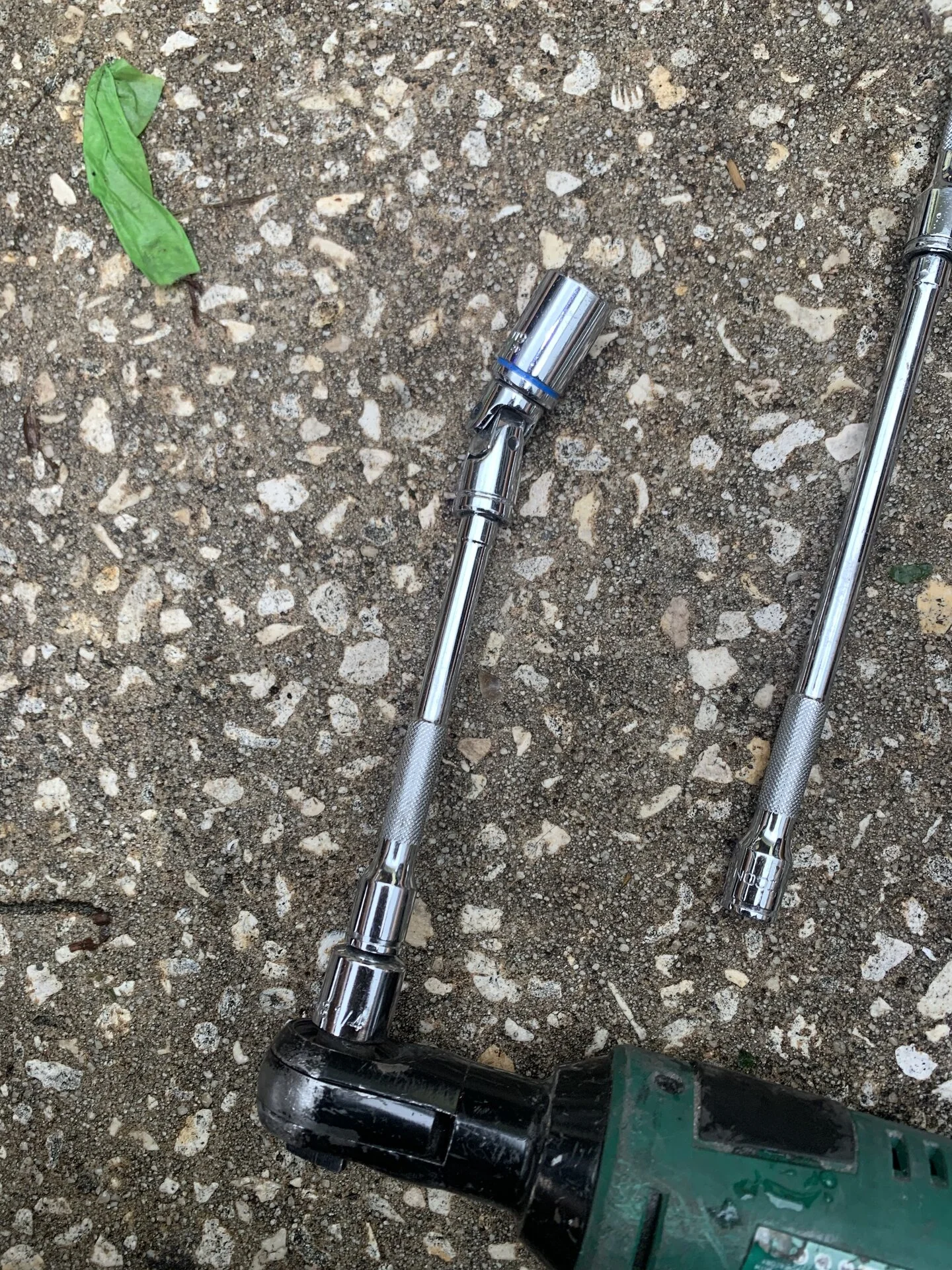

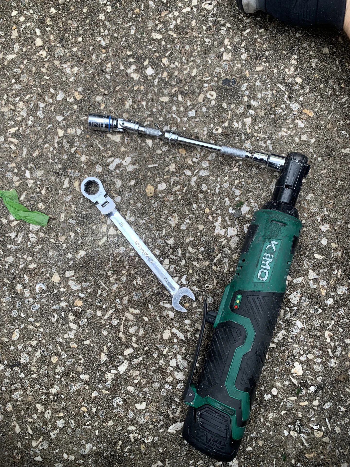

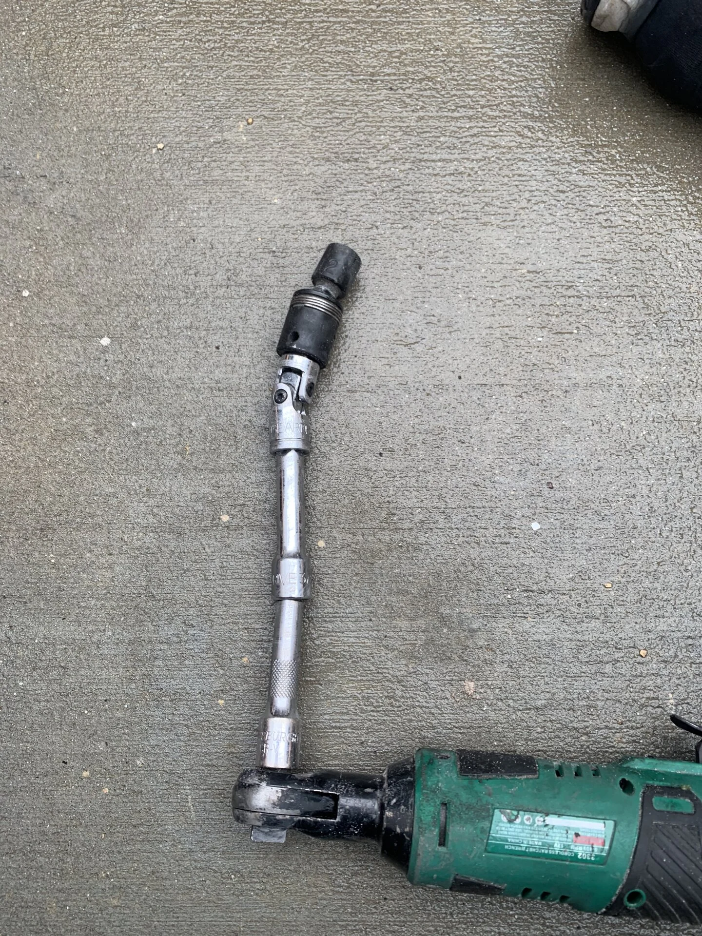

Various combinations of the attached tools seemed necessary to fit sliders. Between the brackets that the sliders bolt to the frame with and the ahc components they squeeze between, there’s very very little room to get your fingers in there to start/tighten bolts

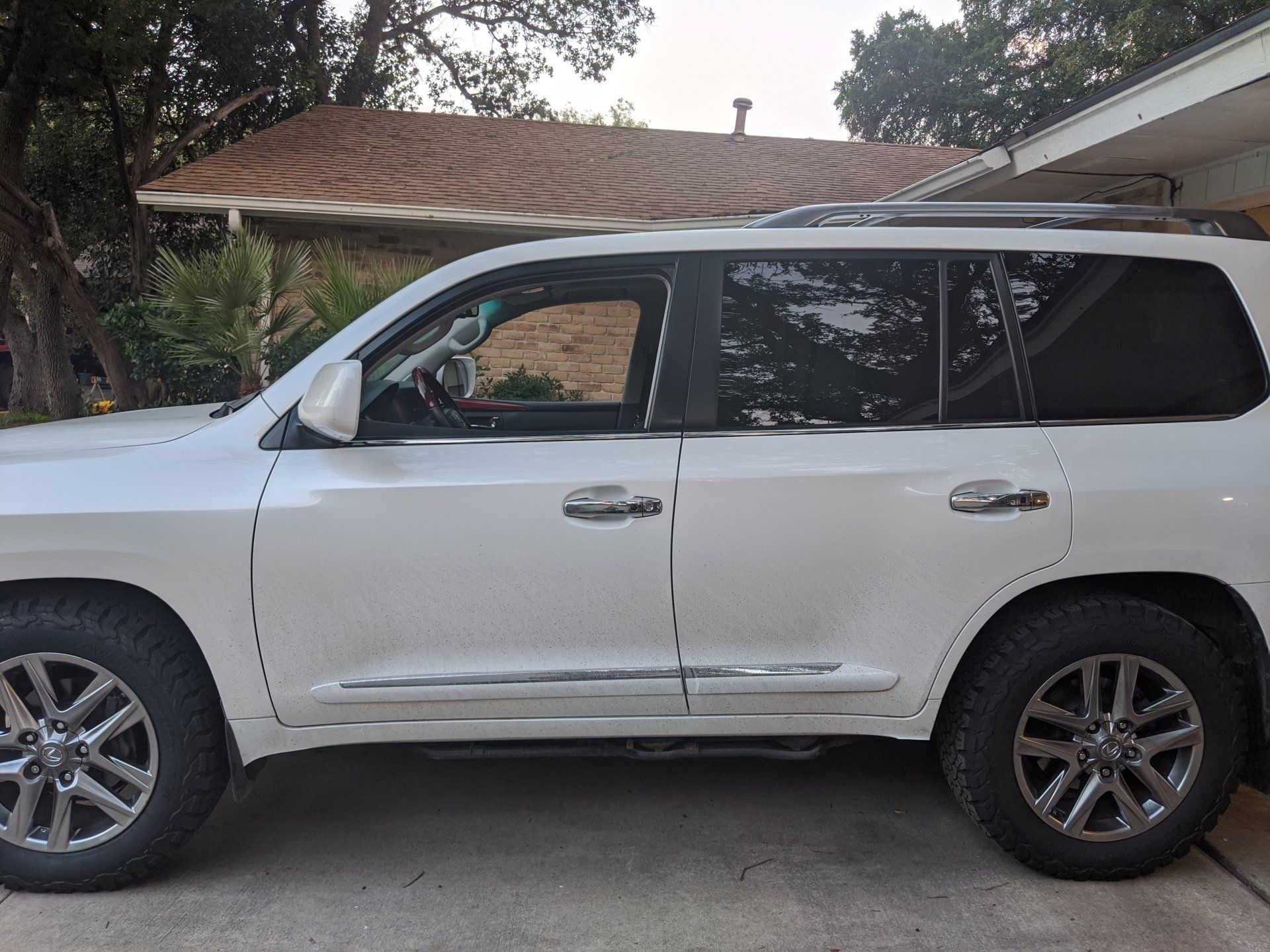

I cut mine and they look alright. She ain't a show vehicle but it suits me.

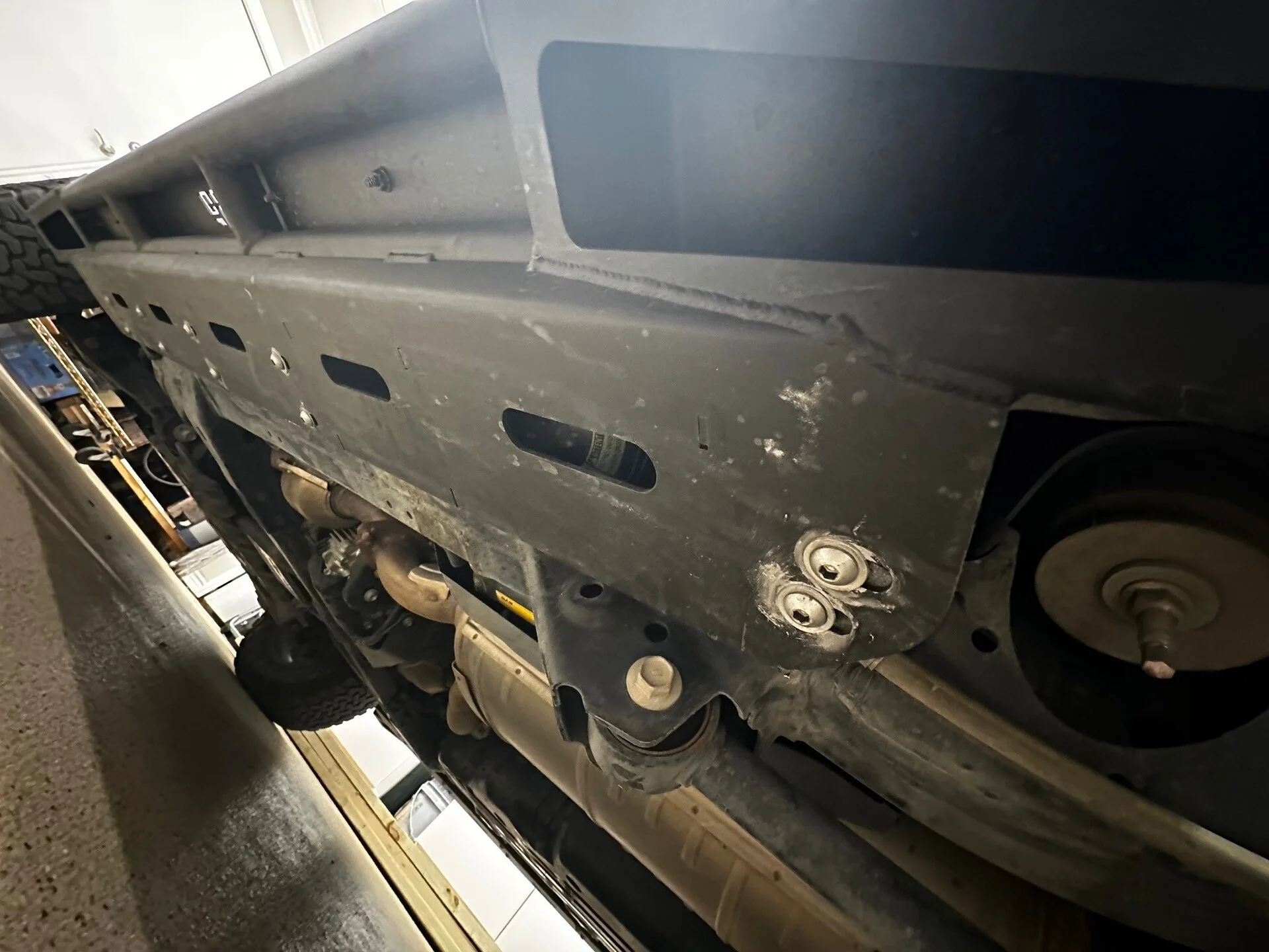

Ended up cutting the running boards when MetalTech 4x4 did the install and it looks awesome.

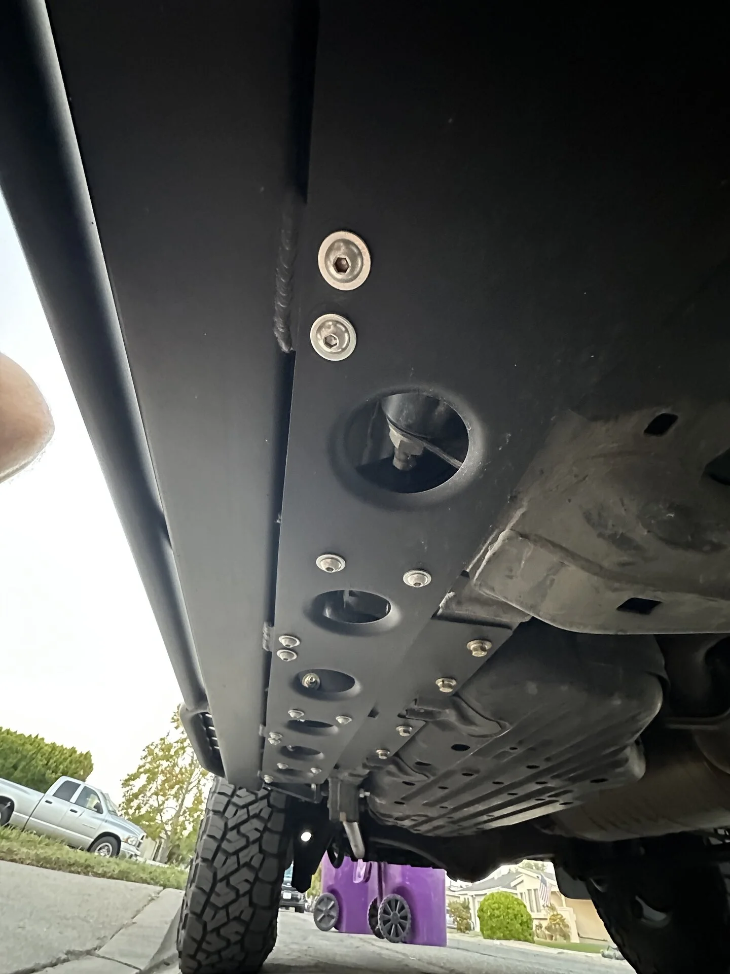

These are the beefiest rock sliders I’ve ever seen — you could hang the truck upside down from these things! Because it uses a plate to attach the frame (which the sliders bolt to), Mark mentioned there’s around 25 points of contact between the sliders and frame, per side. Incredibly well built. Excited to put them to use!

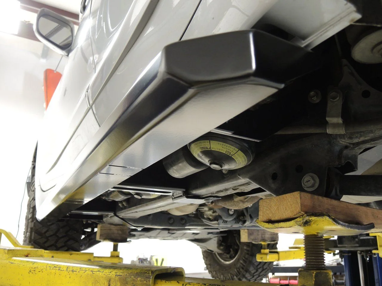

looks like in the photo you have no protection on the AHC?
I installed the CBI Rock Sliders and removed the OEM Steel Bars protecting the AHC.
Possible controversial opinion but IMO the AHC protection is not that important. I have v1 Slee LX sliders that have been on for 6-8 years now and have dragged my truck over rocks, tree roots, stumps, slickrock, mud—everything—and never even come close to having something contact there. These globes are almost 1/4" thick steel. You aren't going to puncture them.

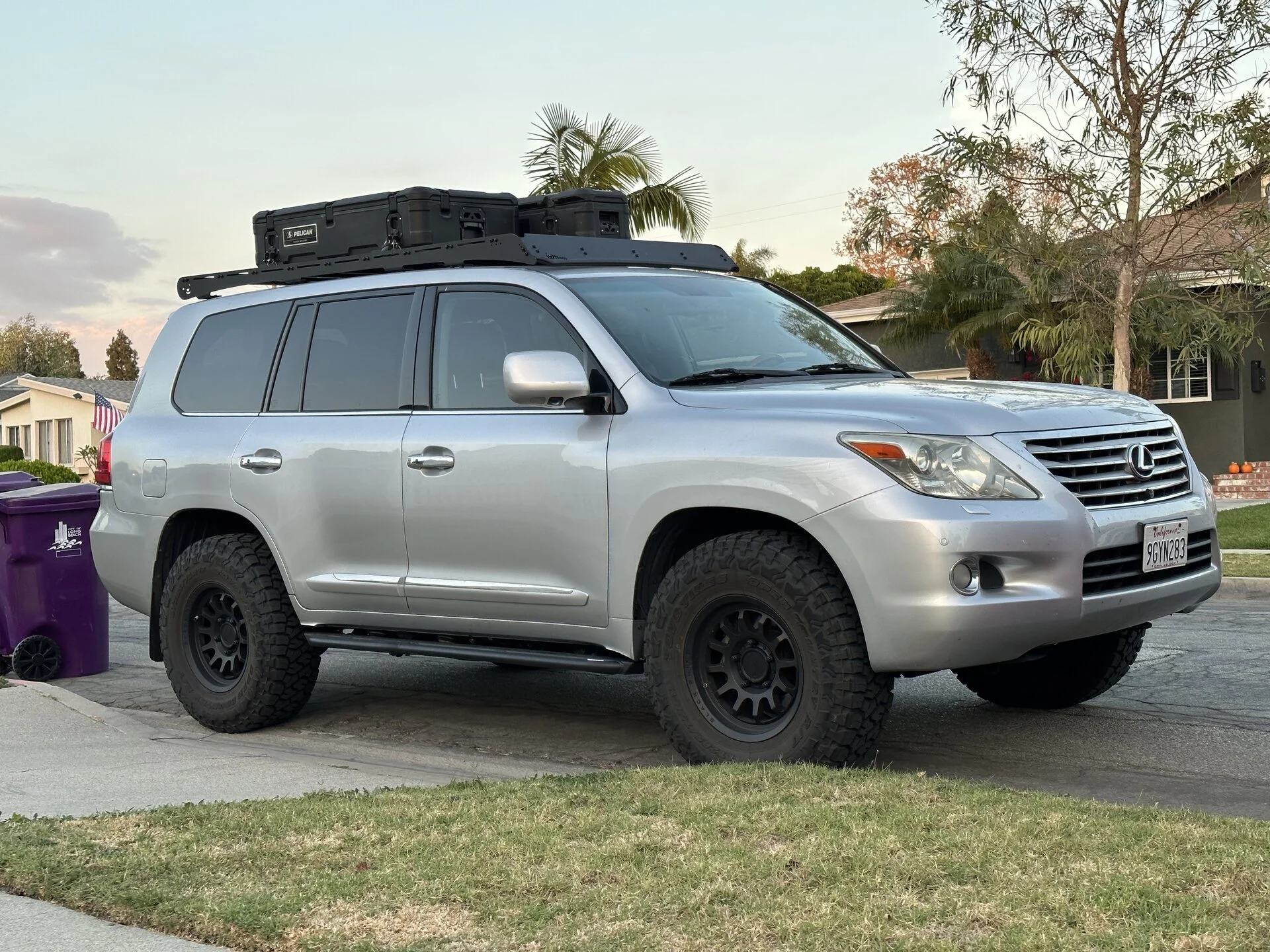

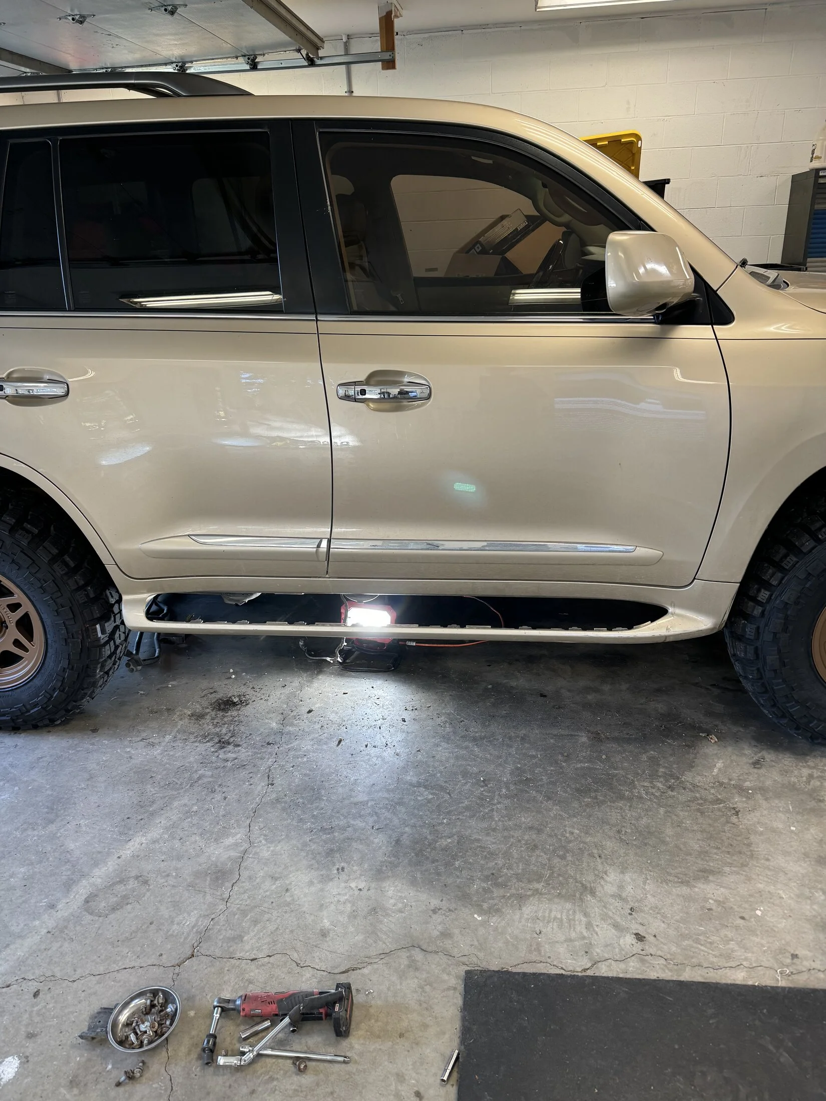

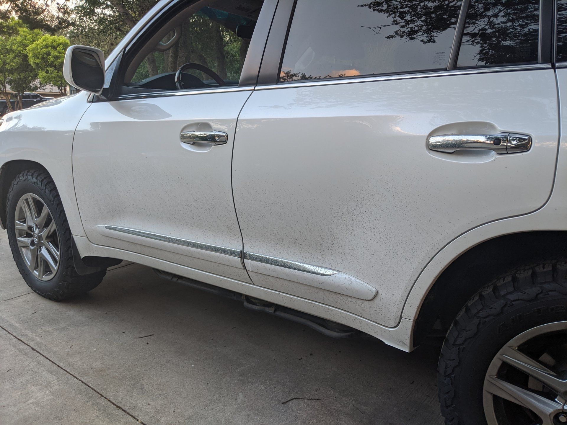

Super easy to do, just unbolt the mounting brackets from the body, use a razor blade to trim the front and rear plastic (6-8" length iirc).
Leave extra material on the vehicle at that point, and when the running boards are off you can then trim it up to where it looks best. In my case I trimmed a little, stepped back to check it, trimmed a little more, and repeated until it looked best to me.
