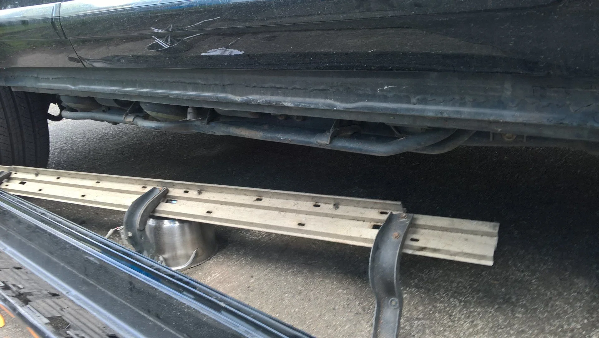

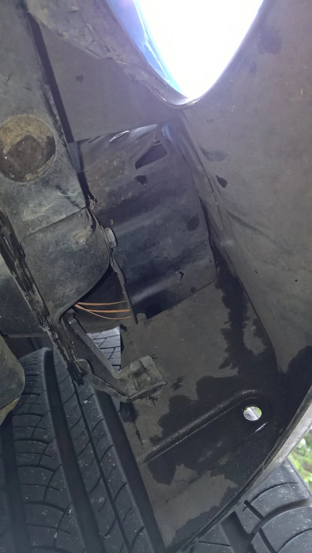

Pic 1 - Where the rivet is located at the toe of the running board. It's there in the FSM too.

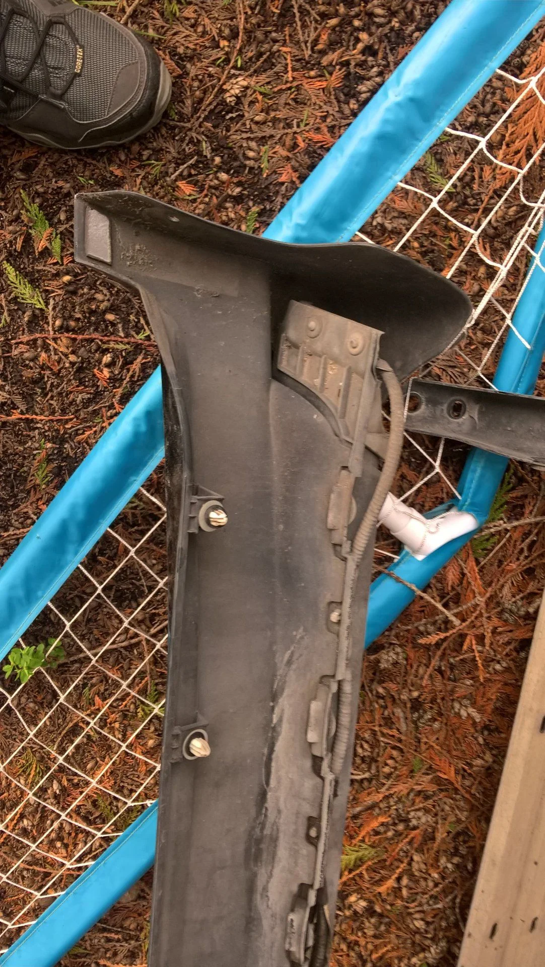

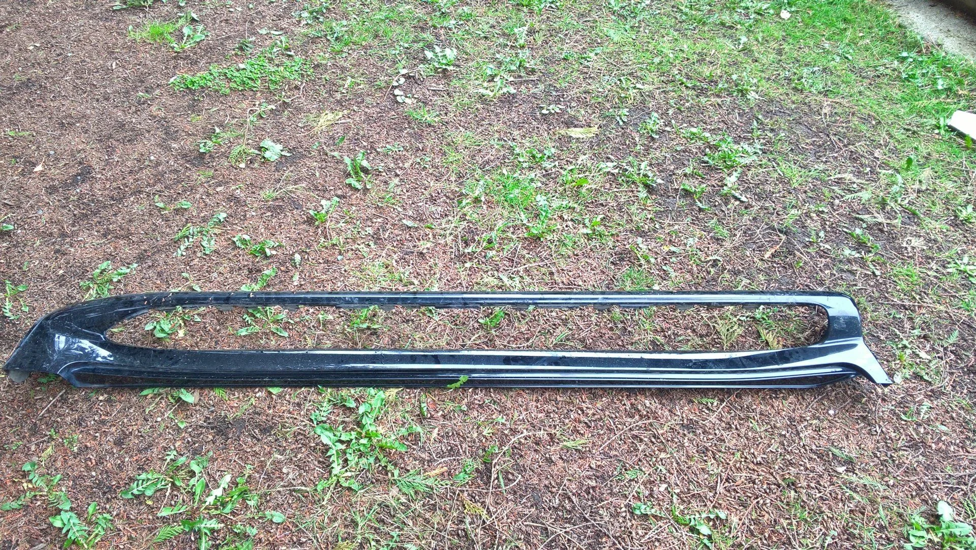

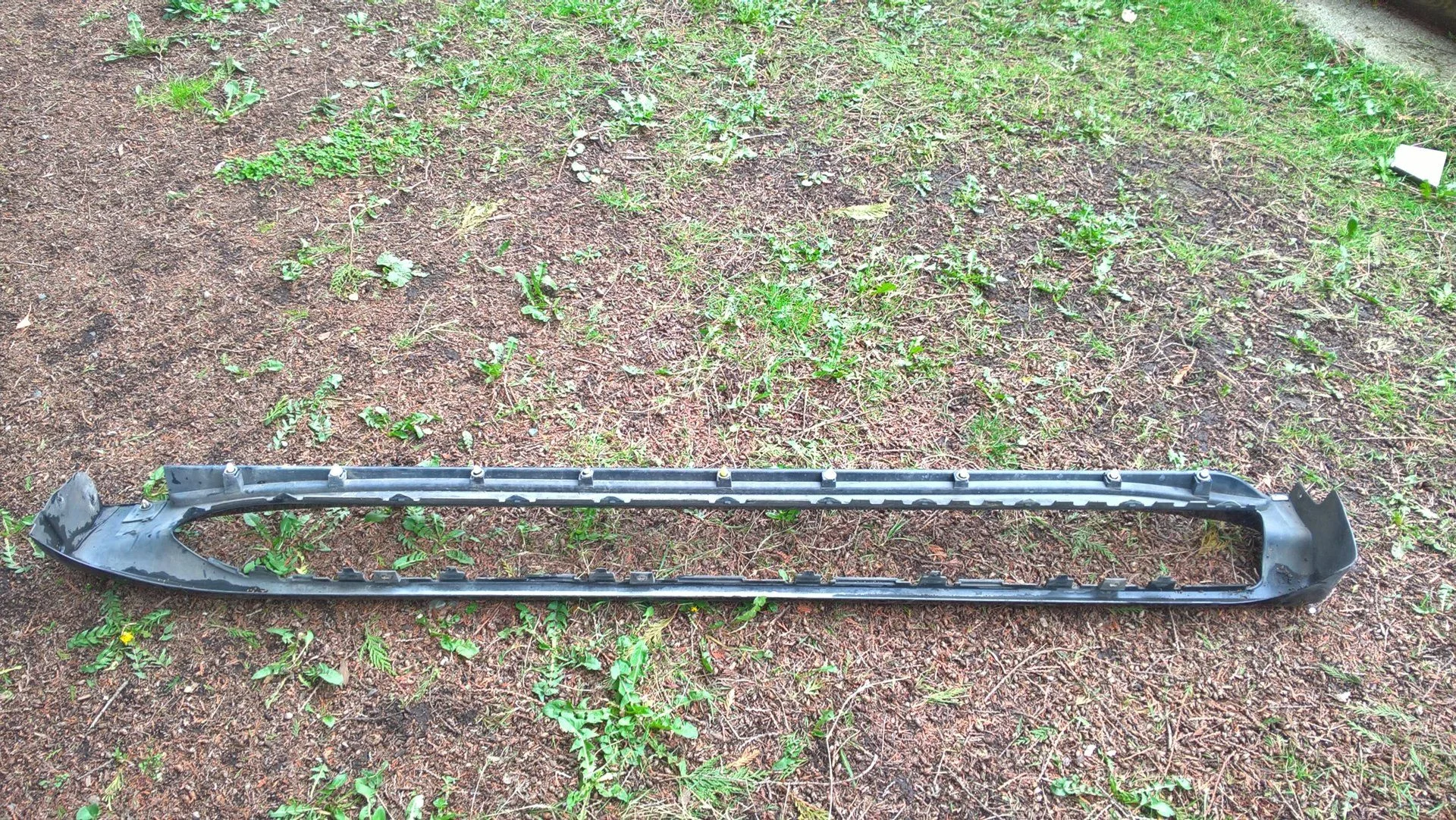

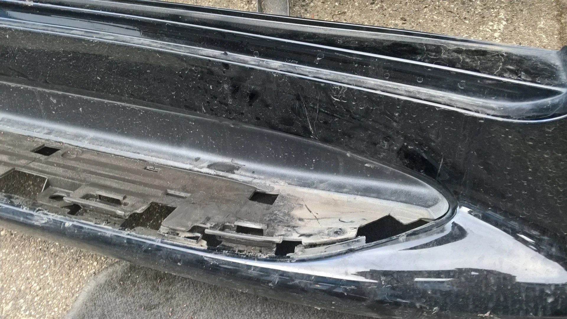

This the back of the shaped plastic fascia piece. I'll call it the 'glossy piece'. It the only piece that needs cutting or will be reused. This piece has a long narrow oval hole in it after the matte L shaped step portions are removed. The only necessary trimming is to follow the molded curve into the wheel wells.
There will be some hollow behind, not sure how to deal with that yet.

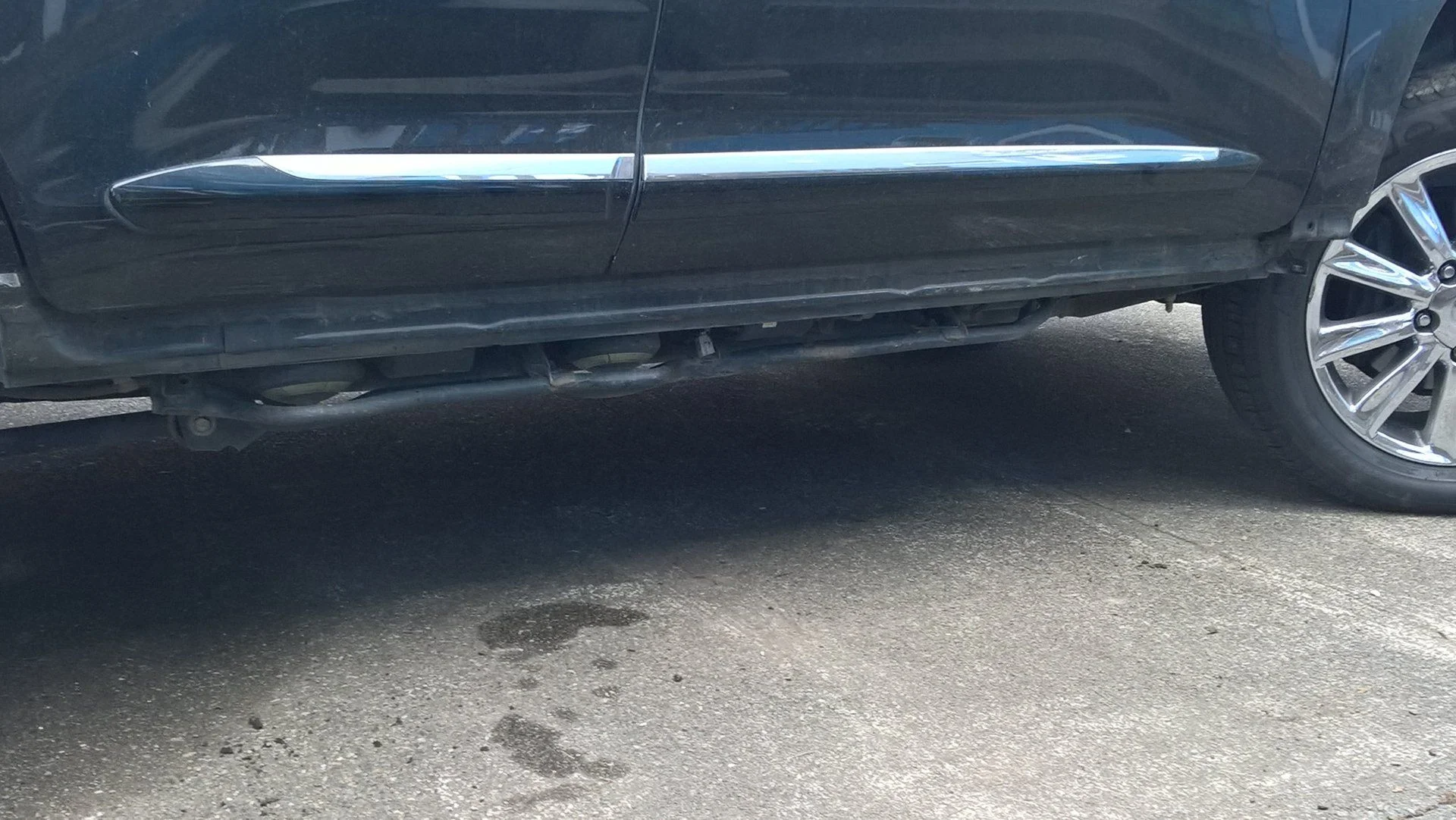

And some glamour shots.
The AHC components are even with the frame members, but below the rocker a good bit.

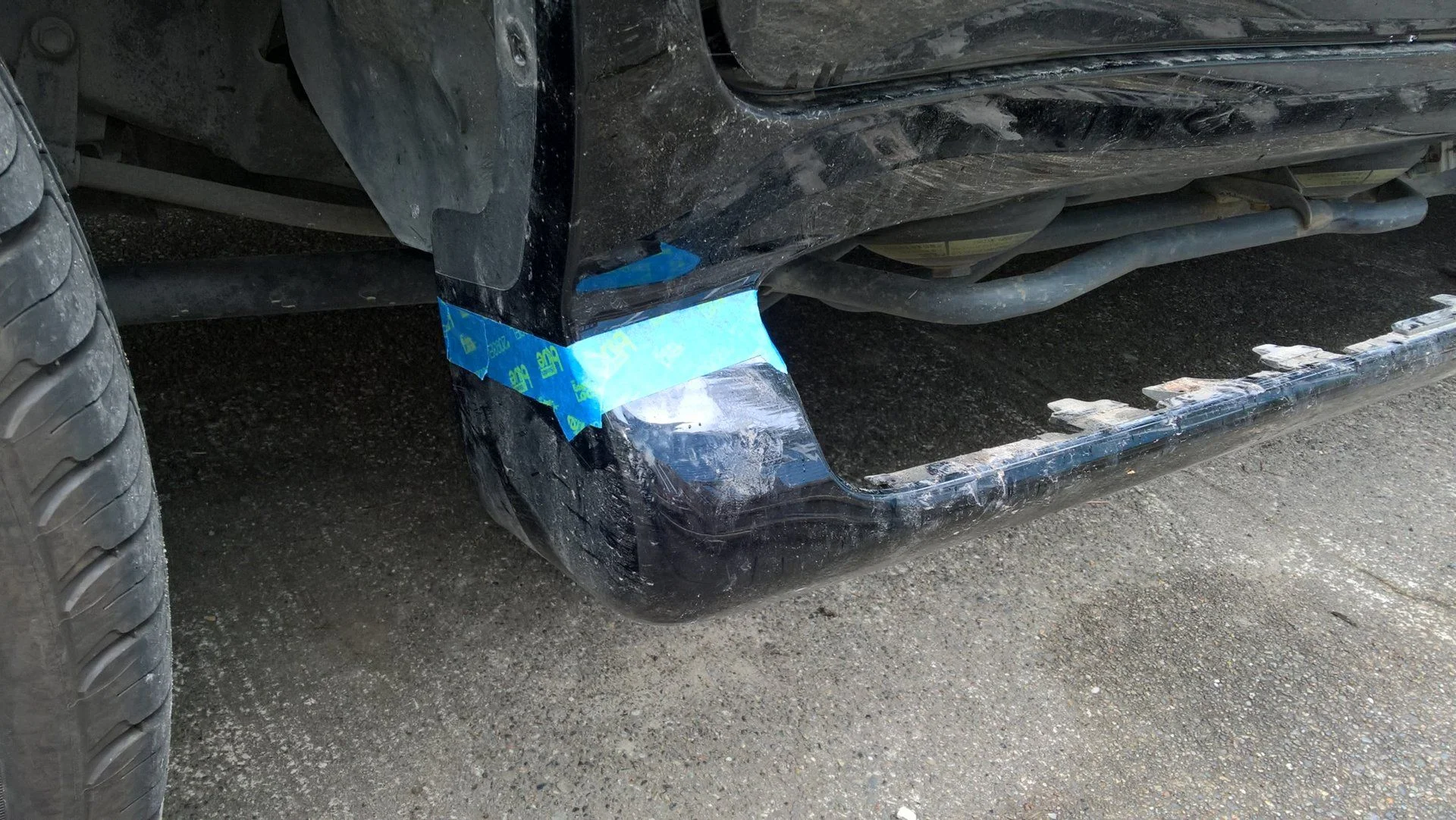

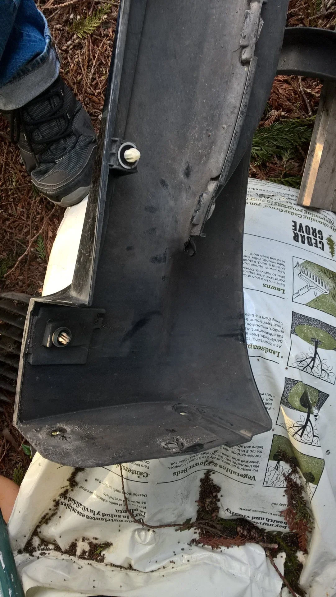

Clipped the trim back on the car and tried to see what made the most sense for cutting. At the rear it is straightforward and will follow the rocker pretty well. At the front it dives down all the way to the bottom of the step . . . there's a mudflap here too - not sure if the TLC has a different mud flap design to complement. Decided to cut it on the curve for now - and expect to have to cut it again when the sliders arrive.
On the plus side, if it was to get crushed, only nylon trim catches are involved, so it won't be damaging the rocker any more than smashing a mud flap can.
