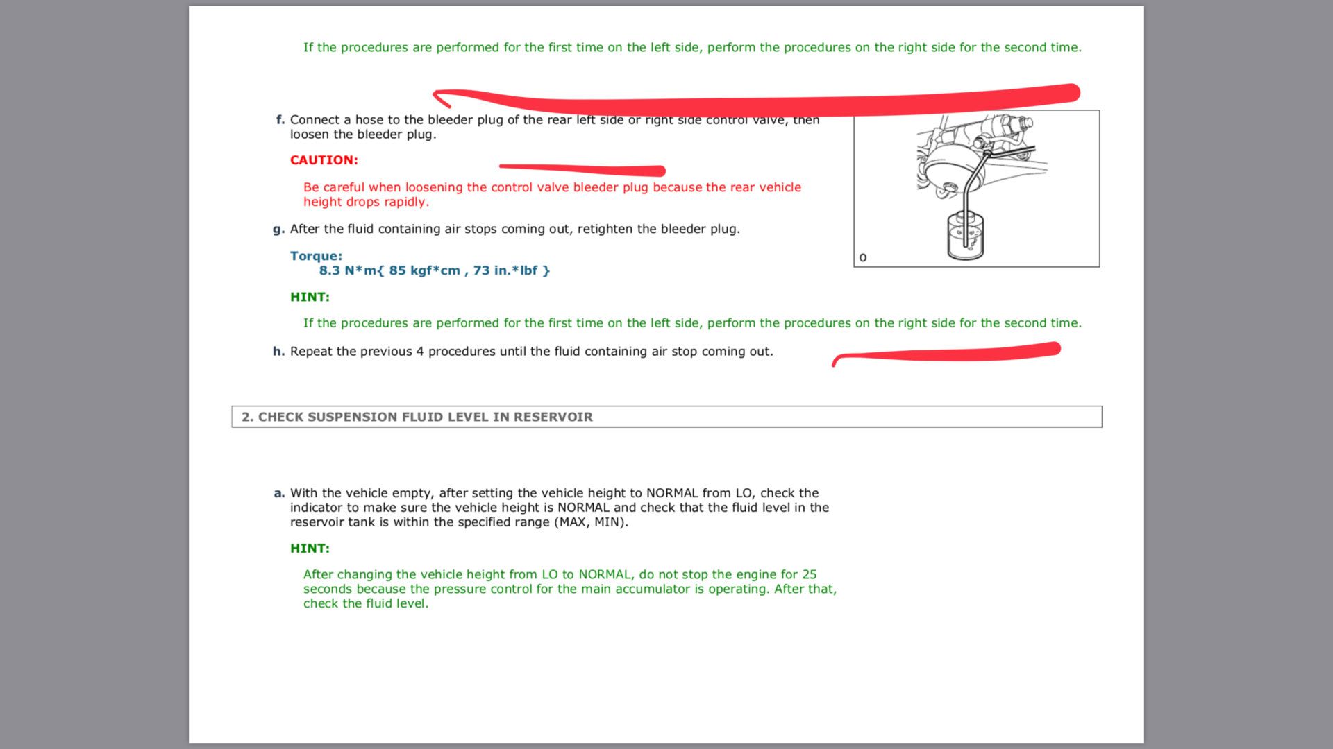

Thanks for uploading again. I’m familiar with this and read several times, and the language concerning “first time” and “second time” is confusing. All told, all four corners are supposed to be bled during a single “full flush” — as well as a fifth bleeder plug somewhere — is that correct?
