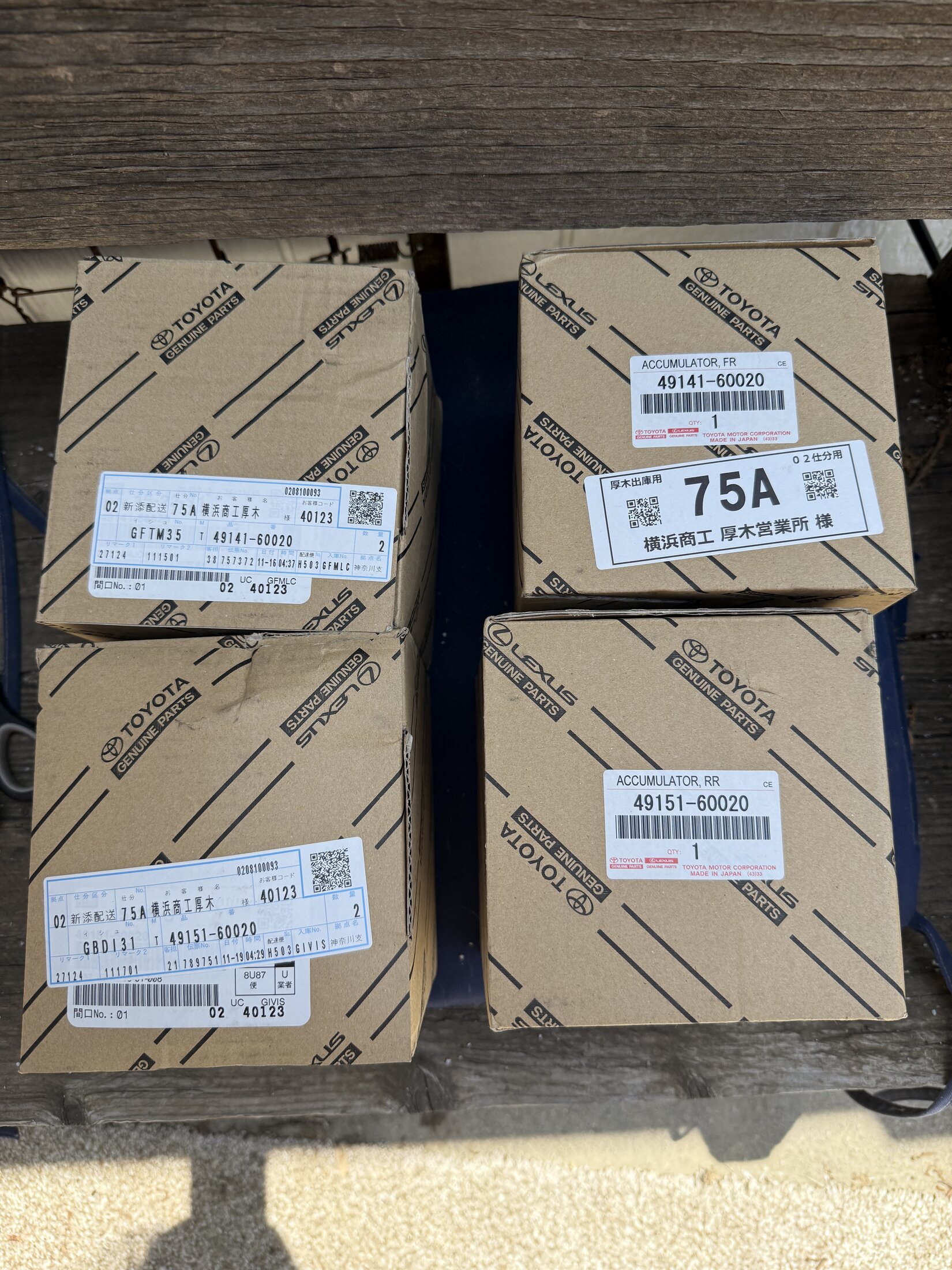

What size tube is needed for the bleeder valves?
And I see there are front and rear globes by these order numbers. Are their a left and right as well?
The fronts are a little higher pressure, but no difference in left or right. The difference is faintly stamped on the globe bodies if you mix them up, as I found out only after installing them wrong. Hose I.d. is 4 mm / 3/16 IRC.
