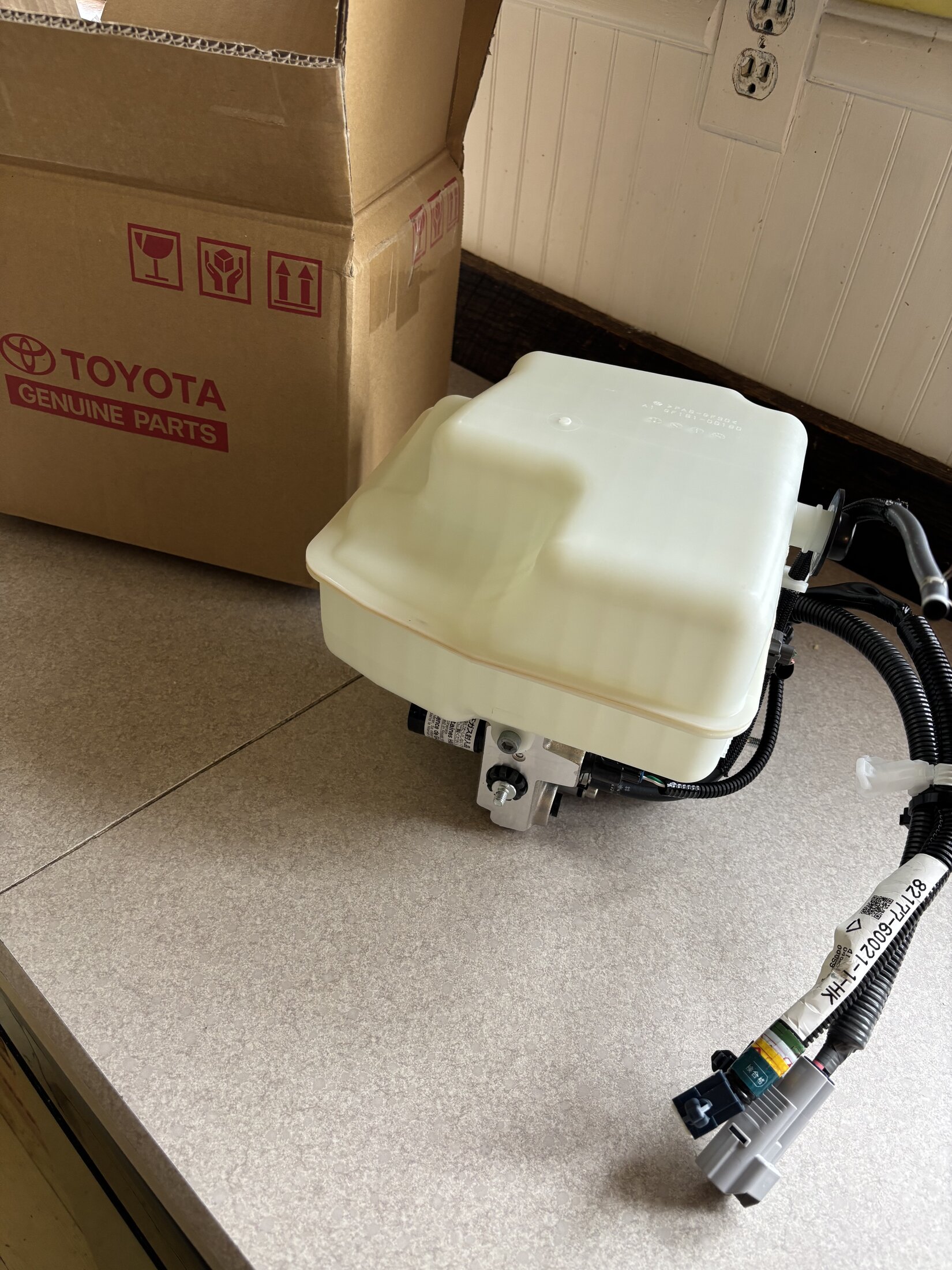

Finally came in!! Now just need some time.
Can you tell me how you primed or otherwise prepared the pump and reservoir? I've got the same part sitting in a box.
I put oil in it on the bench took the plug out and it started dripping out of the pump discharge. Then put 12 power to the pump on the bench and it immediately started pumping. I was very worried about this also but it was super easy. I could not really find anything that had instructions on how to do this.
