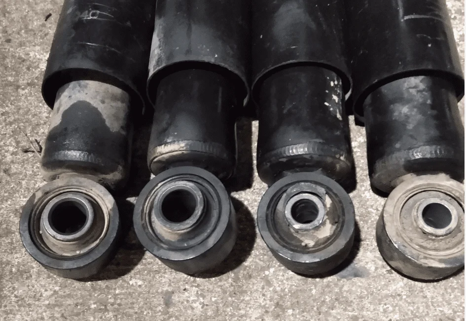

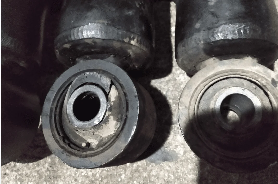

I found my old AHC shocks with worn out bushings at 235,000 miles had become road and tire noise transmitters. There was a noticable amount of noise road reduction that occured after the swap.
I've got those bushings waiting in my parts bin for when I have some spare time and my LX has similar mileage. This is good motivation to get after mine! They're replaceable in car, so I'm hoping that's a cheap and quick fix once I get some time to dedicate to it.
They are replaceable, but it's not at all an easy thing to do.
I've got a ball joint press tool which I hope will help, but I can definitely see that being a bear. I gave it about 2 minutes last time I had the car on the lift and decided I'd do it another day. Felt like I needed 4 hands to hold everything in place. Any tips?
Patience, lots of it. I didn't have a ball joint press, that probably will make things easier. I fought the first one for a long time using pieces of pipe that I had turned down to use as press tools . On the second one it was easier. I heated the spacer tube in the center of the bushing with a torch until it burned itself away from the rubber. Then finished burning out the rubber. After that I used a modified chisel on an air hammer to cut out the sleeve.
Ok cool. Thanks.
I've got the ball joint press, air hammers and the lift so I hope it'll be pretty quick once I dedicate a block of time to it.
Kind of a funny thing to add. When I bought the lower shock bushings from Lexus the fronts were $17 each and the rears were less than 3 bucks a piece.
