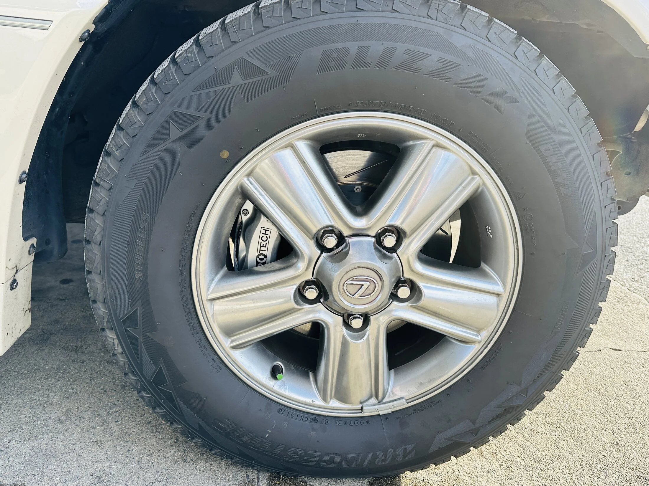

First photo shows the OEM caliper below. Stoptech calipers for the 100 series have 42mm and 44mm pistons. Calipers are a tad thinner than OEM. I’m running 2006 18 in wheels. The OEM calipers had maybe 1/8 in clearance. Stoptech calipers have around 1/4 in clearance. I go mine in the classified ads on this forum from bjowett for a great deal. Otherwise the kits are like $2.5-3.5k

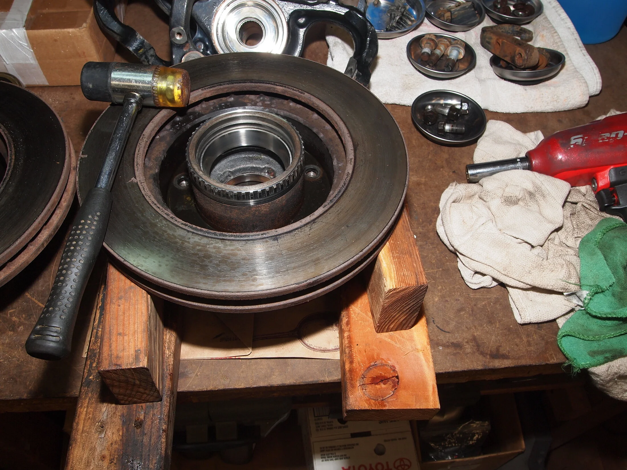

Separating rotor from hub.
ATF works much better than PB blaster. I scrape and power washer hub. Then, before taking out rotor bolts. Pour some AFT, in rotor hat/hub. Place rotor/hub assembly in a catch basin overnight.
Place rotor on wooden blocks, suspending wheel hub. Using a dead blow hammer, pound out hub from rotor. Dead blow hammer, works much better than plastic shown here. Just never use steel hammer or even forged brass, they is to hard and will damage hub.

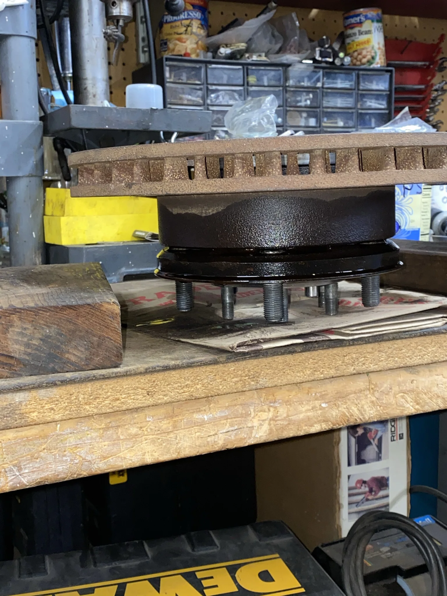

Pound hub out with dead blow or lead hammer.
I used one of the wheels turned upside down to work on the hub/rotor when torquing the rotor bolts. I also use a 2x4 block and hammer to seat the oil seal for the inner bearing after a repack.

Will 17”wheels fit with the larger rotors? I am super heavy and bigger brakes would be nice.

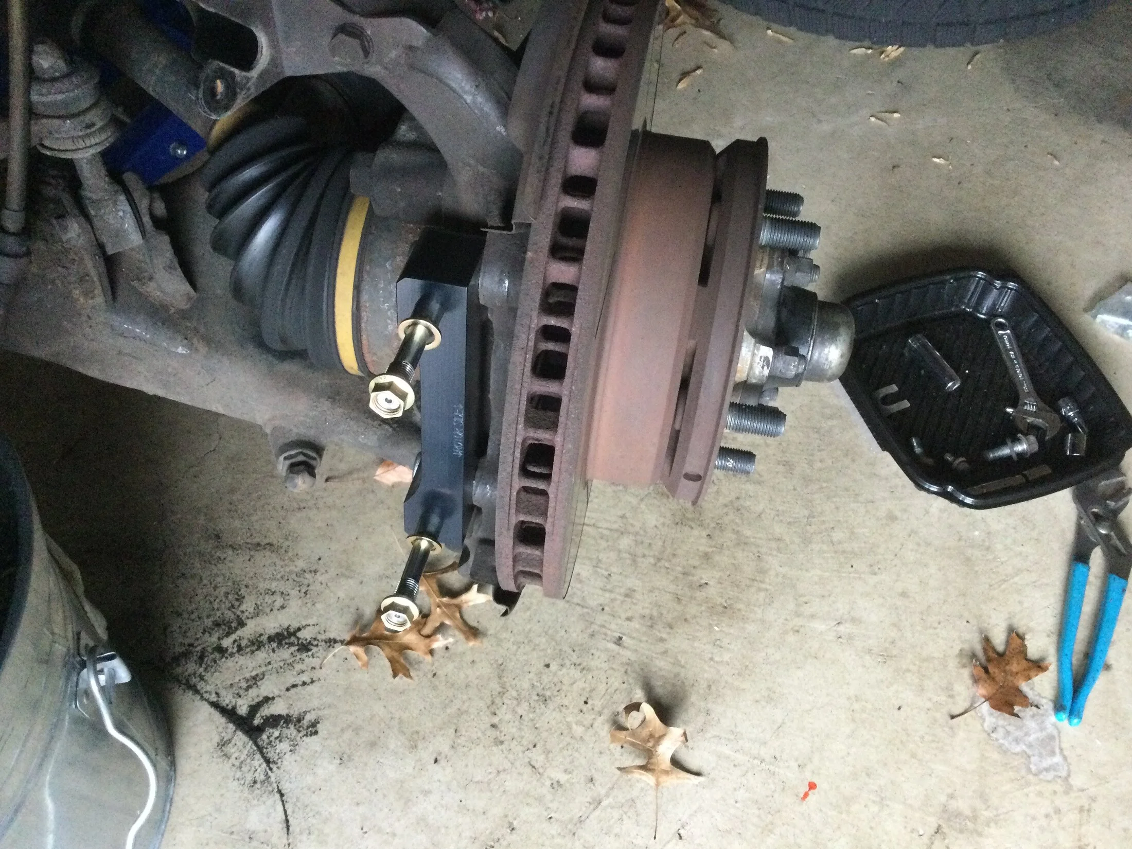

Can you share more info on the product itself, links? Also do you have additional pictures of the spindle bracket to the BBK calipers? Thank you.
Bracket appear to be CNC machined and anodized aluminum. There are two 10mm Allen head bolts that attach the bracket to the vehicle at 90 ft-lbs torque. The heads of the allen bolts are countersunk into the bracket so they are just about flush when tightened. As you can see, the face of the adapter that faces outward is flush with where the OEM caliper would attach. Seems to me any competent machinist could fabricate adapters for just about any calipers you choose as long as they clear the inside of the wheel. There is an article by Stoptech that shows they test all kinds of caliper/rotor combinations on the vehicles to ensure proper front/rear bias. One shouldn’t just install the largest calipers/rotors possible since this may result in inadequate rear braking. The ST40 calipers fit standard Porsche 911 turbo pads. The Porterfield R4s pads come with a metal backing plate attached, but I added a shim and put disc brake grease on the side facing the backing of the pad. For these calipers, I could only find titanium shims, so figure $100 for those.
Hard to tell from the pics - will the factory 16" LX / LC wheels fit over these stoptech brakes? Looks like a.... no
