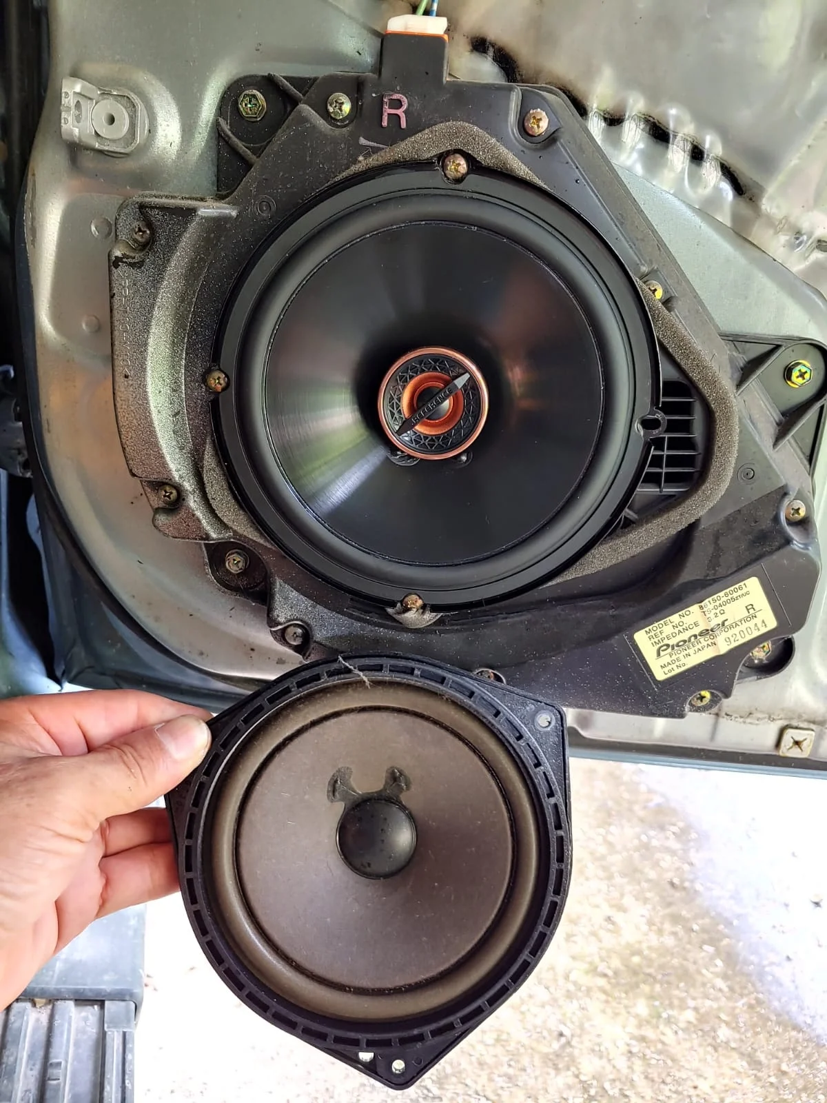

That’s my current plan. But it looks a bit different from the ML surrounds or any surrounds they list. Not even sure they are foam or butyl. Posting a picture I found on mud below. The person holds oem pioneer in his hand.

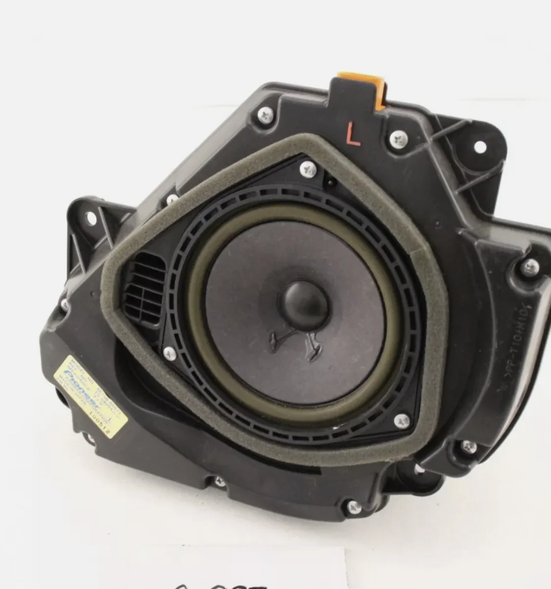

No. Check the one the person is holding. He replaced it with aftermarket. The pic below that is an oem one for sale in ebay.
Yep, I should have been more clear. The on on the top is aftermarket, the others with the paper cone are OEM.

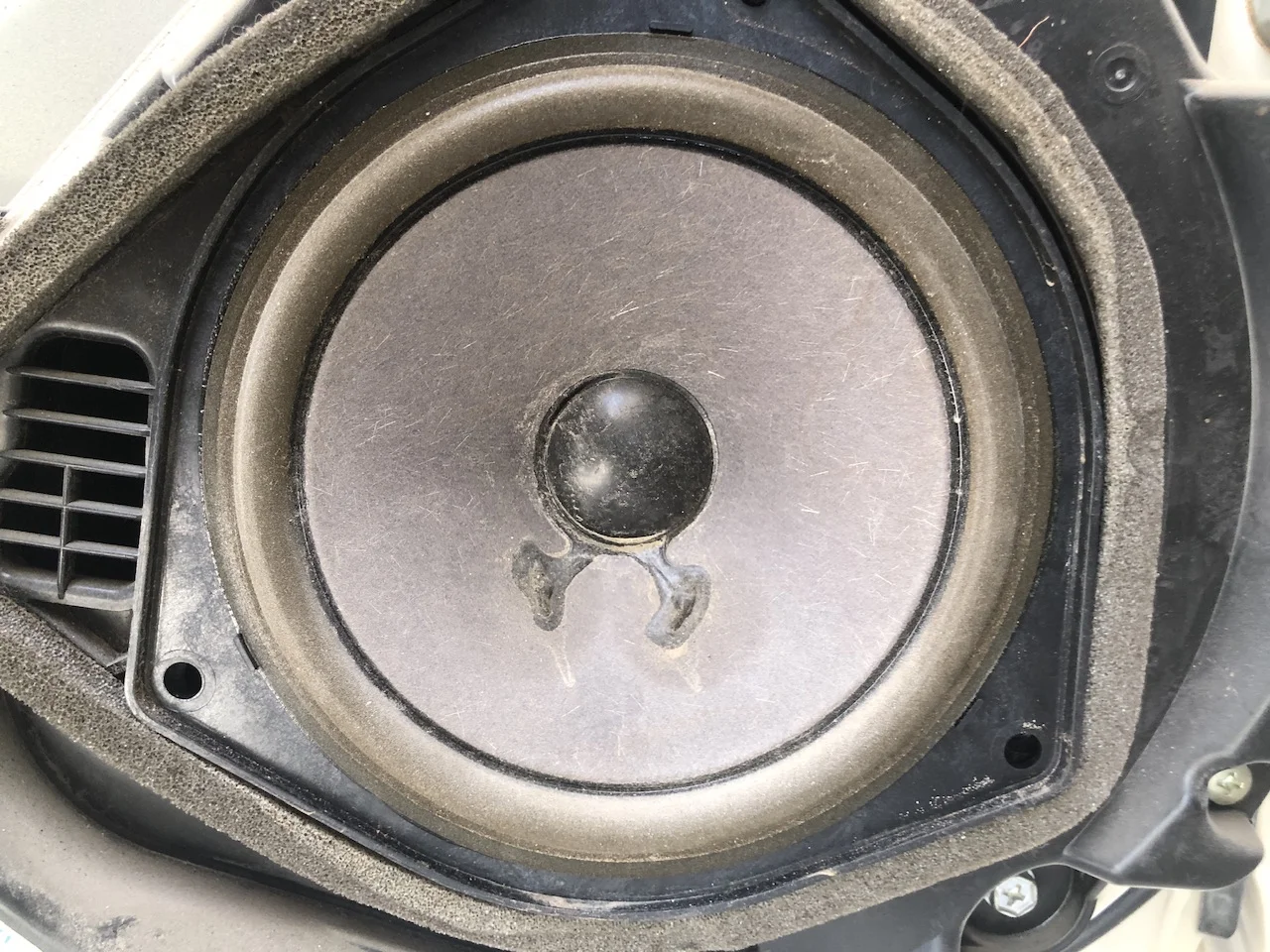

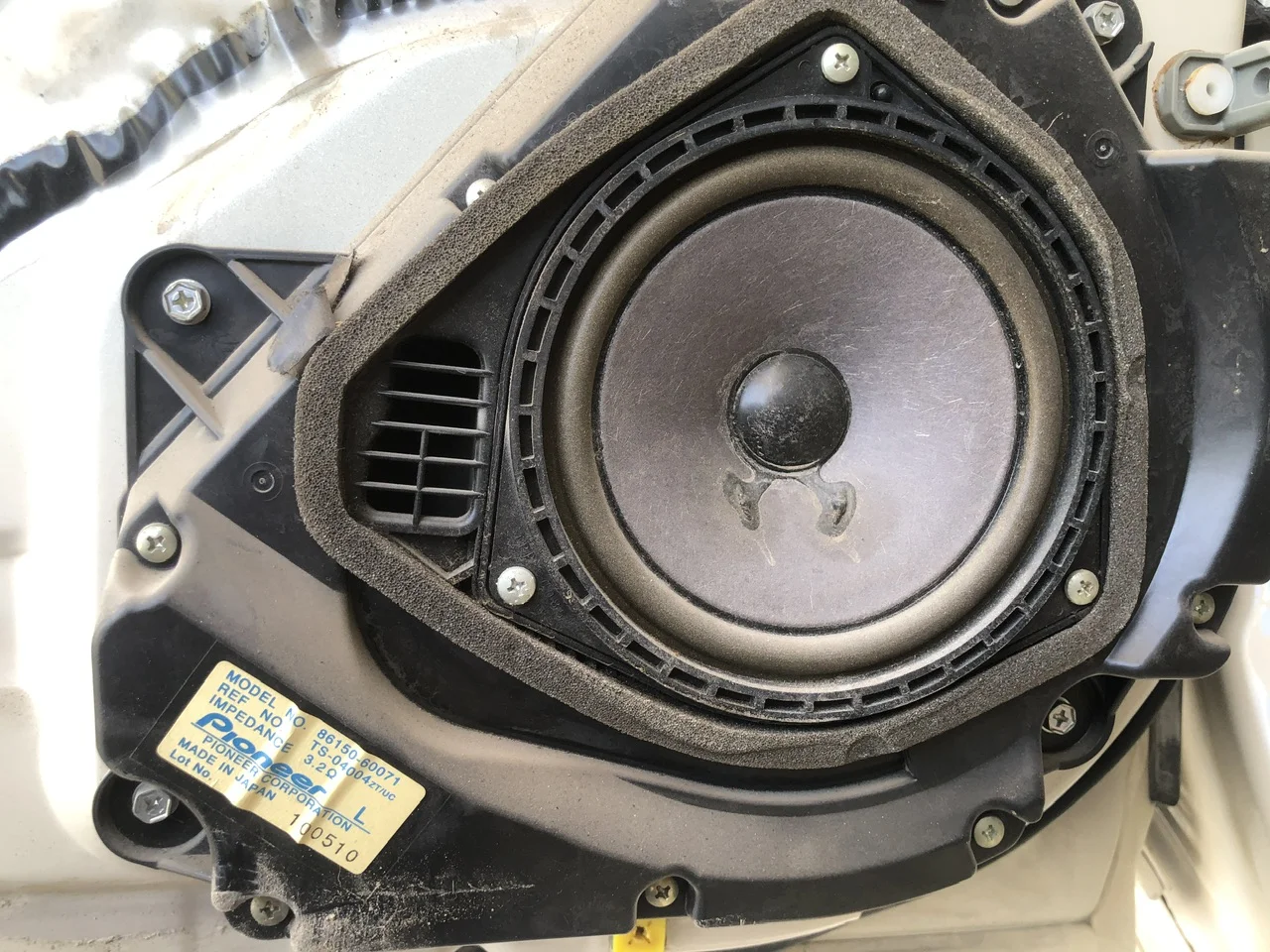

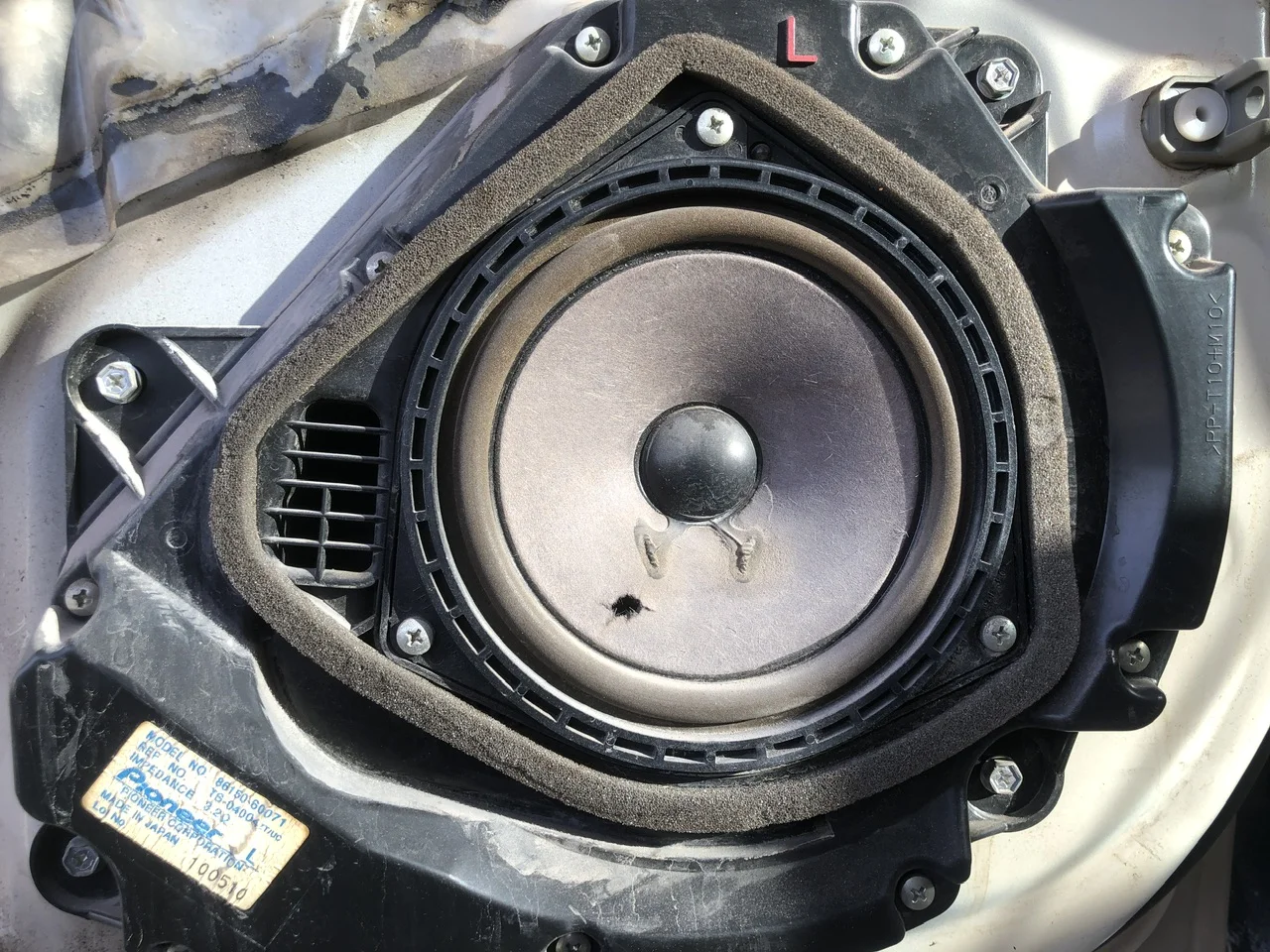

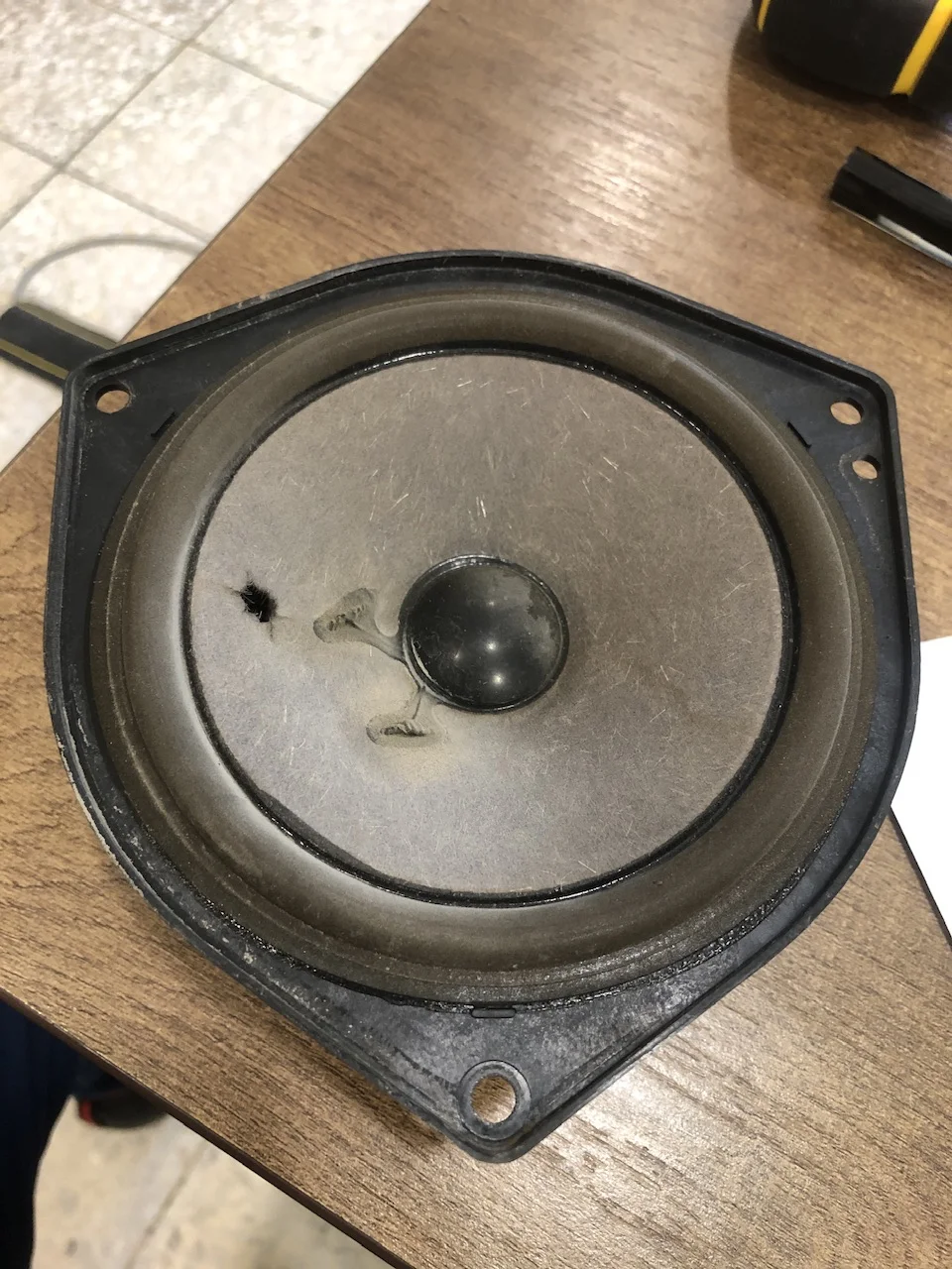

Front:
Rear:
Both foam surrounds looked fine. No cracks or tears, even by touching there’s no disintegration. Noticed a hole on front one. Rear one is having no visible damage yet it sound worse. Rear doesn’t have integrated tweeter as I was expecting. They say it is a full range speaker, I’m not sure how. Now back to out of ideas about sound improving. I wish I had dry rotted Mark Levinsons , at least could refoam it🙁.
