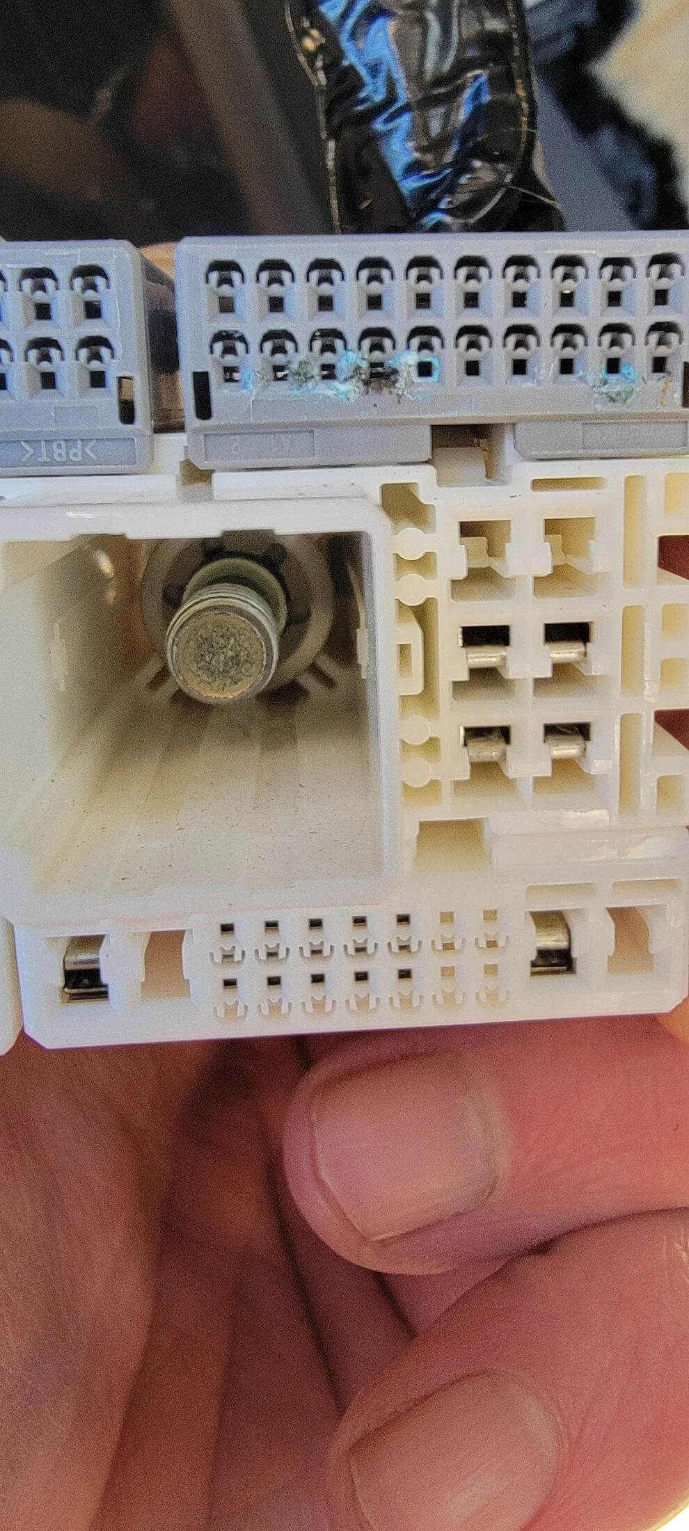

As pointed out by others, check the electrical connectors by opening them in the passenger A pillar near the bottom as well as the amplifier below the passenger seat. One time water exposure can corrode those and cause continuous confused electrical connections, working one moment and the next it does not.
I checked the FL1 plug, the bottom plug behind the kick panel. No corrosion. I need to check the wires under the seat. Dealing with a dead battery now. Has anyone experienced this issue with 2018+ models? I haven't found any posts across multiple forums where owners of 2018+ model year LX's have this issue. Maybe they changed something?
Yes, get to the amplifier and check for corroded connectors. Hopefully a good and careful clean up of the pins can fix the issue
This is the bottom plug on the drivers side.
