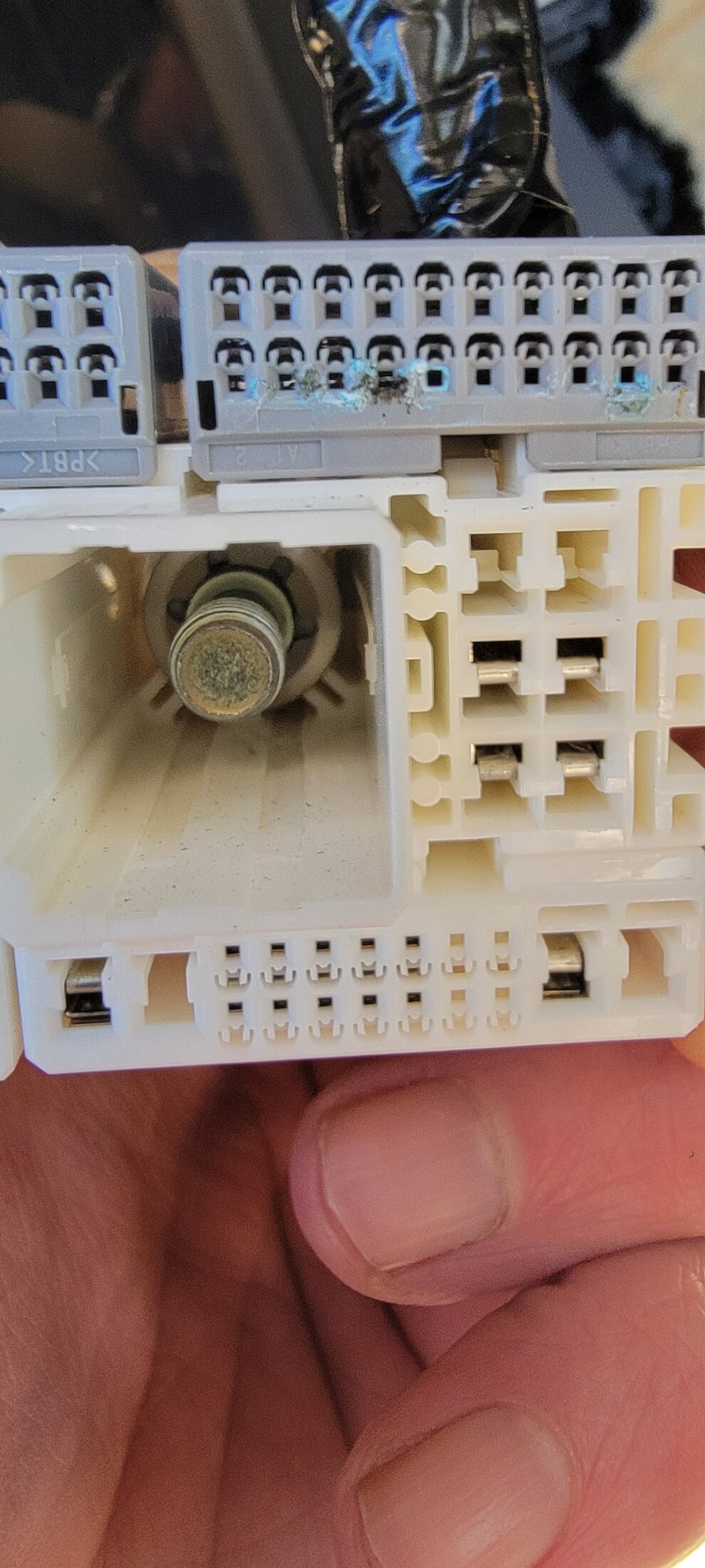

My audio is out also and amp and computer under passenger is good and dry like from factory

Sorry for the late response. The plug is behind the kick panel. I had a sunroof drain leak on that side. I didn't need to pull the carpet.
So... the problem came back. There's zero signs of water intrusion, so I'm wondering if the oxidation is further up in the connector and the deoxit is breaking it down just enough to leech back down and when it dries the residual oxidation is breaking the connection. Would using dielectric grease be a better solution once I clean the connector?
