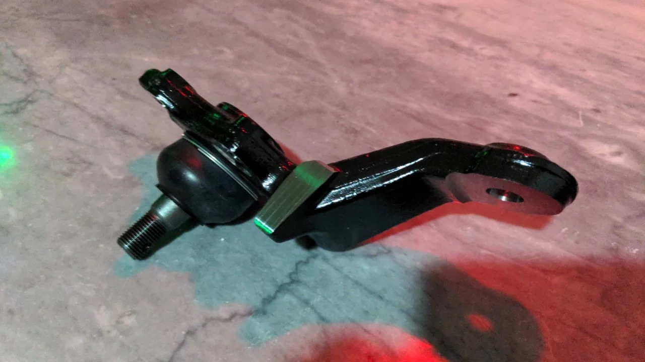

With that 2mm gap, has anyone seen the ball joint shift downward? Or is the friction fit more than enough to hold it in place?
Ball joint presses upward into LCA, and LCA presses downward (T-bar pressure) into it. So no issues whatsoever with gap between snap ring and LCA. Snap rig is simple a safety, we could go without. Unless you ball joint fits loose. But in that event (loose), you've either some under sized ball joint or in need of new LCA.
Some think they've pressed ball joint in to far. Wrong! We should or must, press in as until it stops.
Thanks! Mine pressed in fully, not loose at all, and looks just like the pic. I won't worry about it.

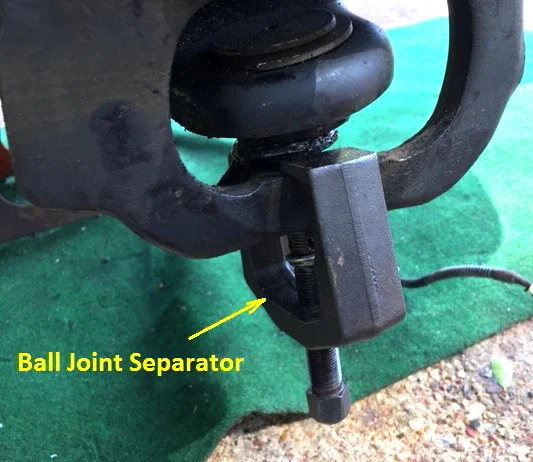

This is what I use also. I'm not a fan of the BFH method.
Use a GOOD quality separator and a pickle fork. Use the separator to apply pressure, then insert the pickle fork between the joint and separator and hit that. I've never had it fail and you won't have tools go flying across your work area or damage vehicle components.

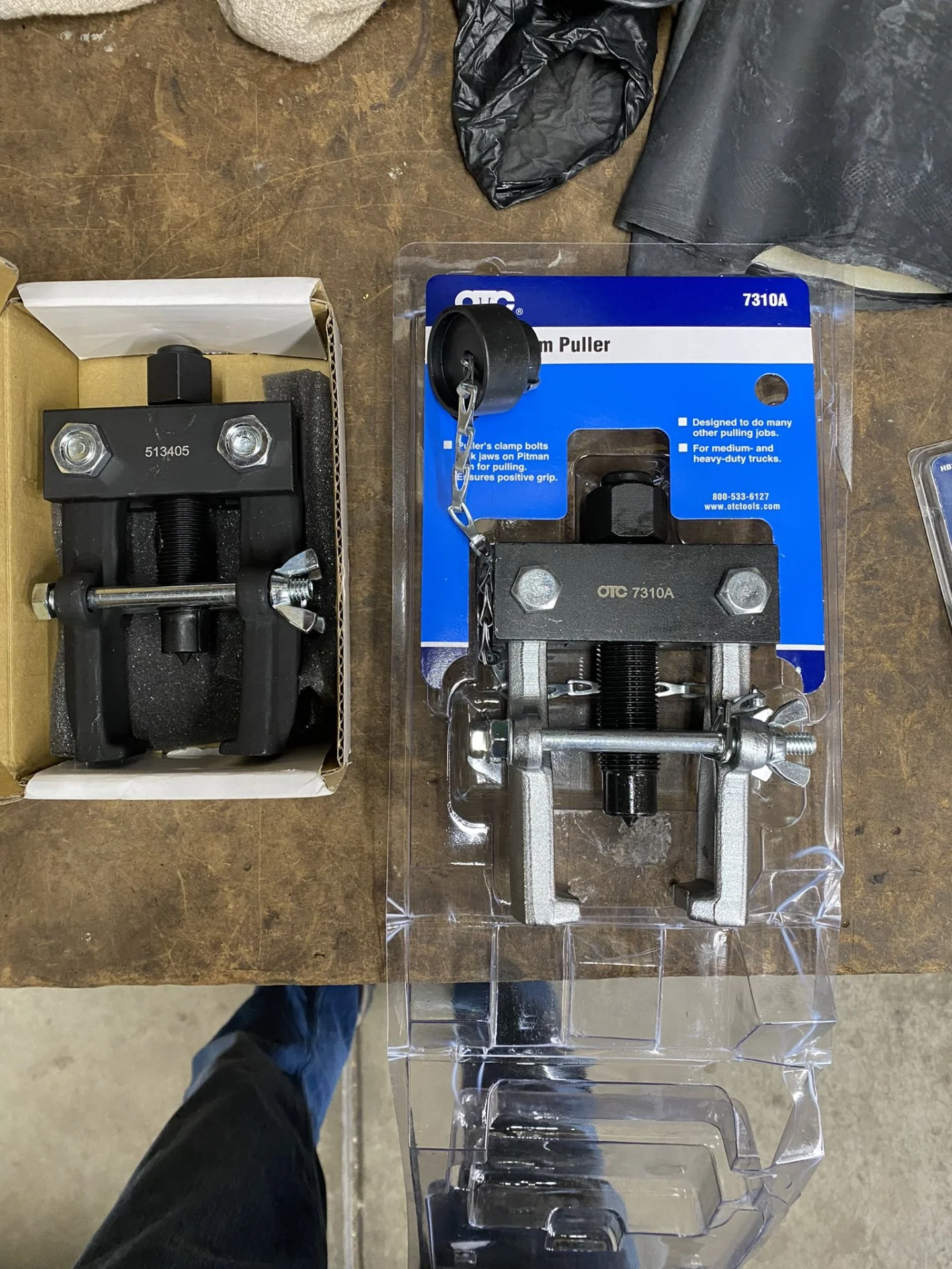

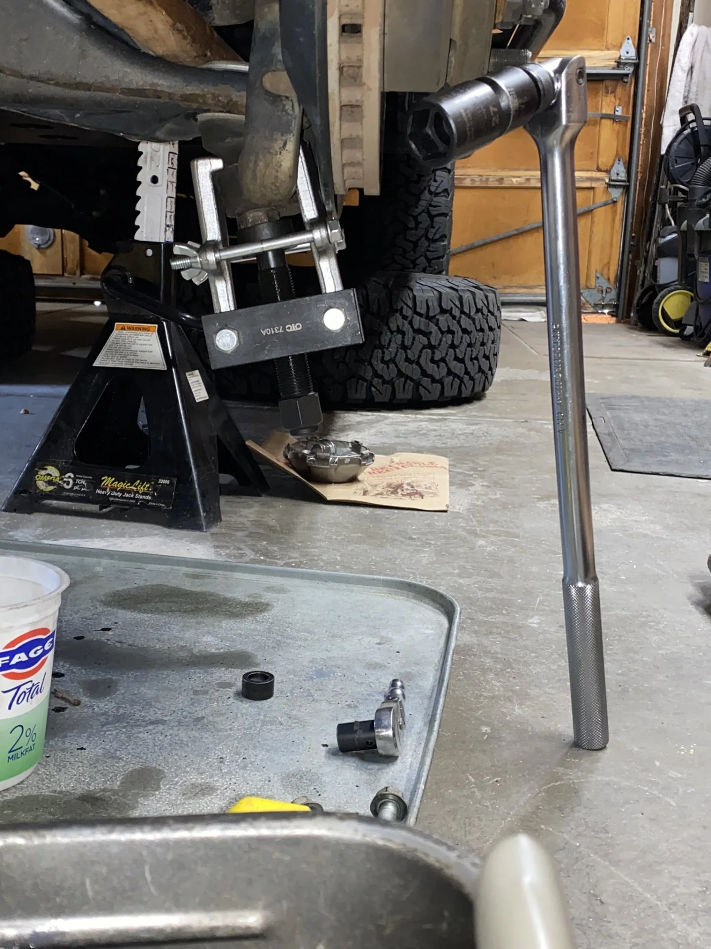

I did just purchased a new puller that is a bad ass. Which I can put my 3/4 breaker bar w/27mm socket onto it. (need a 3/4 " dr 27mm now)
It will pull lower BJ with wheel hub on. Sweet! But only my old little puller, will pull upper ball joint
Note: Cup press plate, between puller and ball joint stud/nut. It's helps center the puller, by use of the nut. It does NOT press on nut. Nut is thread down, so stud protrudes out of nut just a tad. Cup plate presses on end of stud. We DO NOT want to press on nut, as it can damage threads. Cup, helps spread force evenly and squarly, which is key.
I really "liked" it's smaller brother. But with the smaller puller, none of the OTC cup guild press plate(s) will not fit. Since I always use a cups, it useless to me.
The ball joint, I have the most difficult with. When they're really tight/stuck. Is always the TRE. For some reason that one can be a real bear. My new larger puller used with 3/4" dr breaker bar, handles TRE easily. But I can't use it on TRE, with wheel hub on. Bummer!
@flintknapper If you know of any puller, I can use on TRE with wheel hub on. I'd love to hear about it? It needs to be strong!
The ideal one, would be one puller that gets all 3 ball joints off knuckle with wheel hub on, accepts a socket and is strong enough to take the force a 3/4 breaker bar can exert. And does not damage BJ, boot or brake dust shield.

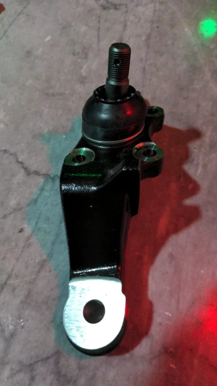

What's the consensus on the Napa lower ball joint, good enough? I can get one locally by Saturday which is appealing.
Take a look at it in store and if it doesn't say 555 on it don't bother. Unless replacing ball joints is your hobby. Why waste time with something that won't last? 555's are the same price.
They're not painted though, bare metal. So I hit them with brake cleaner and sprayed a few coats of rubberized undercoating from the auto parts store. Perfectly matched the rest of the undercarriage.

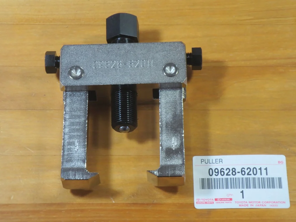

I bought this SST ball joint separator as mentioned in the FSM. I added it on to my last Impex order for $45. It works great for upper and lower ball joints and tie rod ends so far! 09628-62011
No just adjustable width. The side screws make the adjustment. @2001LC OTC tool is probably better with the different mechanism to hold the legs at a fixed width.
Did this work on TRE with brake dust shield on?

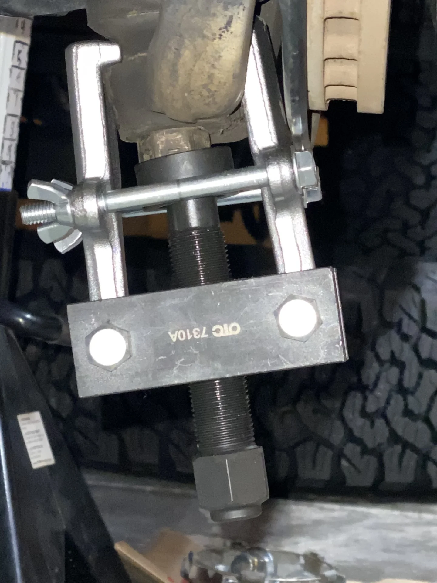

The OTC 7310A is a brute and will do LBJ, brake dust shield on. It will do TRE, but dust shield must be removed. It will not do the UBJ.
With dust shield off, I do like the OTC for TRE. As its the joints that sometime the hardest to pop. With the OTC puller I can use my 3/4" breaker bar, and easily put a great deal of force to the joint.
The Toyota 09628-62011 getting all 3 with brake dust shield on. It's going in my cart today :)

Well, the OEM SST puller 09628-62011, it not fitting TRE for me.👎 Perhaps you can post a picture of in use on TRE?
Seems to me: The arms need to be longer to get bracket protion of puller above (to clear) dust shield. Currently the bracket protion of puller is pressed up against brake dust shield. So much so, I can not get good alignment with TRE stud nor full grip with arms, with wheel hub on. In cases where TRE really stuck on, it's not going to be pretty unless wheel hub and brake dust shield removed.
It's a good puller, for LBJ with brake dust shield/wheel hub on or off. It's no better for UBJ, than the common small fixed pullers.
