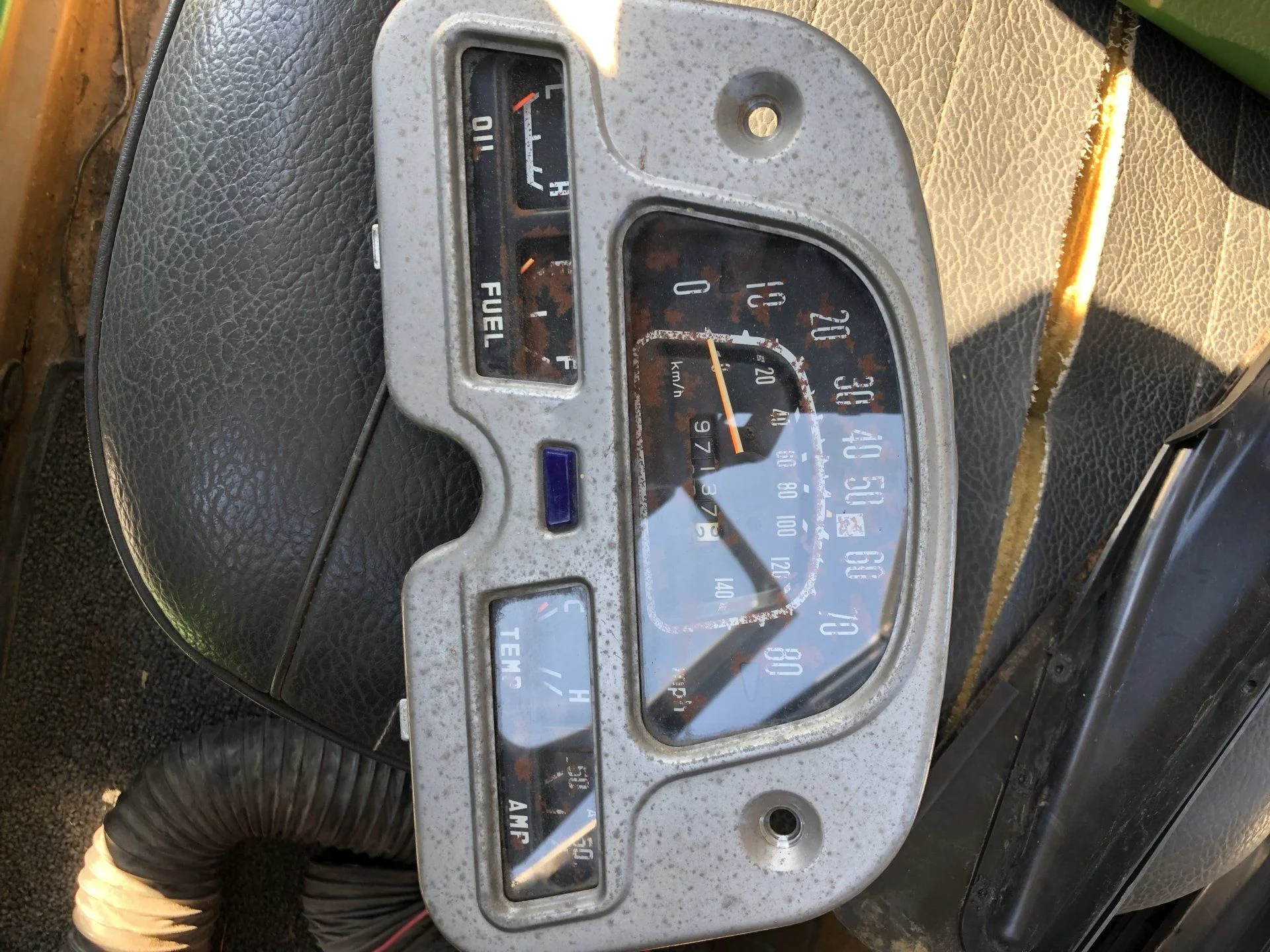

I for sure have a carb. Do you have a pic of your cluster? As @SW20 pointed out, there are some subtle differences in the faces on the 79+ clusters.

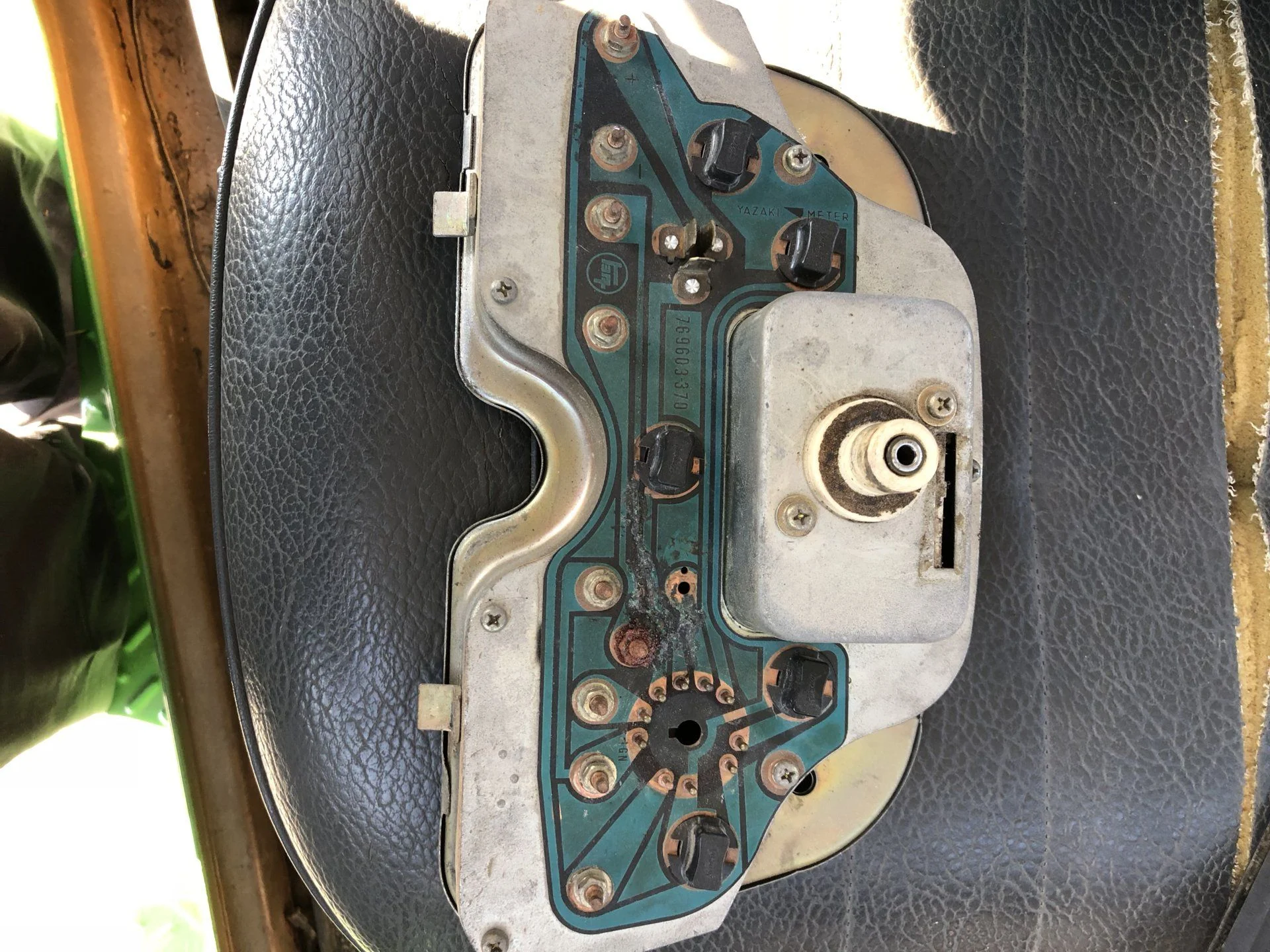

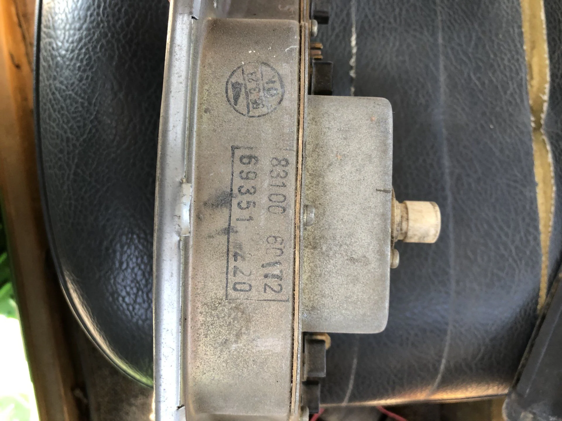

This is the correct 1980 Cluster. Between the 50mph and 60mph, it should have a "55mph" in between. The 1979 did not have the "55mph"
Yep, this is the one we need. The stock one that was in the truck has gfs (green fuzzy stuff) all over the board. Rob provided another cluster, but it does not have the three spade connector on it, only two studs for power and ground.
