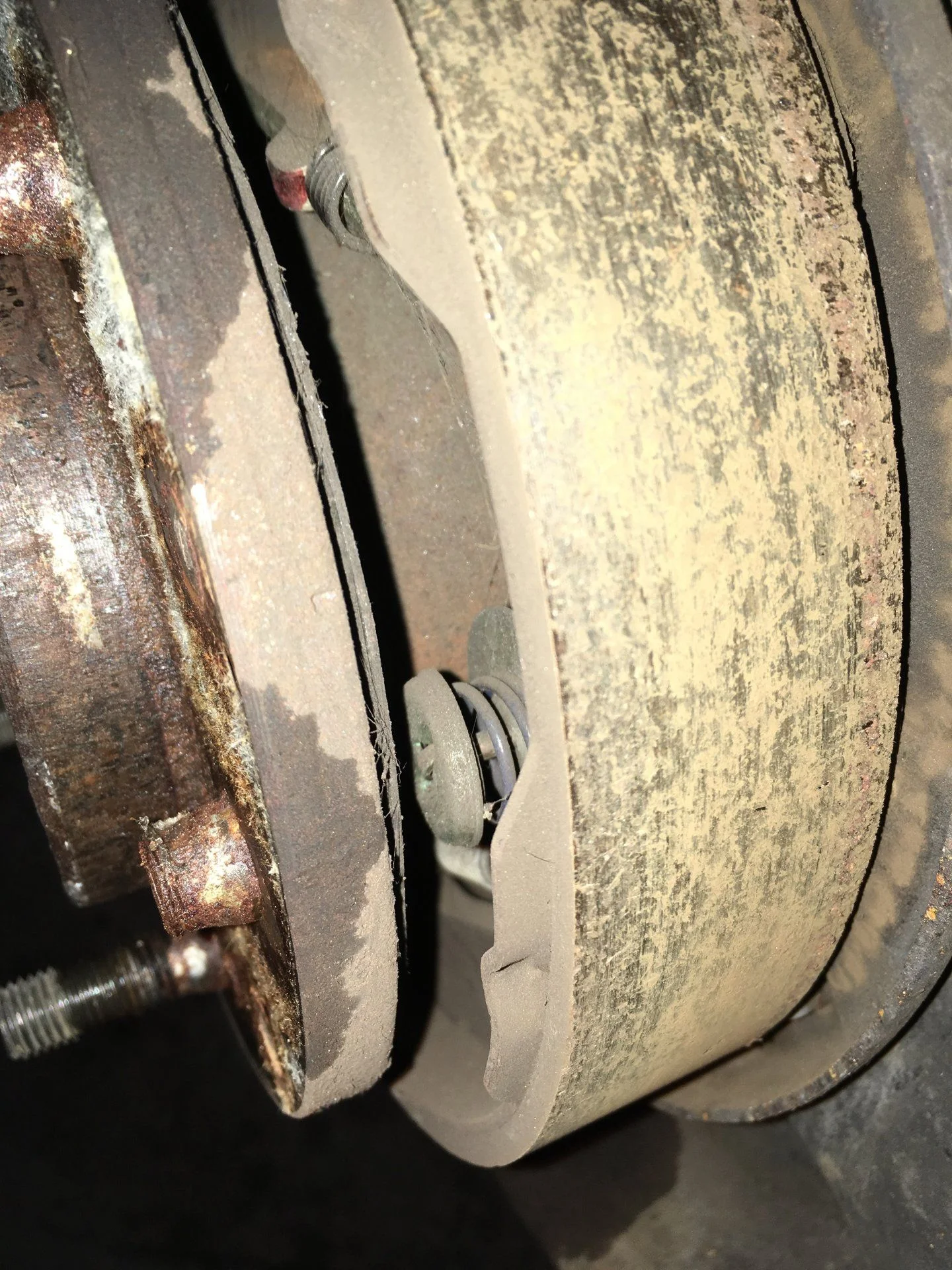

I'm going through my rear brakes right now, after sitting for over 2 years they are all seized up. The emergency brakes can be disassembled without removing the axle shafts, but there isn't much clearance to get the little spring retainer caps off. I have yet to see if I can get them back together without removing the axle.

Also, this info is super helpful @GTSSportCoupe ! Thanks a ton!
I am facing the same exact problem. I wanted to do the job myself but it's very cold in the garage so taking it to my mechanic...hehe.
