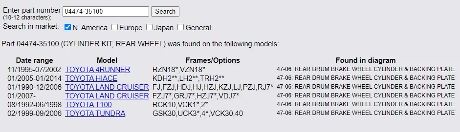

My 1991 LJ78 has rear drums. Any details on wheel cylinders? I thought it was the same as a 60 series. Thank you
Probably more like pre 95 truck/4Runner
I looked up the LJ77 part number here: 1990 - 1993 Toyota LAND CRUISER LJ77 OEM Parts | Europe sales region, , 925683 - https://www.megazip.net/zapchasti-dlya-avtomobilej/toyota/land-cruiser-38286/lj77-55784/lj77lv-mnxw-925683
Used this to cross it: ToyoDIY.com - https://www.toyodiy.com/parts/xref
Note, follow that ^^ procedure for ANY part you want to cross!
Also, note it DOESN'T cross to the same year 4Runner, but 3rd gen models only. But also 1st gen Tundra, and SAME as all the HD 70 series Landcruisers from 1990 on!
Interesting they are still using these brakes on modern VDJ76 even!! I always chuckle when people compare the LJ7x to Hilux when it shares far more with HD cruisers.
