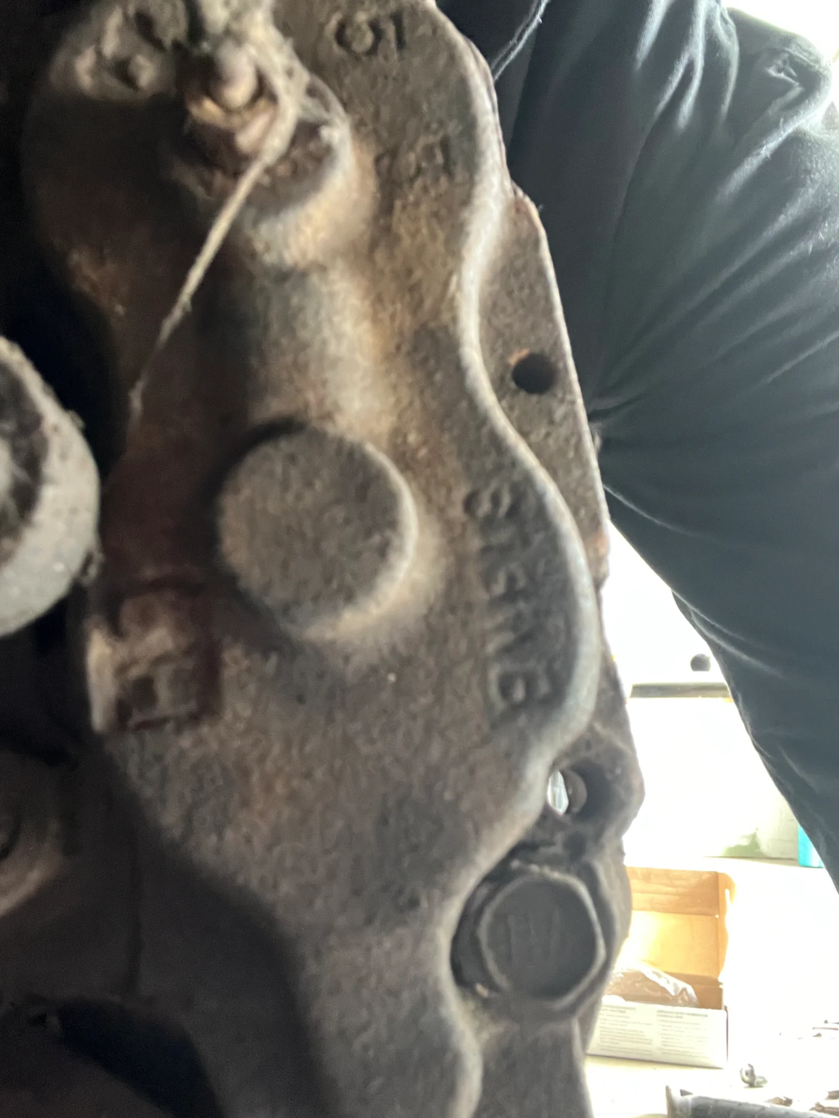

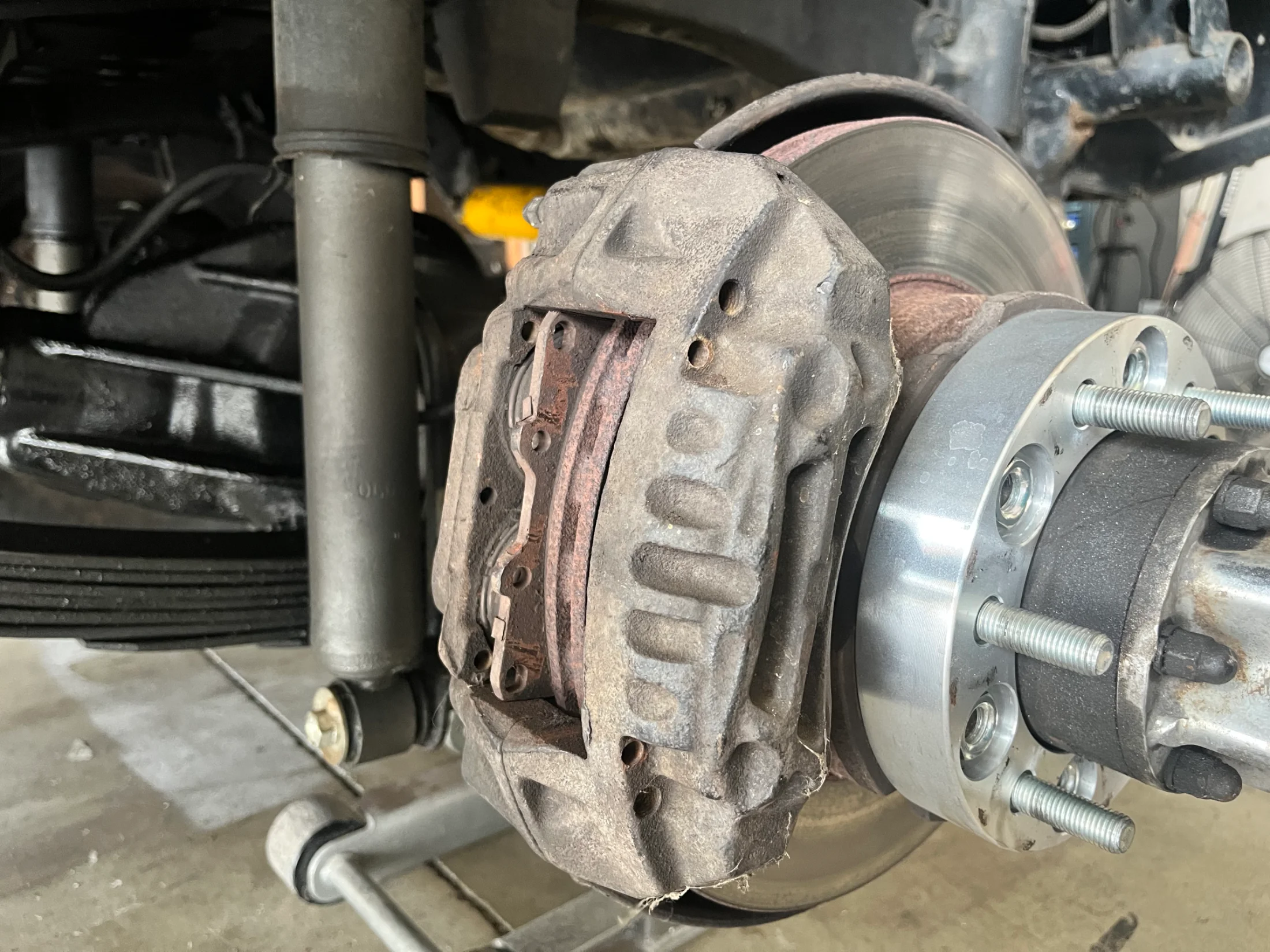

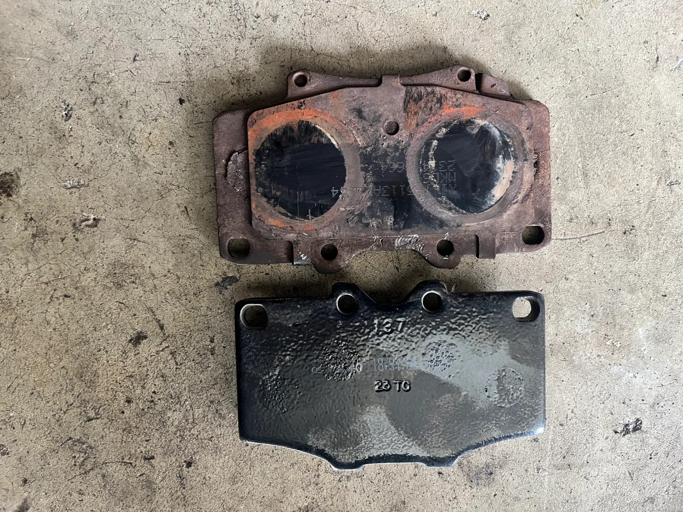

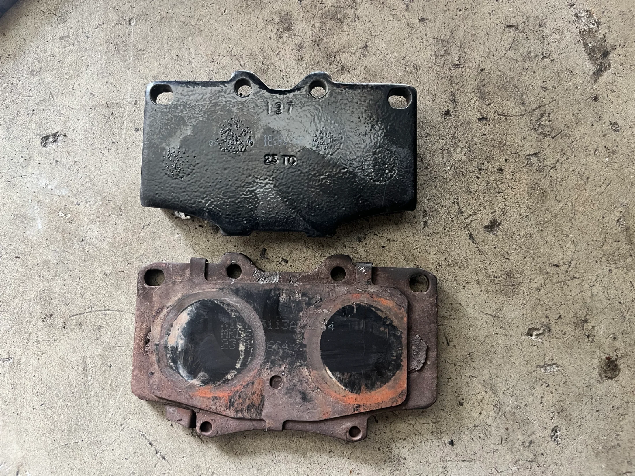

Went to go change pads on my 87 bj74 and the pads I got are too small. At first I thought i ordered the wrong pads (fj60/62) but then did some digging and my calipers appear to be different.
Can anyone chime in? I’m thinking they are either 90+ 70 series? Or maybe fzj80?
the brakes feel great but the pads are low. So im just interested in what pads to buy.
Below is a photo of my caliper along with new vs old pads.
Looks like you have the newer 90+ 70 series calipers (same as 92-01 4Runner). Hard to tell from your photo but the newer calipers should have S13WB as the casting mark. The pistons on the newer calipers are both the same size, older calipers one piston is smaller than the other. Newer calipers take pads for a 92-01 4Runner, 93-98 T100.
