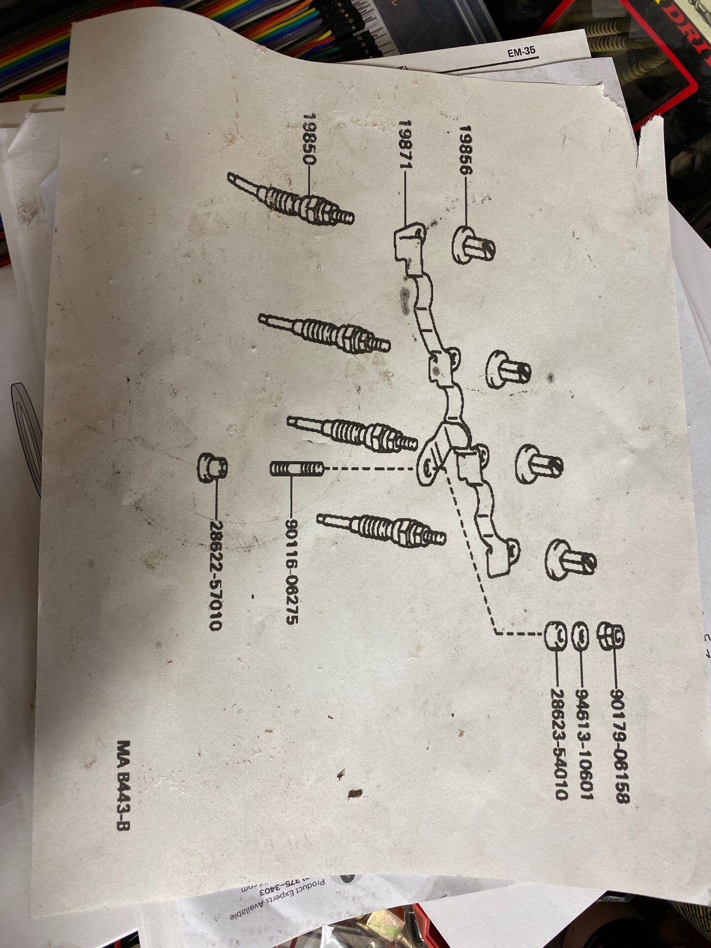

Consulting the shop manual I see the problem. It doesn't really show the order to reinstall the glow rail.
So I used a wire brush and cleaned all the connections and then put the glow rail on before the wiring. The LC starts right up again. I think the issue was a poor connection that wasn't allowing the glowplugs to get enough juice. There was a connection according to the volt meter, but not a good enough connection to carry the ridiculous amps required to glow the plugs.

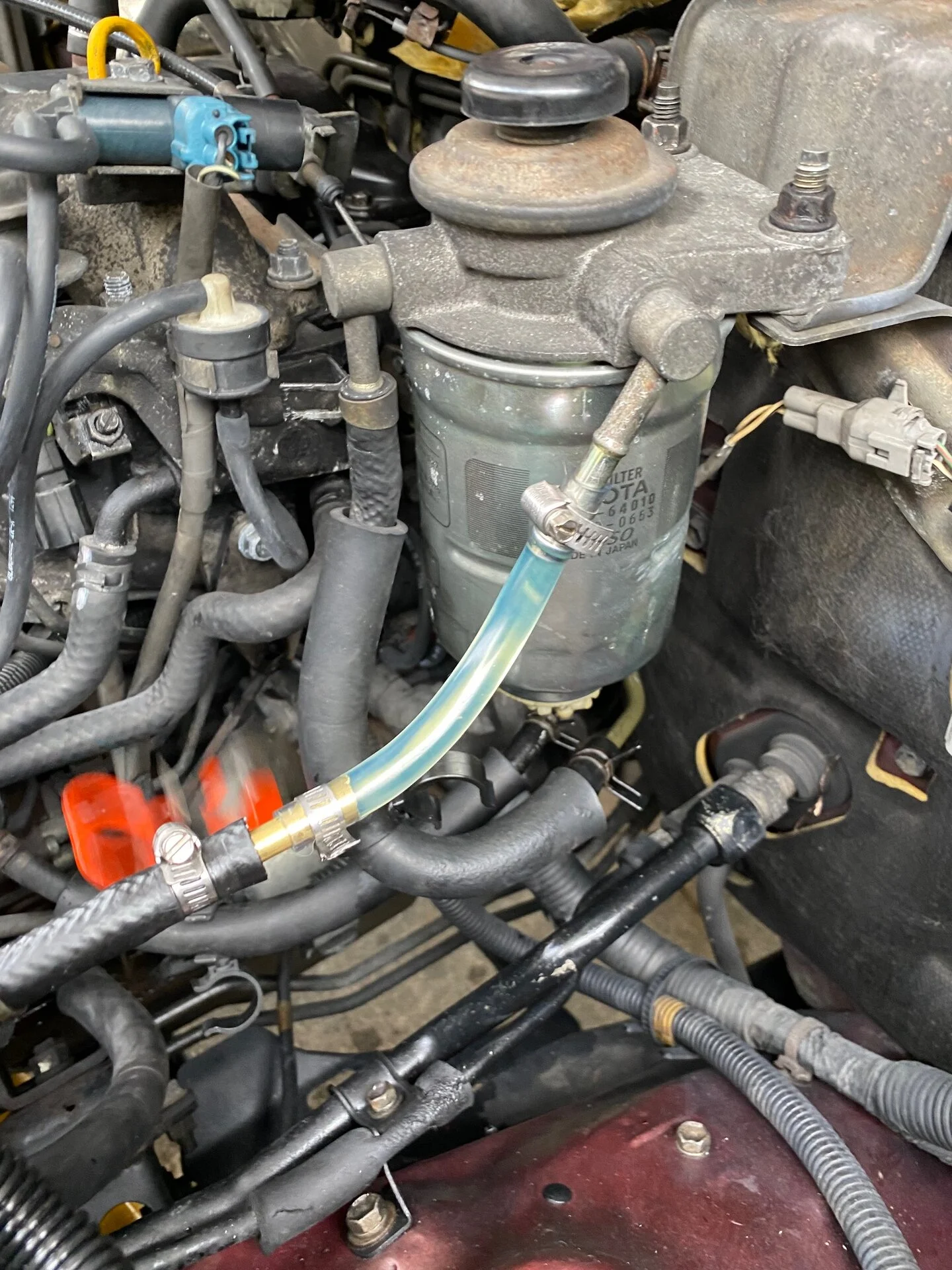

If the glow system is compromised then I'd expect rough running and white smoke until warmup but stalling out entirely after running is something else... As Airhead said, you don't need glow to run. Given the leaking injector, I'd suspect air in the fuel system. Might be time for the clear fuel line? We all end up here eventually. LOL. If you're not familiar, many of us have done it...
The clear fuel line is a great diagnostic tool. I replaced a return fuel line that looked old. That helped, but I could still see bubbles. Then I tightened the nut on the fuel return bar that goes from injector to injector. That took care of the leak. Then I tightened the fuel supply line to the first infector. That got rid of the last of the bubbles.
Next I'll run it for a while and check for white smoke. As I understand it, that points to air in the fuel line.

Yep - white smoke is typically either unburnt fuel (incomplete combustion on cold start/ low compression / retarded timing) or air in fuel. Sounds like you nailed it!
I ended up replacing all my rubber lines/filter housing/primer by the time I was done, as well as the pickup at the tank. But once the air is banished? Happy days!
