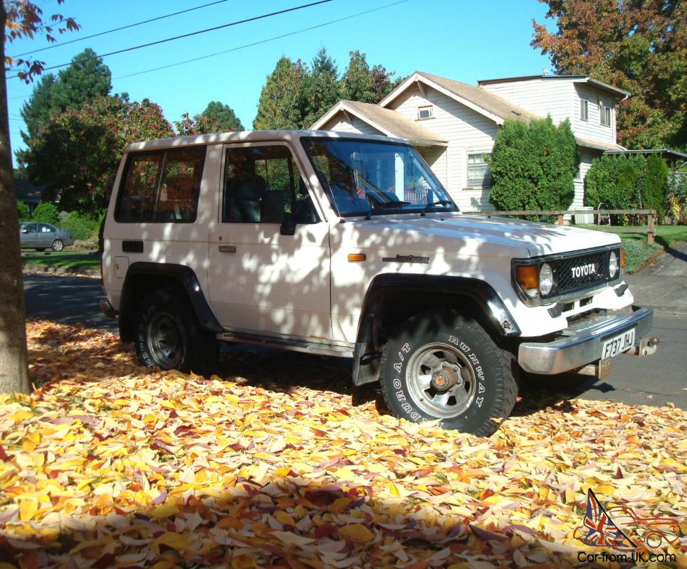

I just posted my intro thread so now to questions. The new LJ is remarkably rust free but will not be unless I do some clean up. The fenders are drilled for factory fender flares and it looks like the rear flare mounts were used at one point. As delivered to me are some aftermarket screw on flares. They look okay but are just secured with a couple sheetmetal screws in the finder lip. No rust yet but if a salt truck gets within a mile I expect the flares may end up in ditch once the screw holes rot out. I will in the short term touch things up with POR but in my mind the preferred alternative is to go back to factory flares with factory mounts with some proper rust preventative work.
So my question is, is the right way to go? I don't plan to install larger tires. I see several foreign sources of claimed OEM Toyota Fender "extensions" with a wide a variety of prices.
I guess this is not a hot topic. I decided to swap back to the OEM flares. All the mounting hardware is still available offshore and the flares have multiple sources (and prices) for OEM. A lot less money than Unimog parts but still pricey as I expect they are regarded as crash parts.

The adventure begins, after a few expensive shipping bills from UAE and Japan, I have a complete set of OEM fender extensions (AKA flares), rubber flaps to fit them , and bags of Toyota mounting hardware. The plan is remove interior trim in the rear to get at the other side of the OEM holes, prep the existing paint inside and out and then give both sides a coat of POR. I will probably give the Toyota brackets a light blast with some glass bead and then dip them in POR. Then rivet them on with the stainless rivets and then coat the rivets inside and out with more POR. I need to take a look if I can get at the inside of the front fender holes but hopefully will use the same approach out front. I will get stainless hardware for the screws that hold the flares top the brackets.

So time to install some flares on the driver side. I am holding off on the passenger side for now but taking good notes. Prep work was to blast all the clips to get some rough texture and dip all the clips in POR. I then had to chase the threads of the clips with weld nuts after the POR set overnight. The contact areas were also coated with POR after light sanding inside and out. The pop rivets are stainless. I used stainless backing washers on the inside of the wheel well. The plan is that I am going to coat the clips and the rivets with POR inside and out now that they are installed. I have found with POR that if two coated surfaces are put together during a cure they tend to bond together.
My guess is the old flares were removed recently as the inside of the fender well did not have any of the clay that the rest of the underbody was coated with. You will note that I am missing some clips. The EPC sketches are confusing and some of the clip locations are not shown clearly. The net result in this some cases I need to order 4 clips with the same part number (for each side instead of 1).
I got the hardware ordered correctly on the front flares but as you can see the front most clip was not installed. Despite ordering the correct clip per the EPC, the clips shipped in the official Toyota parts bags are not the correct piece. The EPC shows a sketch with a dimension of the part and it does not match the part sent. Looking at the EPC they show an exposed hole in the front flare similar to the rear flare. This might fit the clip shown in the EPC put not the one they sent. The genuine Toyota flare marked with the part number from the EPC does not have this hole and the molded cavity in the back of the flare would not accept either. Looks like I get to make a custom clip and drill a few more holes in the fender. The front holes in the fender are smaller so I used a smaller stainless rivet with backup washer on the front as the clip holes are larger. As you can see one of the washers distorted and popped off but the rivet is still tight. I did not have ready access to the back of the fender so no backup washers out back.

The other big issue is that the front flares do not fit as well the rear ones. The numbers are right to the EPC but Toyota must have changed the stamping dies for the fenders. Looking at photos of other LJs with factory flares they show the big round mounting hole that is present on the rear flare on the front of the front flare. The flares I got from Japan with the correct part number do not have this hole and the underlying mounting bracket fro this location is completely different along with holes drilled in the fender sheetmetal. Its close but I did need to file down the front lip and use a different bracket. There is also a wider gap between the flare and body at about 3/4s back. There are locating brackets and mounting brackets that hold the flare on. Although the mounting bracket has some slop, the locating brackets do not so the gap is there. I could build up the lip in this area and then file it back in but for now it will sit. Note photos of other LJS with factory flares show the round hole and a slightly different profile at the front of the flare so there are two versions. Given the freight costs to get two flares shipped, I elected not to try to return them but caveat emptor.
I just rolled two coats of catalyzed poly on them for now but expect when I do a repaint they will get shot along with the rest of the body.
Real great work on an expensive and challenging project. Having said that, I hate to say this... I think you got the wrong front fenders. Those aren’t the ones for the early LJs... that’s why they don’t fit correctly.
