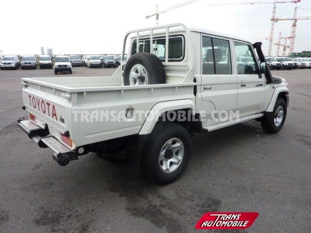

https://www.transautomobile.com/pics/1621/transautomobile-toyota-land-cruiser-pick-1621-791559.jpg?
Is this an oem flare for dual cab?
79
If it come with the 16x7 alloys it come with flares
thanks for that interesting rule of thumb, yeah i did see a few 75/79 utes in the EPC with flares... begs the question of why no troopy ever came without splits, especially in the HDJ78 (still my dream cruiser) that clearly had a less commercial orientation.
