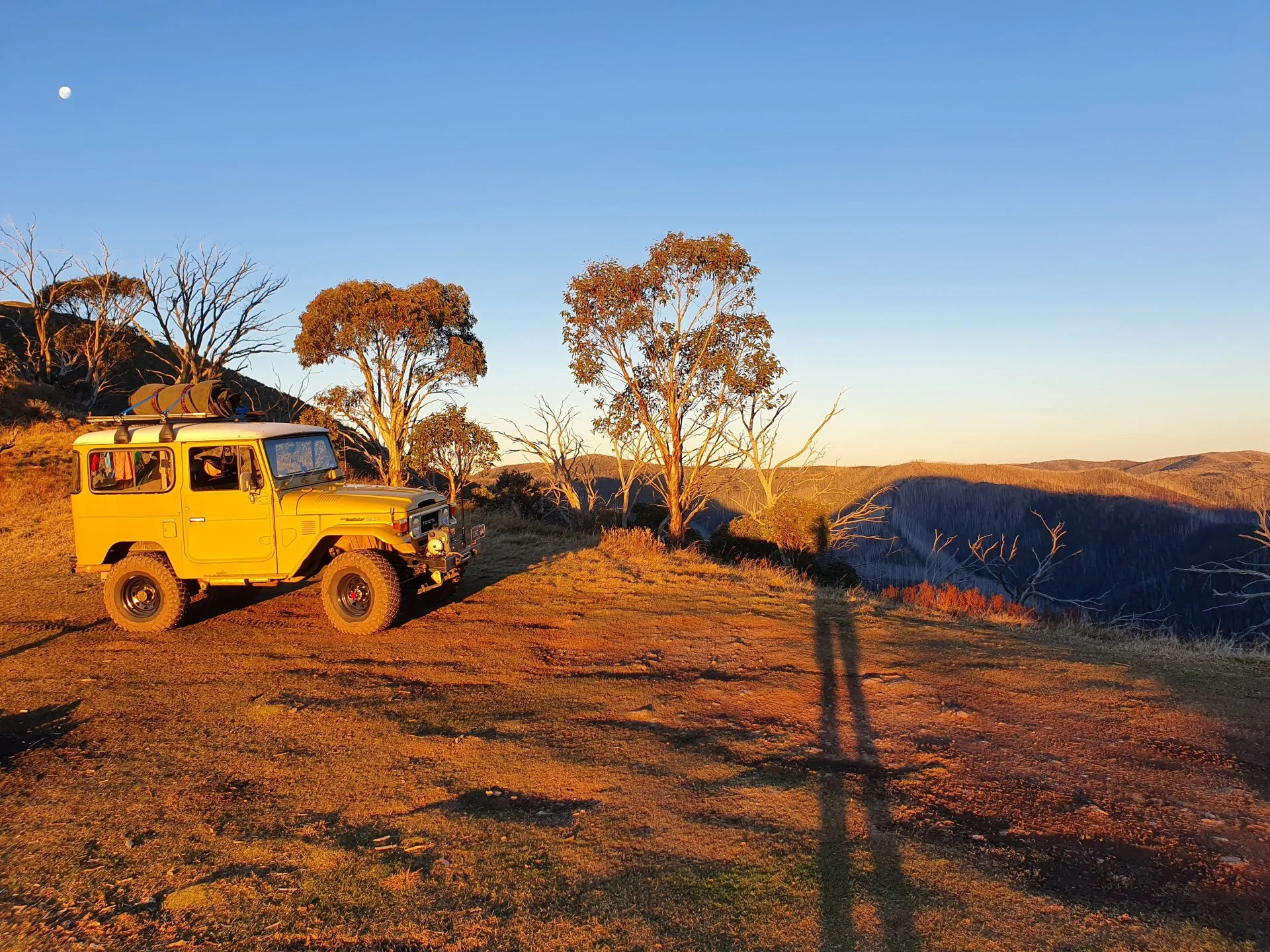

Camp night 2. Not as good as the last few. Its in the 2019/2020 bushfire zone and you can probably tell by the way all the leaves are sprouting out of the trunks. These tree's all have survived. They have re sprouted and in a few more years you won't even know they were burnt unless you look for it.

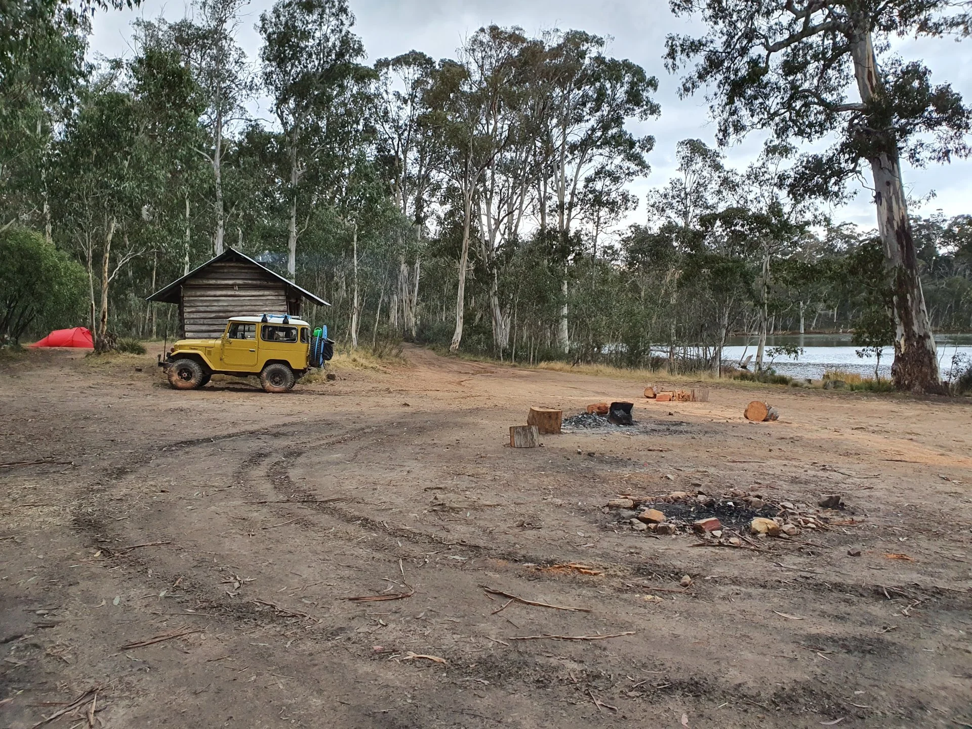

Parked up beside Lake Cobbler hut.

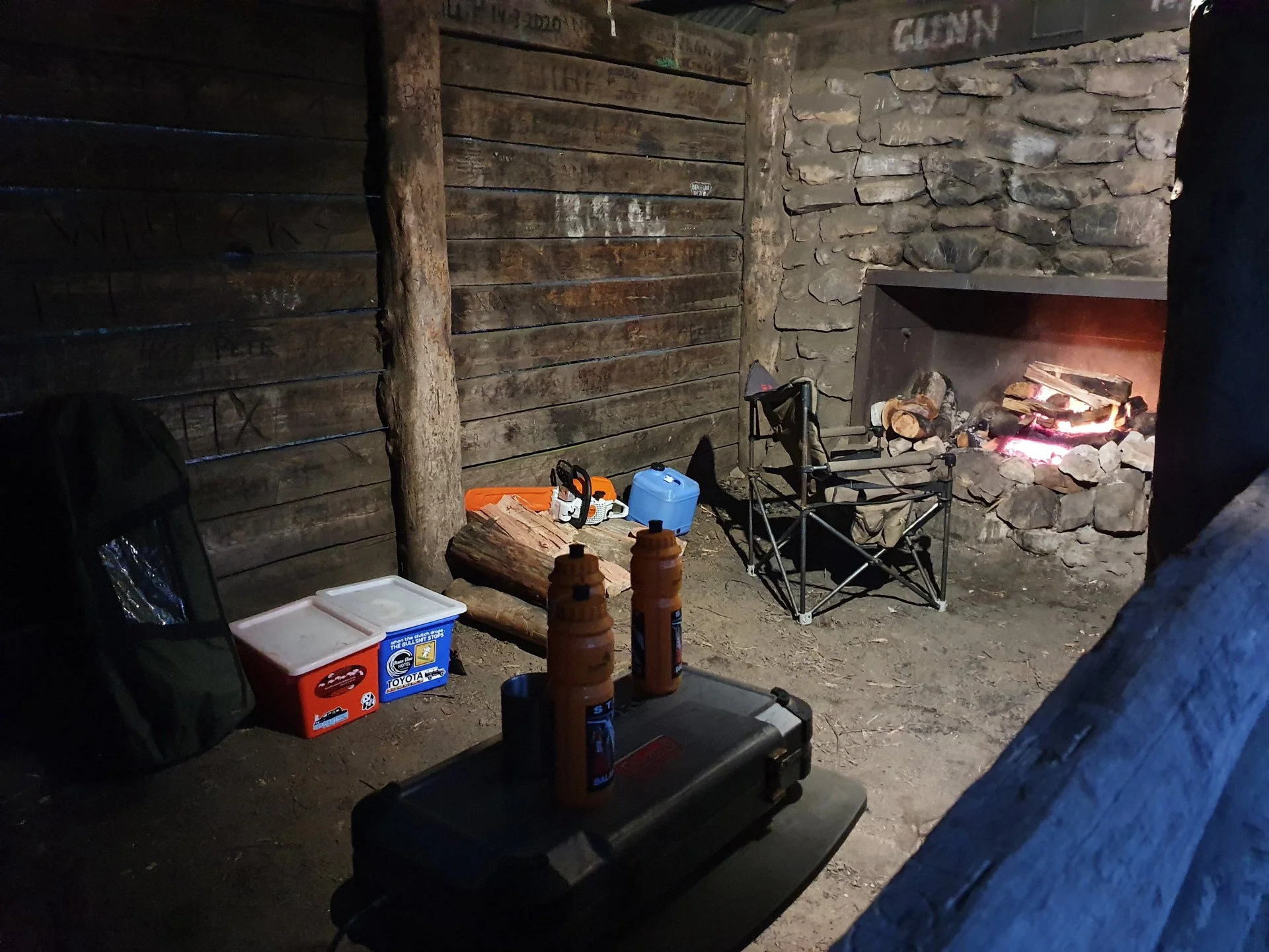

Once i got back from the hike i set up base inside the hut. No one else was around so i had it all to myself. It was flogging rain!! This is taken from the hut looking towards the lake. Can't even see the lake through the rain and it would be lucky to be 50m away.
The kitchen and bar setup inside the hut.
It took awhile to get the fire pumping as all the wood was so wet. Once it got going the hut was toasty warm. I love being in high country huts in bad weather.

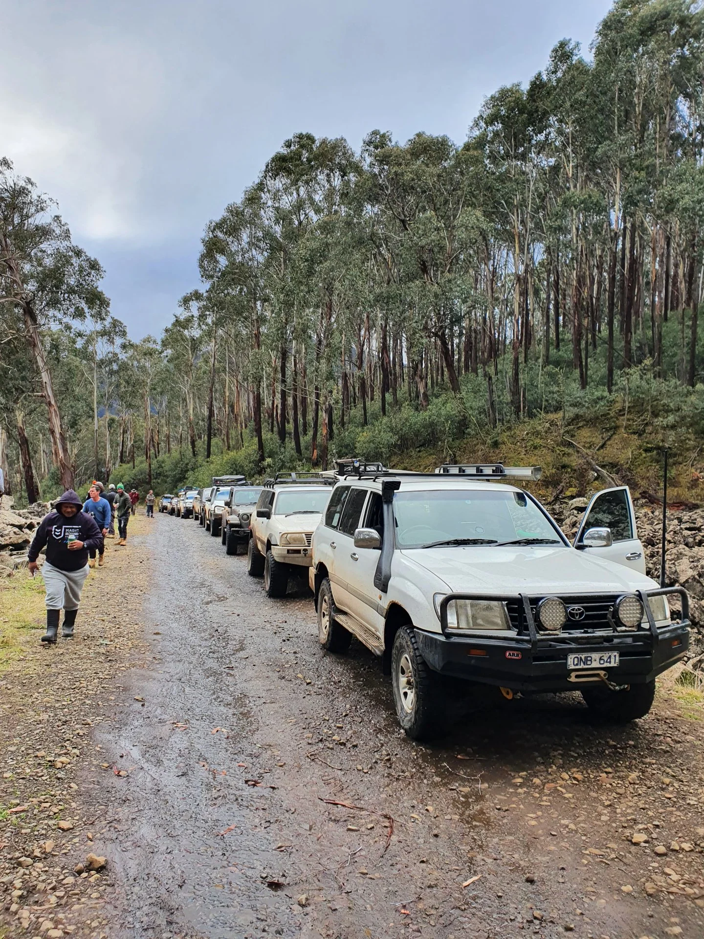

So after 3 days of 4wding i arrived at Mansfield to re stock and meet my old work mates.
There was way more cars than i was expecting. We had two 100 series, a 200 series, a Prado, a GU Patrol, a Jeep Gladiator, a Hilux, a Izusu D-Max, a Pajero, a Triton, a 60 series and my 42 series. It was pretty slow going with that many cars but we had no real dramas. The trip took 3 days and was pretty varied terrain. There was some seriously steep tracks but it was all well maintained and dry so nothing could really go wrong.

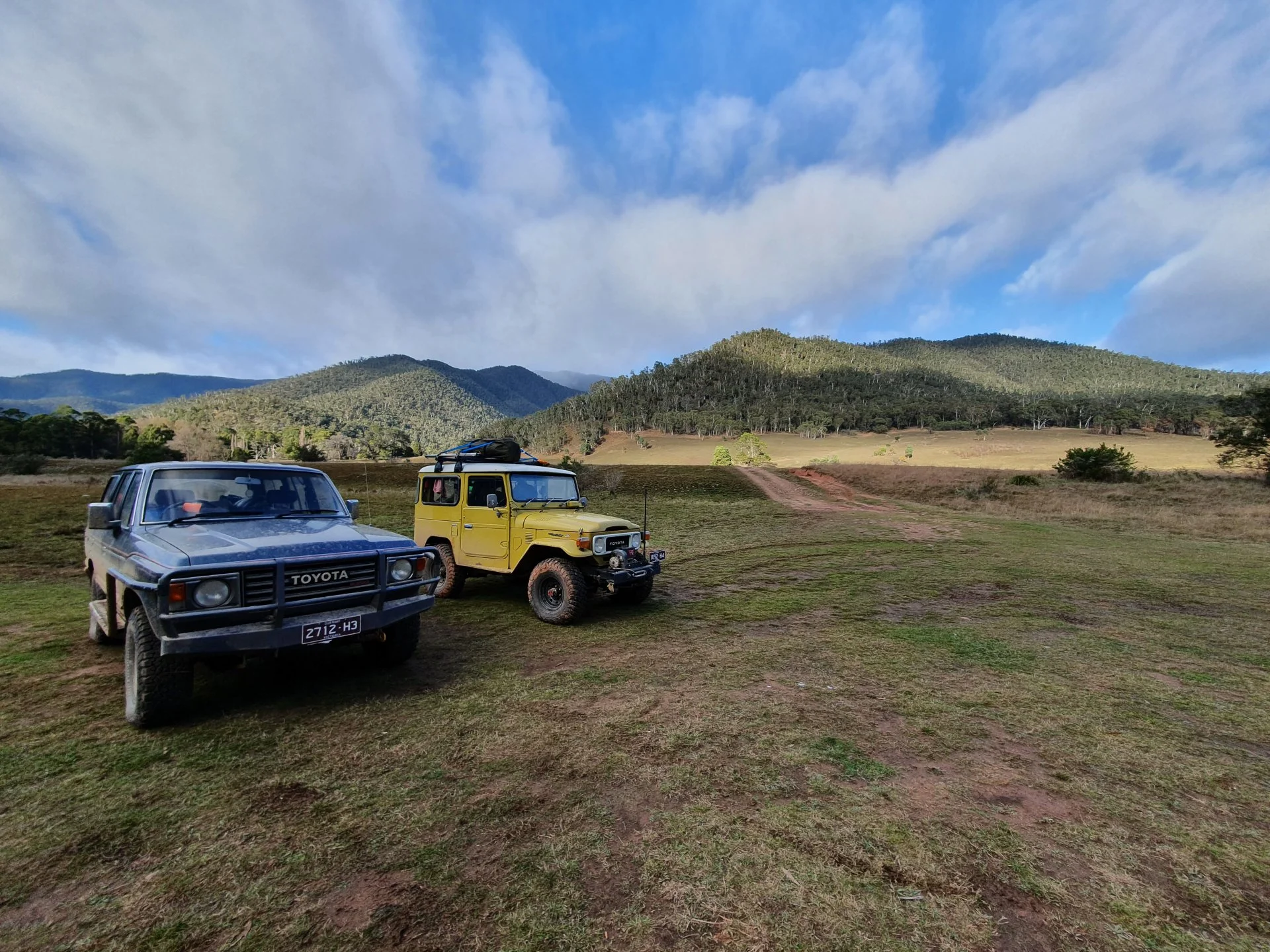

Camp in the Wonnangatta Valley. Really stunning spot. There was actually what looks to be a murder not far from here a few months earlier. Its become one of the biggest mysteries in Australia. Two people have gone missing, their campsite was found burnt out. But their 79 series Landcruiser was fine with the keys still in the ignition. They havn't been seen since. Their bank accounts or phones have never been used. The only thing missing is their drone.
The valley is one of the most isolated places in Victoria and there has been a lot of strange things take place there over the years.
There is a lot of history in this valley, a lot of it is pretty brutal. It was hard living back in the day. The stories on the plaques scattered throughout the valley do a great job of telling the history and its hard to imagine what these early settlers went though.

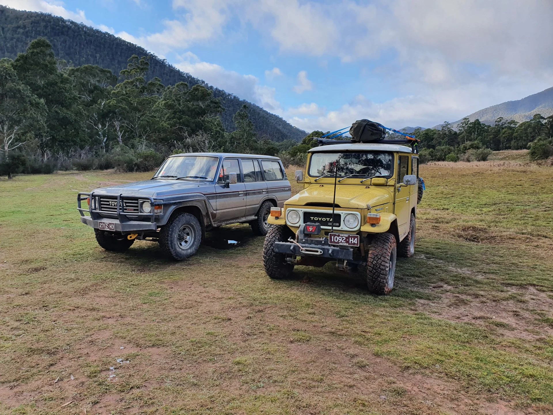

The 2 coolest cars of the trip!
This is my mates HJ60. Its probably the best example i've ever seen of a 60 series. That's probably its only problem, Its too nice so he gets too scared to wreck it!
Its got the factory 12HT diesel motor, ARB front bar, rear bar and a long range fuel tank, apart from that its pretty much stock as a rock. Just looking at this picture makes me wanna buy one!

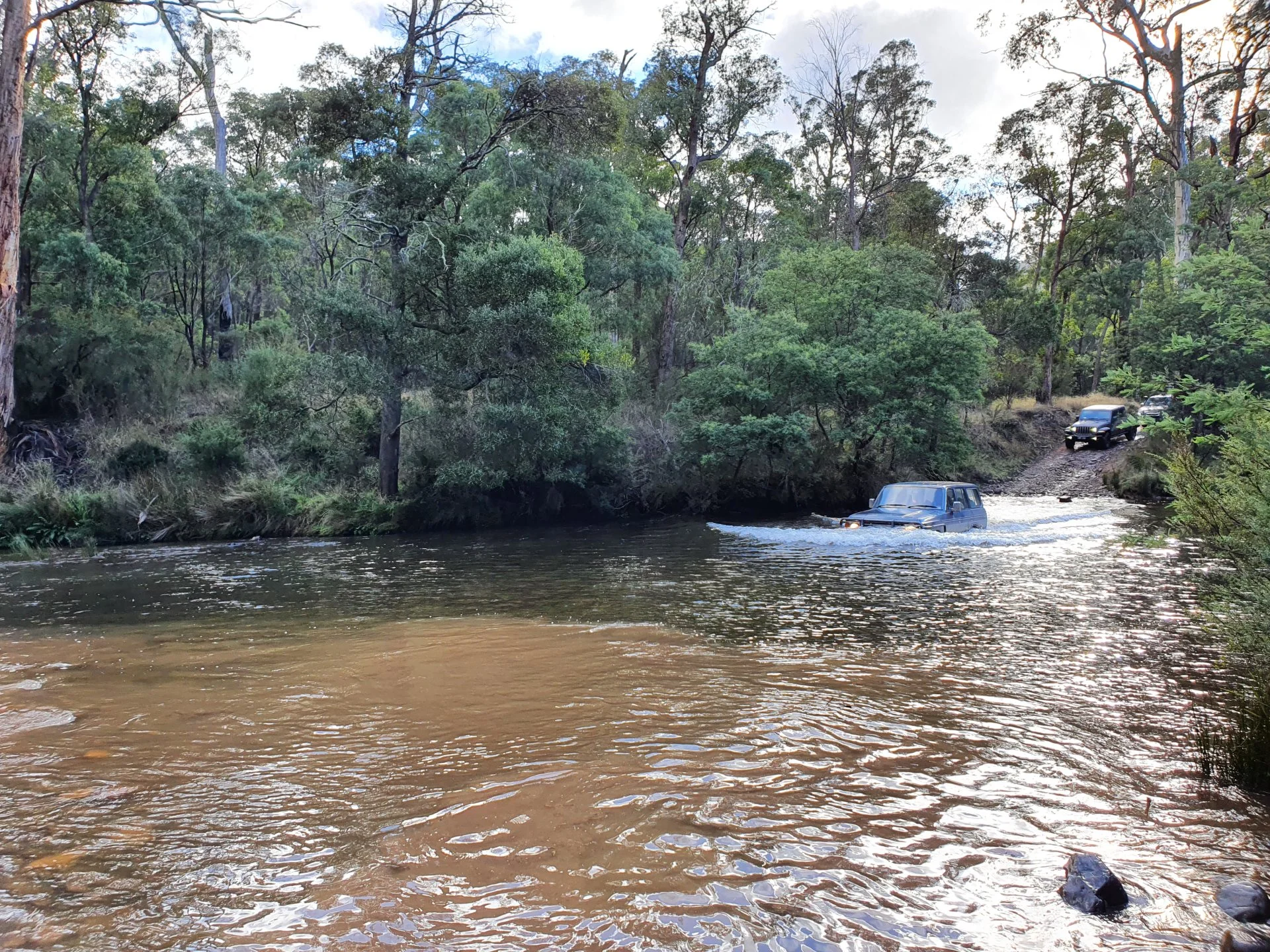

We had a fair few river crossings to do throughout the day, crossing the Wonnangurra and the Wonnangatta rivers. They were both pretty high, high enough to be a bit scary for the people without snorkels.
I'm pretty sure it was this crossing where i flooded the drivers side foot well of Yellowy. Turns out the seal at the foot vent is stuffed and the river pretty much ended up in the car. One of my heater hoses had a pin prick hole in it on the first day and i had to replace it and got a lot of coolant throughout the cab. The river water pretty much flushed it out so it was probably a good thing.
Yellow has a pretty high air intake from factory as all you guys would be aware, but the water was probably just below guard height which is getting a bit close.
My mate in the 60 got a bit scared, the air filter light come on half way though the crossing. We checked the air filter and it was as dry as a chip, it must have just got a bit of a splash on the sensor which was a relief. Pretty impressive the design quality from factory, it doesn't have a snorkel or a lift and showed 0 sign of water.

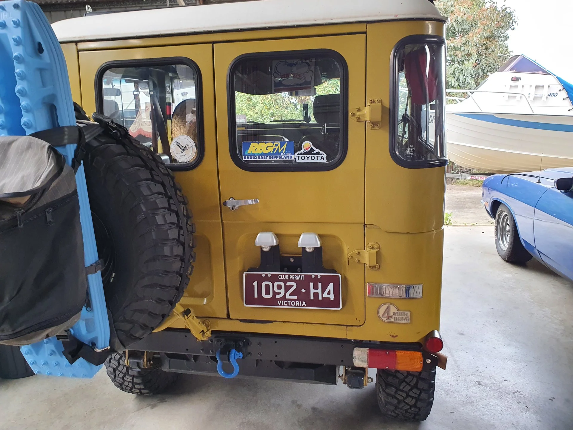

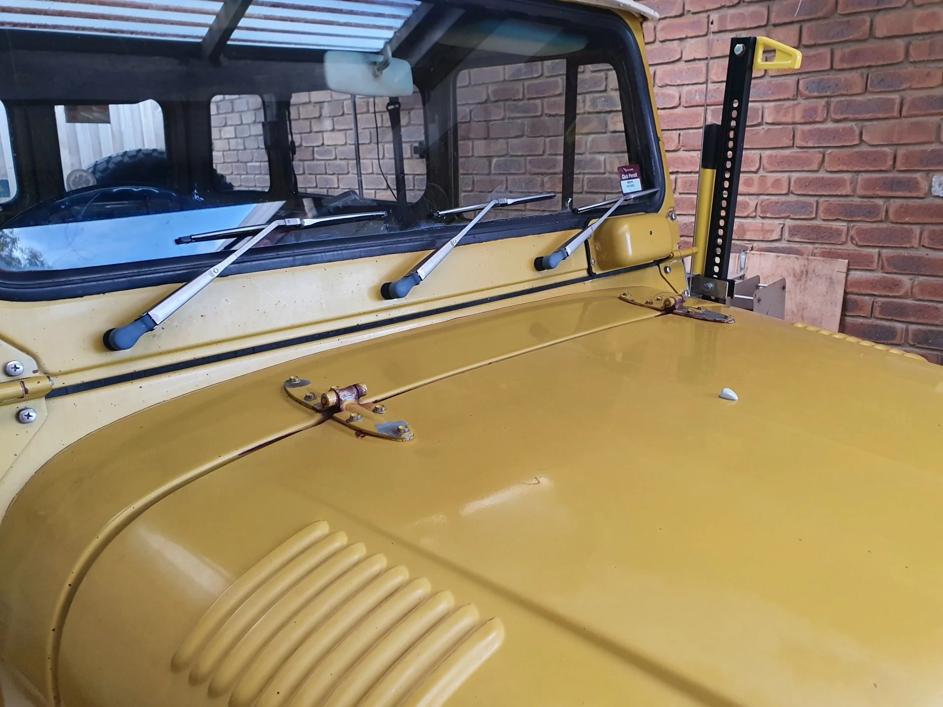

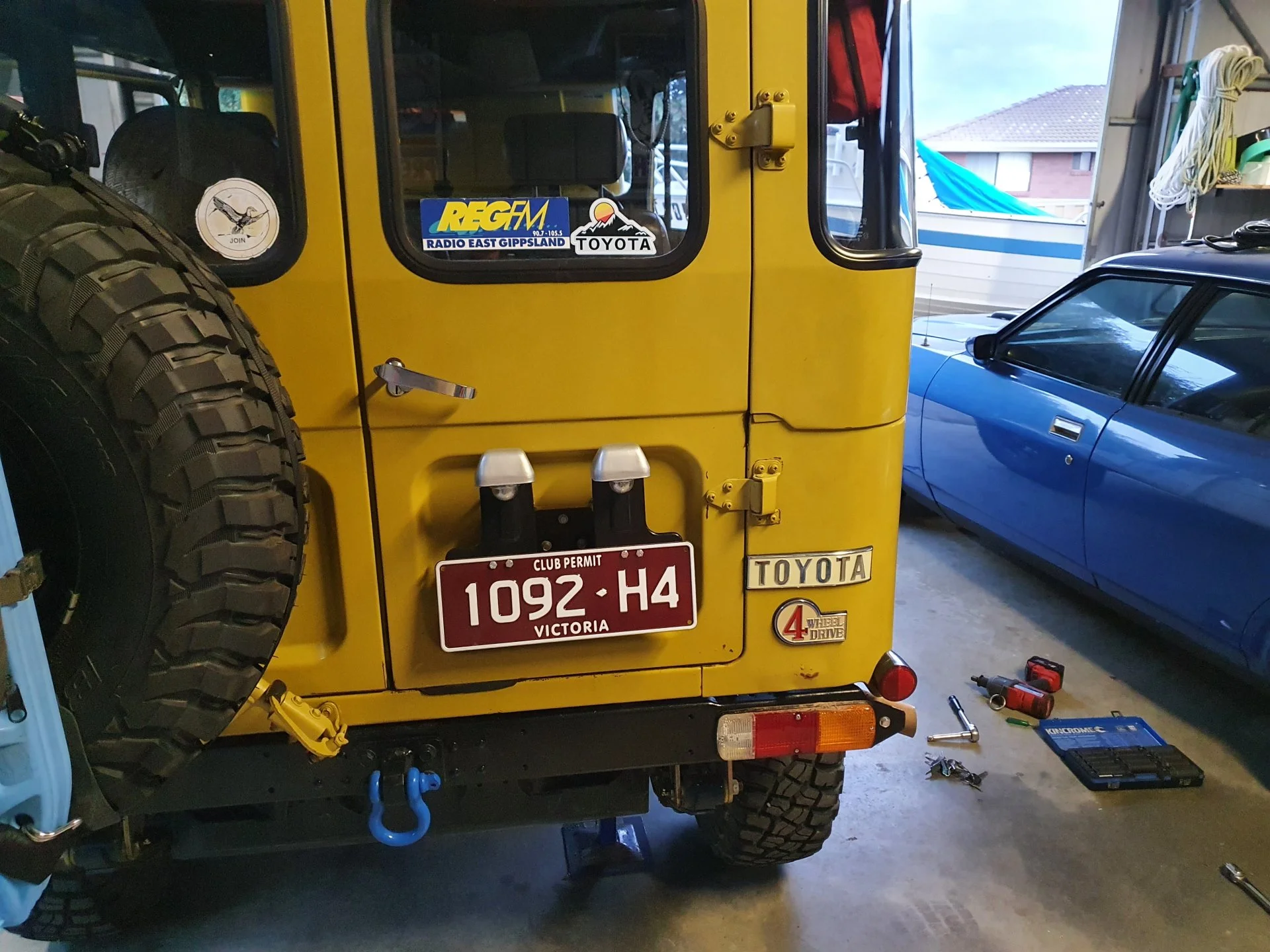

Real simple mod here, replaced the badges with some brand new genuine ones. They come up awesome!
I tried repainting the old ones but they came up s*** house. I've still kept them and will try again another day when i run out of things to do.

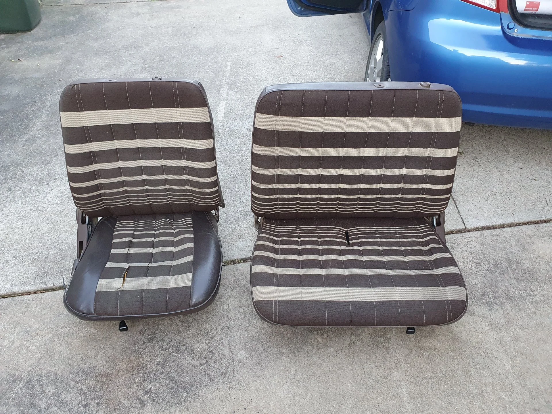

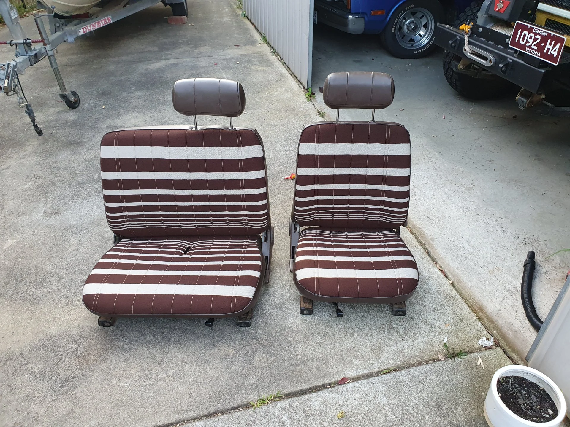

This one wasn't so simple. It took me a long time to get brave enough take the plunge and get the seats re upholstered. As anyone who knows anything about the LX varient these are the zebra seats that only the LX came with. The fabric is incredibly rare as no other manufactures ever thought to give their seats zebra stripes! The drivers seat had already had a repair done at some stage, it isn't supposed to have the vinyl on the sides. The passenger seat fabric wasn't actually too bad but the foam was stuffed and had zero support. The drivers side foam had minus zero support, i might as well have been sitting on the springs.
So after a couple of years searching i finally come across some of the zebra seat fabric. It was a long process that i won't get into. I got stitched up by a vendor on this site but he can remain nameless for the moment. In the end i found another guy selling some and i got it at a really good price.
I had had enough of having a sore back every time i took the car for a drive any longer than an hour, so I booked the seats in at a local upholsterer (Xquisit Trim and Upholstery in Bairnsdale)
They come up pretty incredible i thought! They are like brand new. I'm super happy with the quality and i'll be going back for some other bits and pieces i need done on my cars/boat. I wish i had painted the seat rails and a few other bits while it was all apart but you can't really tell when they're back in the car.
They are pretty comfy now too, way more support.
Seats back in the car, maybe the most worthwhile rebuild I've done so far. Its made a world of difference.

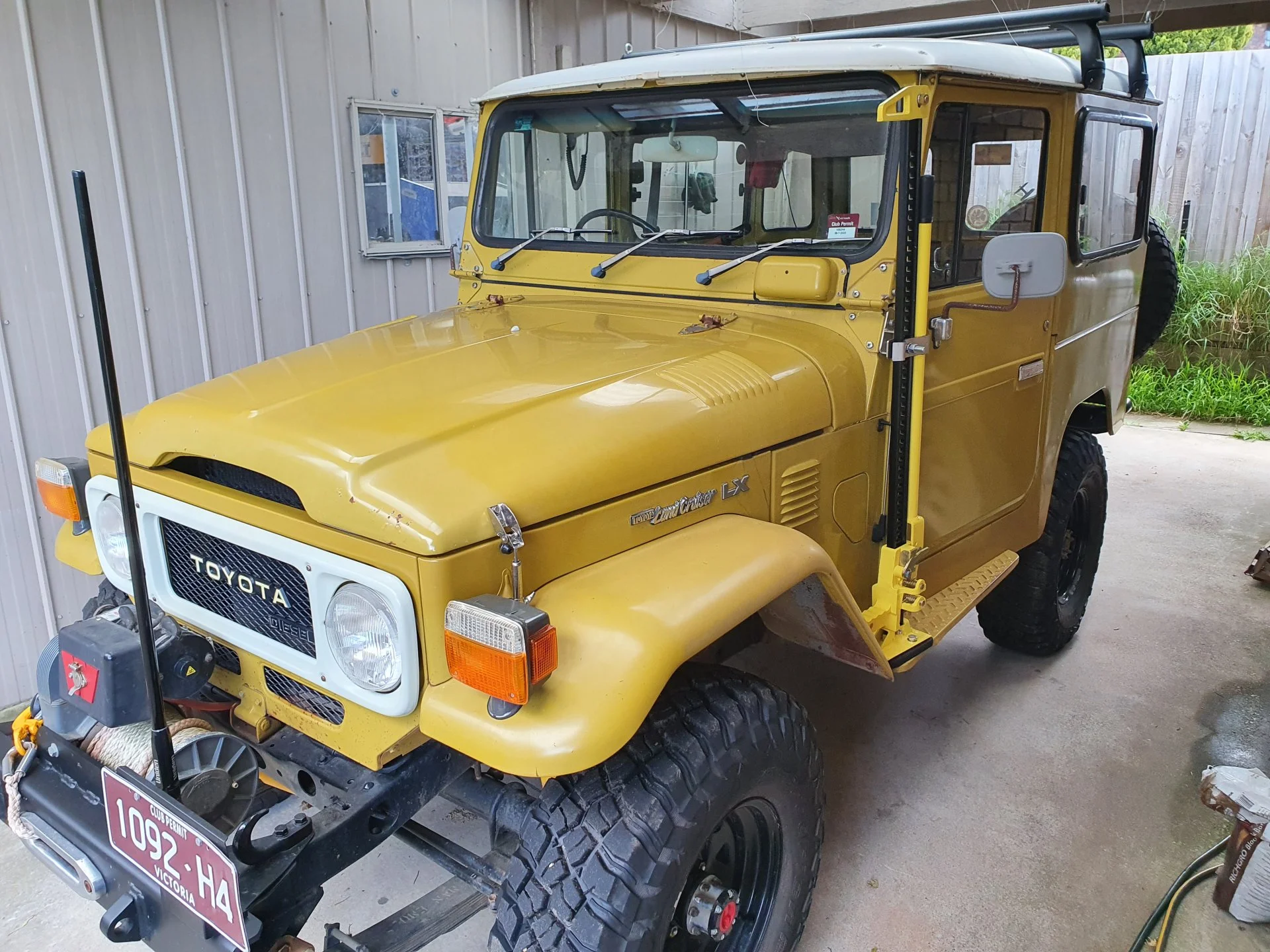

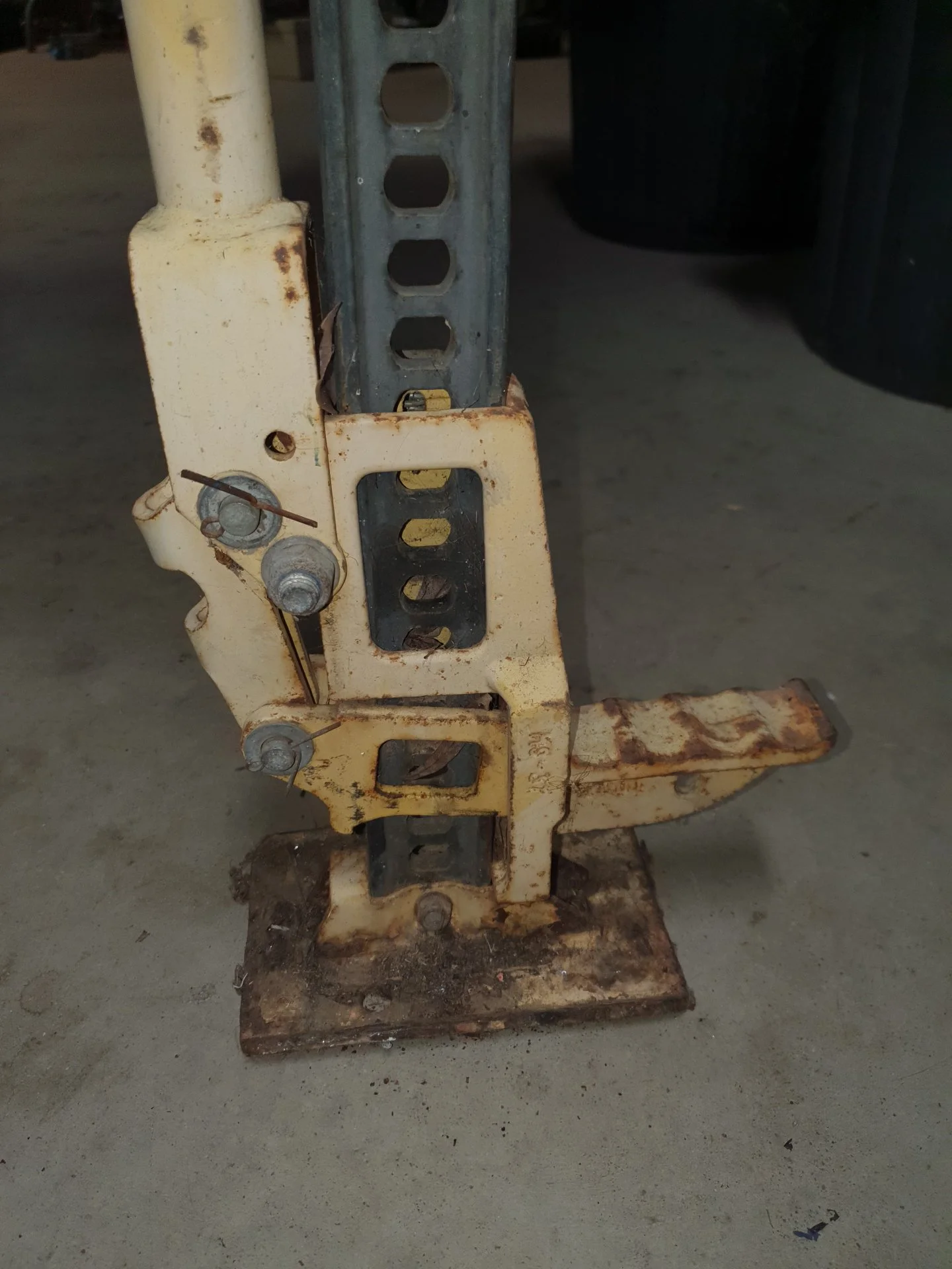

I wanted a spot to mount my hi lift jack. Space is a premimum on these shorties so i went the tried and tested way and decided to mount it to the side step. I thought i should give the old jack a bit of a birthday first and had it sandblasted and powdercoated.
I think it come up a little bit too nice! I got the jack mount off Mr Landcruiser in Queensland. I'm pretty happy with it, it doesn't fit perfect but it does the job.

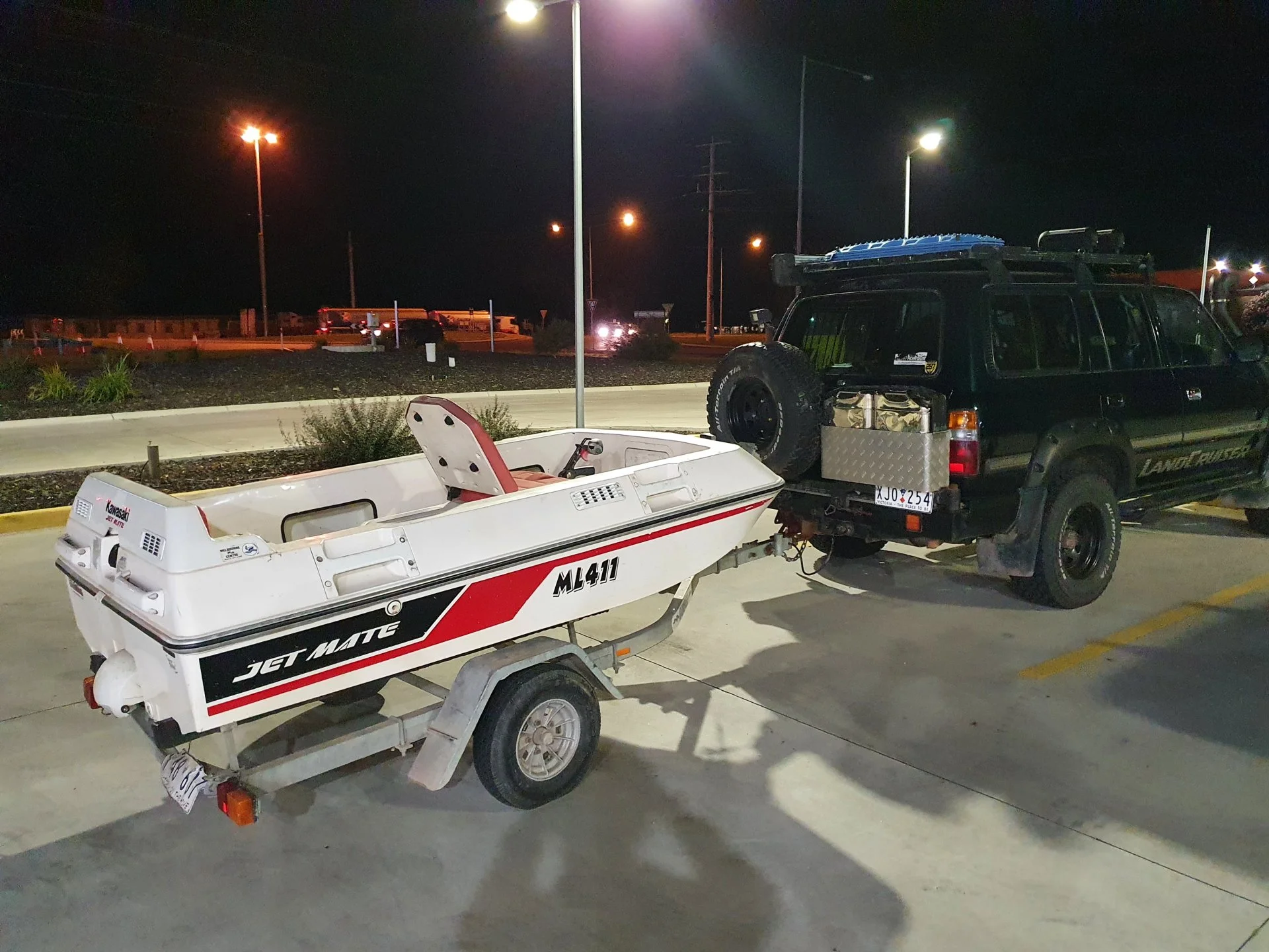

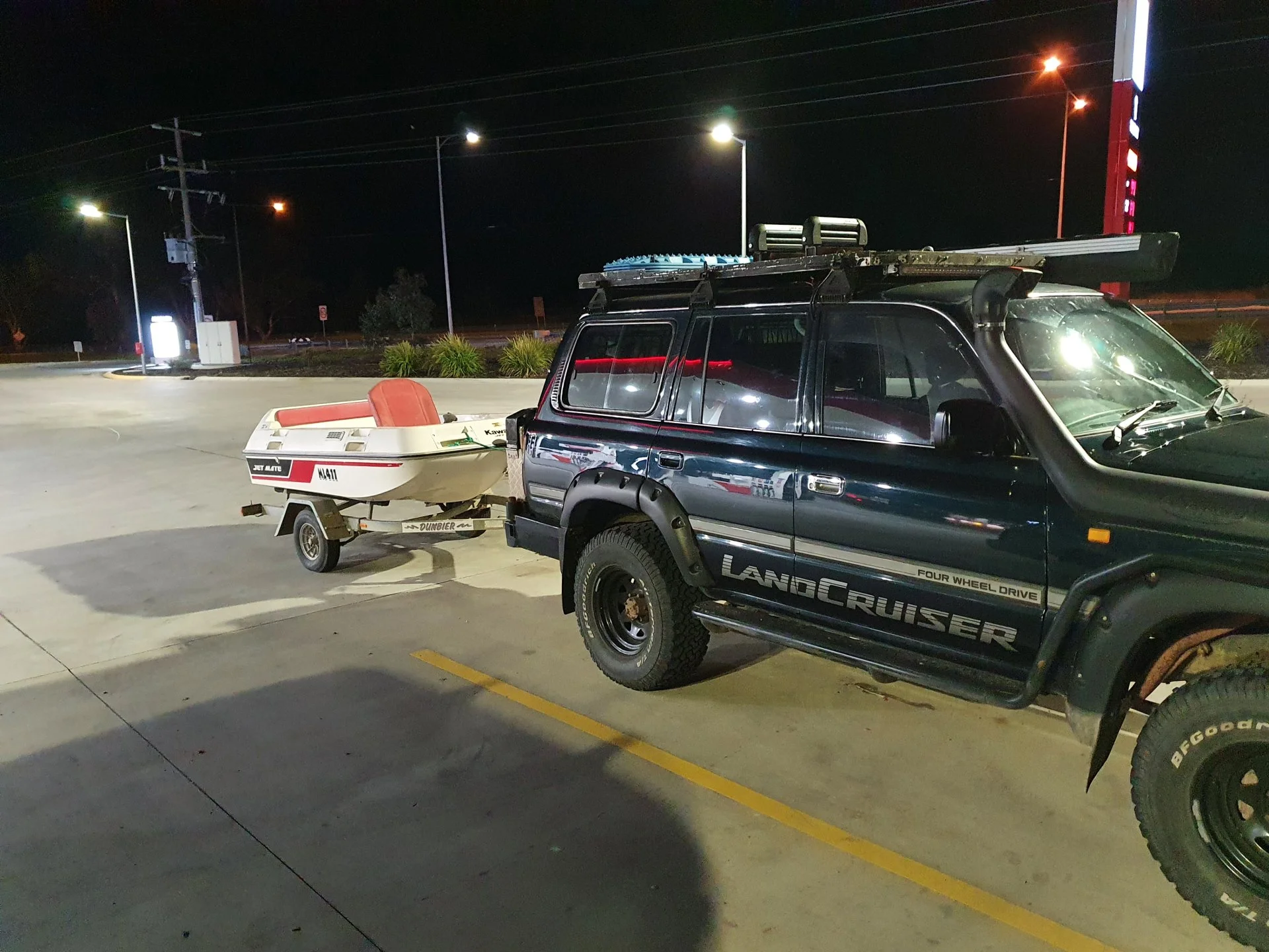

Bit off topic but i thought a few of you might find this interesting, i bought a 1989 Kawasaki Jet Mate during the Covid lockdowns! It's kept me pretty busy and kept me away from the 40 for a while.
I love all things Japanese engineered, and this is probably the most Japanese thing ever made. Its a 3 seater, 650cc 2 stroke jet boat, controlled via a joystick.
They are super rare in Aus, there seems to be a few of them still getting about in the USA.
Apparently the word is only 30 odd were every imported here. It wasn't running when i bought it, but i took a punt and thought how hard can it be? Its a super simple design, its just the 650cc motor out of the stand up Jet Ski Kawasaki was using at the time.
The photos make it look bigger than it is, its really the size of a large bathtub. There is nothing else in the world quite like it, i don't know what Kawasaki was thinking when they made this thing and what market they were designing it for but i love it.
The plan was to get it up and running and do a bit of fishing and drinking in it.
