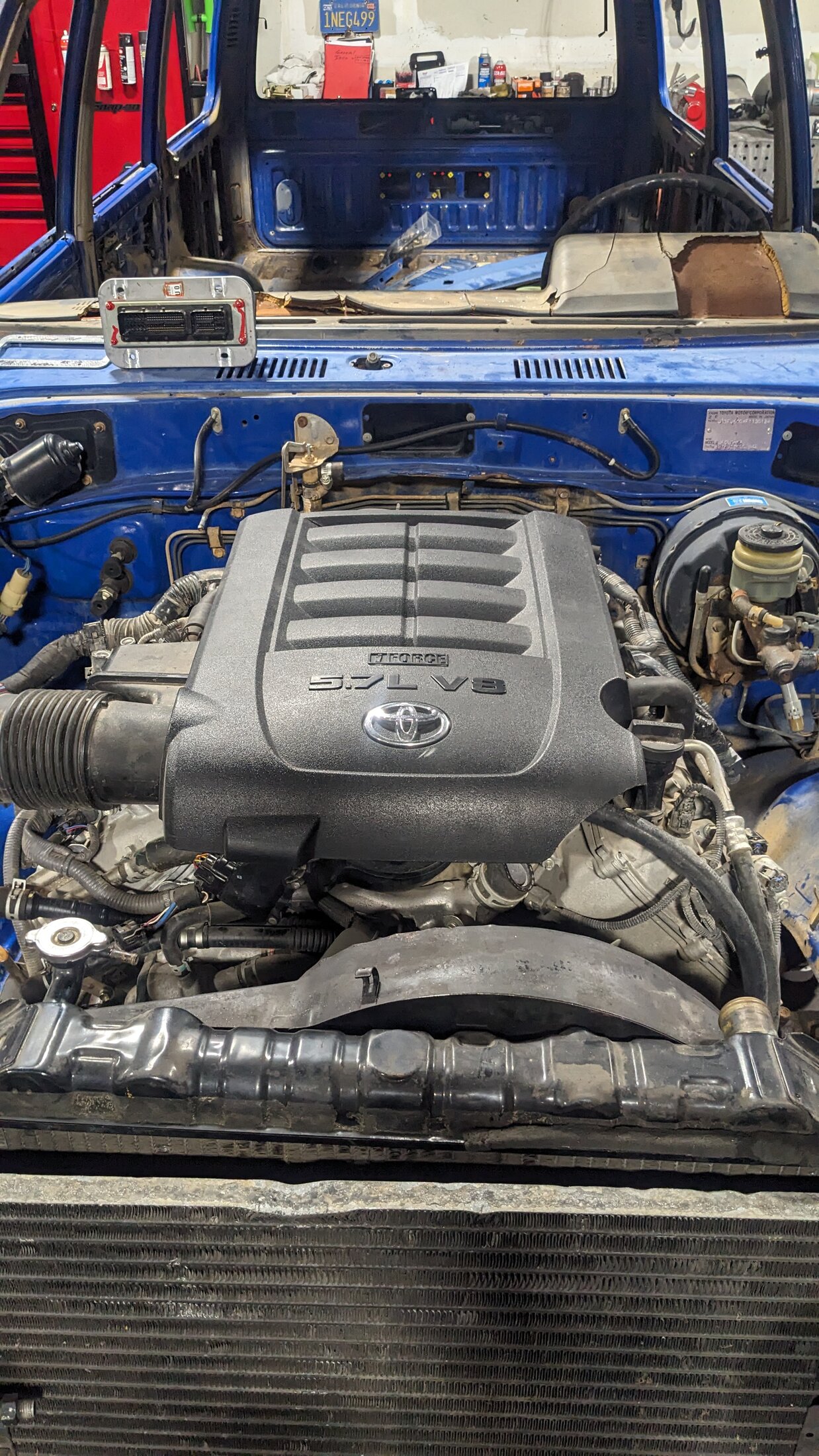

We are working on a kit now. Complete Tundra drivetrain.
Anywhere I can follow the project, process, and details to this?
I've a friend on the West Coast that has a 3UR(UR) to T56 pattern adapter. Curious what 6MT 4WD transmission options are available.
