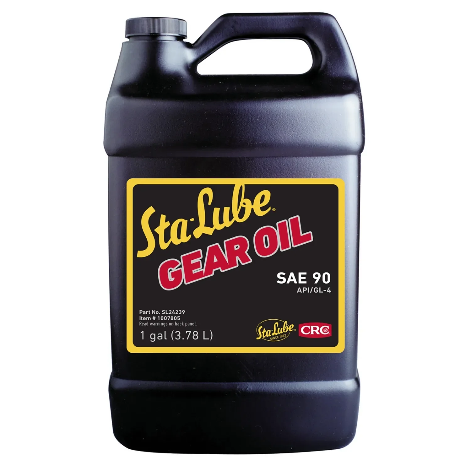

I use Sta-lube brand gear oil for my diffs and to break in my trans - Id imagine anything that's rated for brass syncros will be fine. Redline stuff is pricey but also runs really smooth.....

Sta-lube is fine. It's actually a very good value gear oil. You want the straight 90wt GL-4. The 85-90wt has been discontinued.

Thanks for the recommendations. Our local Napa has that Sta-Lube so I'm going to get a gallon of that today. And those replacement plugs look a lot nicer than the ones I currently have. I'll have to get a set of those too.
